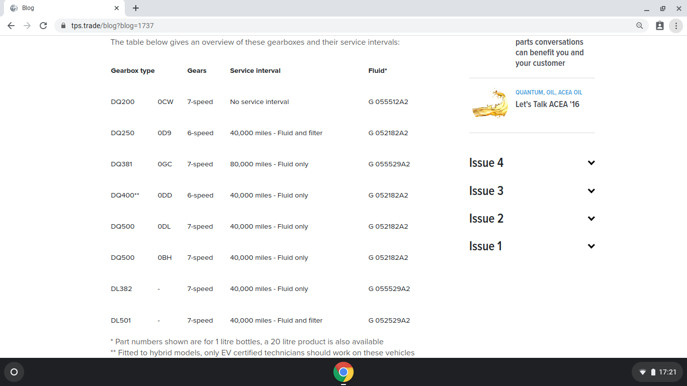

A DQ200 7 speed DSG which is 'Maintenance Free' as in no Guidelines or Schedule for oil changes requires 2 different oils if doing an oil change. For the MCU and the box.
I think some muppet at a dealership is looking at that labour time.

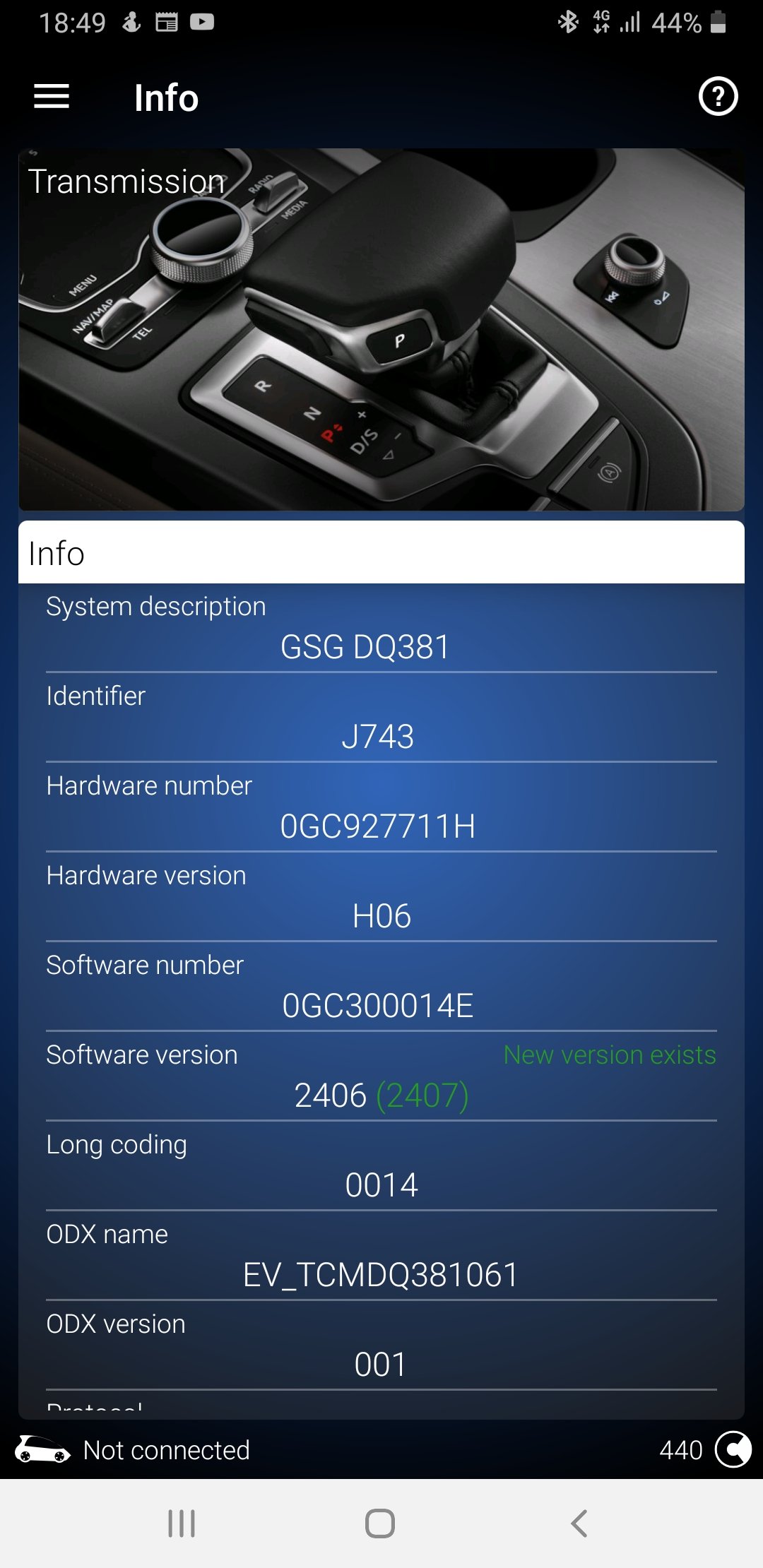

You do not have a DQ200 DSG.
The MPG is terrible (around 35mpg) against very good levels of driving (I have Skoda Connect Lite) on a 40 mile round trip; I think their view is that as they cannot see any errors, then there isn't a problem. I love the Scout, but Skoda's warranty is really not worth the paper it's written on. The gearbox oil is being changed by the master technician. Filter and oil is being done. The view is that do that....then if the problem continues then they will investigate further.
BTW...I wrote that previous article; the more I read about this issue of DSG gearbox performance (on other VW forums) then the more I am convinced that the gearbox has issues. Oil changes cost, but I would rather have peace of mind knowing that basic maintenance has been performed correctly than leaving it to chance.

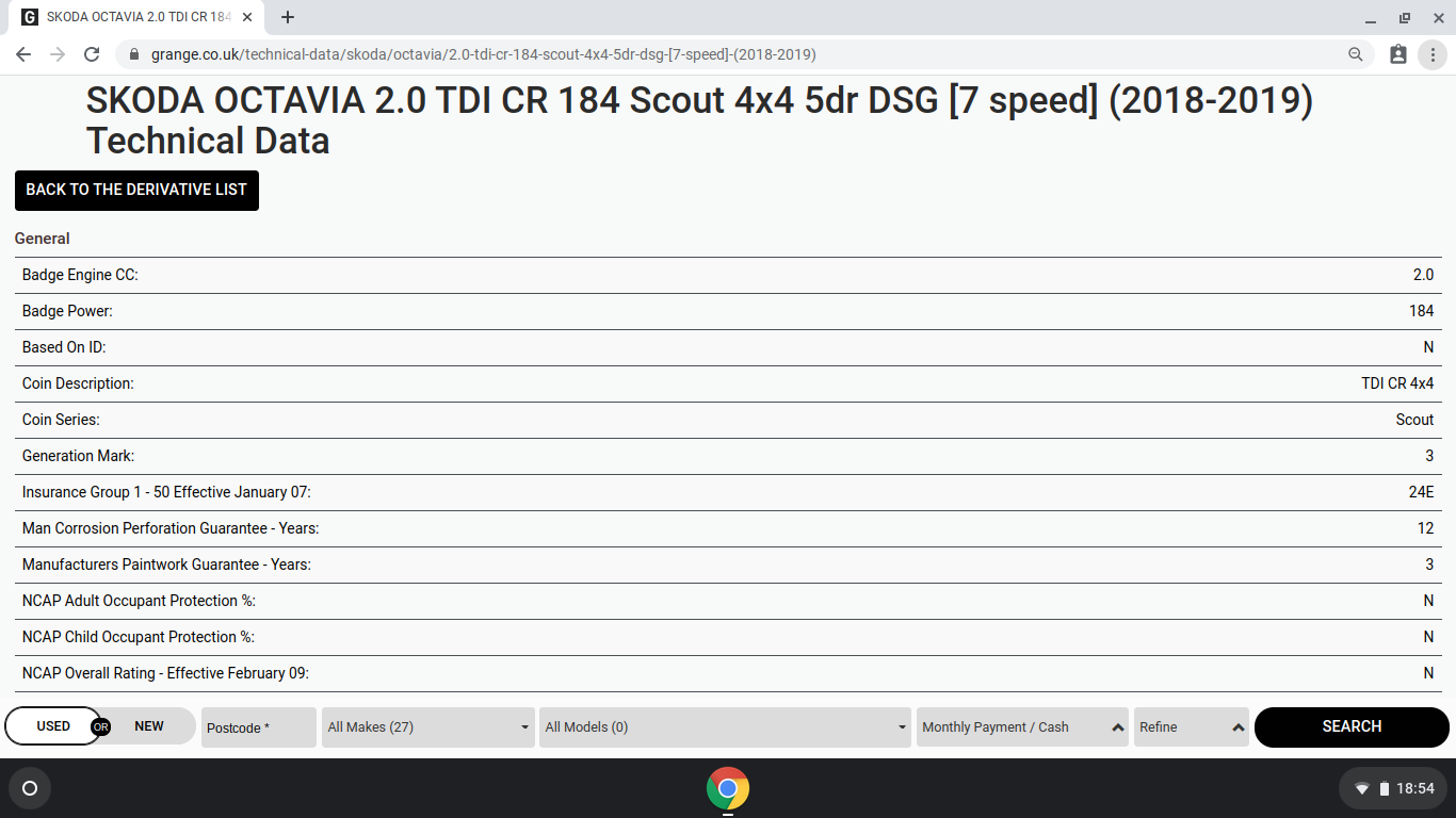

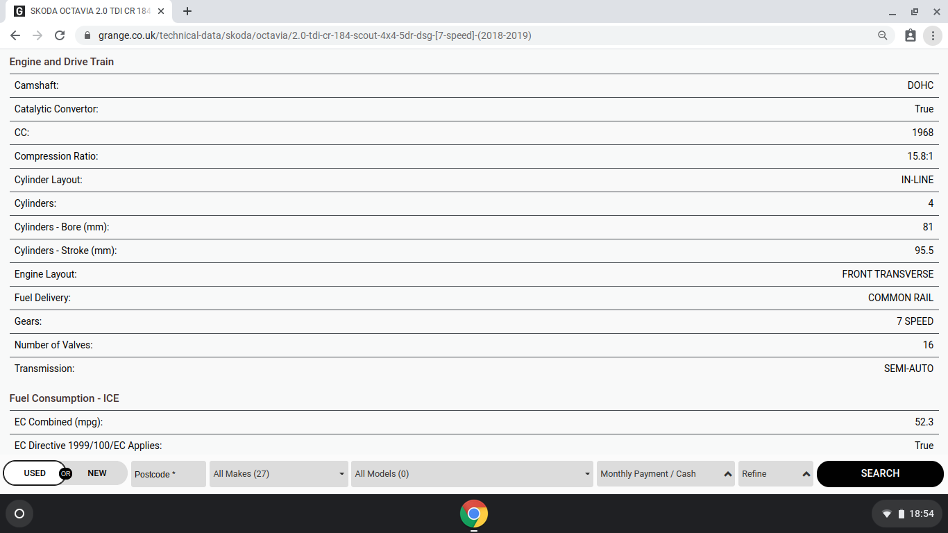

Okay, if I don't have a DQ200, what gearbox do I hace?
Arh bingo. I've got it. It's a DQ381!
Does any know if the 7 speed is a wet or a dry clutch at all? ive got the 2 liter diesel.
Suspect it's a wet clutch
The only Twin Dry Clutch 7 speed DSG are the DQ200's 2009-2020 are only on vehicles with FWD and 250 Nm torque max.
So petrols, 1.0, 1.2, 1.4, 1.5  maybe 80ps -150ps,
then 180ps (Fabia Mk2 vRS) & on some192 PS like a 2015 1.8TSI Polo GTI.
Up to a 1.8TSI fwd Octavia maybe and a 1.6TDI.    No 2.0 tdi or TSI'.
