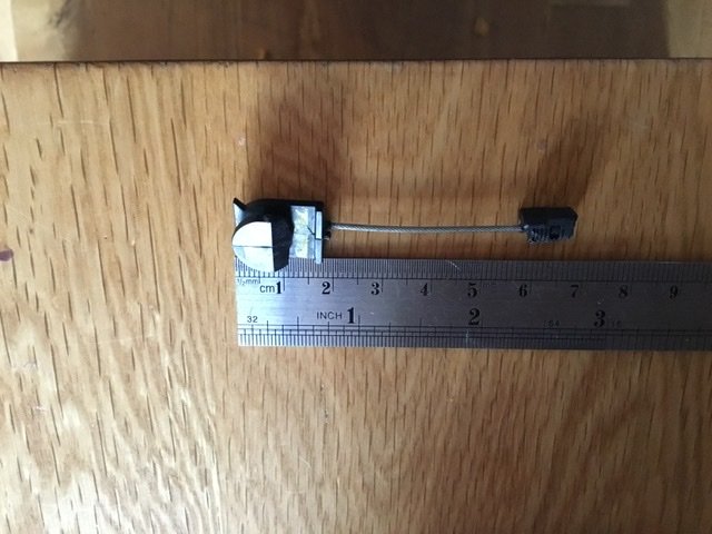

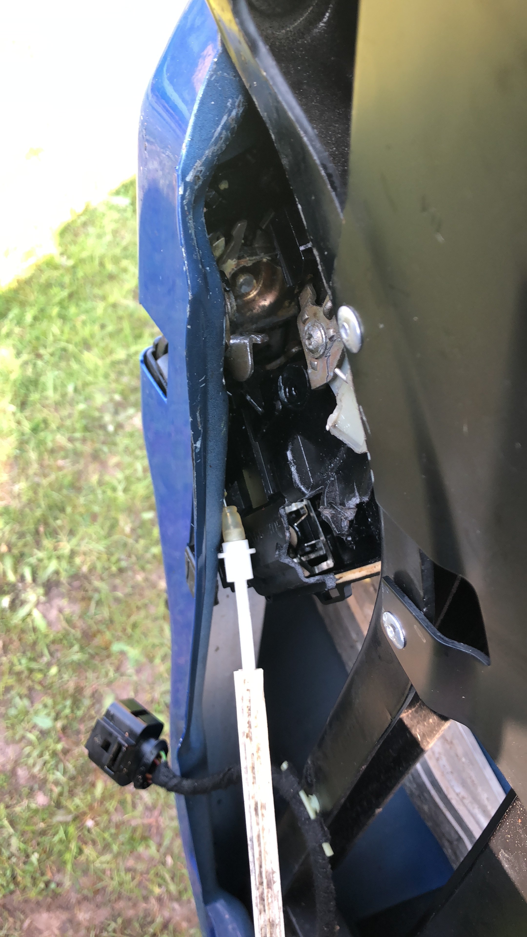

Hi 59p. I had this same problem on my 08 vrs when I had it. The Bowden cable from the exterior door handle to the lock was worn out at the handle end. The cable is about 2 1/2 long with to plastic ends that are different to each other. The lock mech end a half moon and the handle end is rectangular shaped with with slits cut into it to help lock into into the handle when you put the wedge back in. If you get one of them car break-in kits, you will get the door open that way and it’s very easy. There’s no dead locks on, as the car is opened and the door mech is also in the open position.  It is possible to carry this repair once you get the door open and get access to the torx screw that holds the handle in, without stripping the interior trim off.  I did end up stripping the interior door trim off when I did mine but worked out it wouldn’t need done that way again if I had to do it. As for re-fitting the metal door panel. I bonded  nuts to the inside of the door and used matching bolts, as I couldn’t find rivets or rivinuts at the time.  You will need a new stainless steel rivet to re-attach the window runner to the metal panel, as aluminium ones are no good and break.

Put the wedges between the glass and door to create a bit of space. Use the long flat bar thing (looks like a metal belt) from the gap you created at about a 45 degree angle, push it down till you get to the mech and you will feel a bit of moment and resistance when you hit the lever. Push down and the door opens. Once the door is open, you will see the torx screw on the inner door edge that holds in the block next to the handle. Once this is off, you will see the Bowden cable and where it goes.  Use a pair of narrow long nose pliers to put the cable in place on the door loch mech, it pulls in parallel to the ground then re-attach to the door handle, using the wedge on the handle. Tie a bit of fishing line to the Bowden, incase you drop it in the door.

Unless you go battering the glass or hit with a metal object, you’ll be fine. That’s what the wedges are for. There plenty clips on YouTube on how to use the kits. The torx screw is accessed from the metal door edge once open, its inline with the handle and very close to the outer panel edge. Once the handle is off, you will see where it goes. It’s a fiddly job and can be time consuming and worth trying this method first before you go down the route of removing the door card and inners. Just make sure you have a good range of big head rivets for the door panel and an ss rivet to re-attach the window runner to the panel A’s it’s under load. If you look at the gap between the handle and the end block on both rear door handles when pulled open, you should see the space in the handle where the small end of the cable wedges on the handle that not working.
