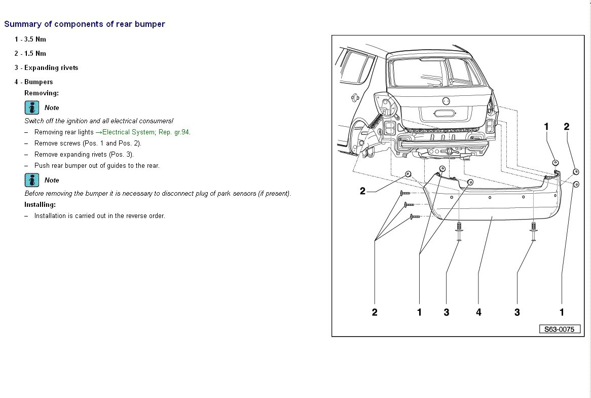

One of my rear parking sensors (near centre of bumper)  has popped back into the bumper void.  Do I need to take the bumper off or is there an easier way to retrieve and refit. Cannot find anything in the guides other than bumper removal. Skoda Fabia VRS Estate 2012
Thanks in advance
Take the rear light off on the side of the sensor and try to go into the bumper from there. You should be able to squeeze in and reach the PDC sensor and slip it in again.
thanks, will give that a try
I think bumper will have to come off personally...pretty easy to do.
