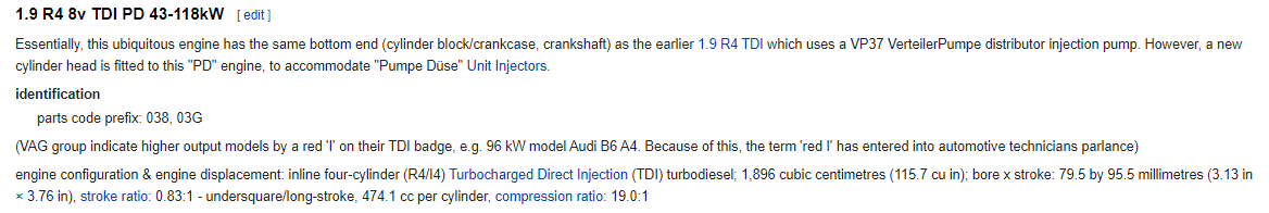

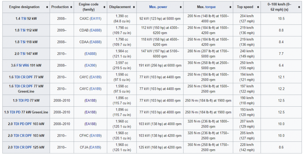

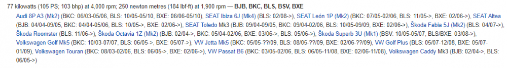

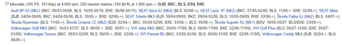

As far as I am aware they'll both be BXE's...
https://en.wikipedia.org/wiki/Škoda_Superb
No mention of the MkII Superb (3T), but that's clearly an accidental omission...
