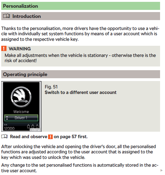

It looks like different users/profiles have been set up to each key.
That sounds about right.  I wasn't aware that it was possible to set up different profiles.  Now I understand I'll stop worrying.

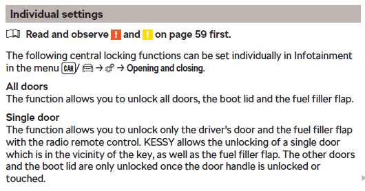

You can turn off the profiles in the car config menus.
This will give you the same for each key.
How do I do that?

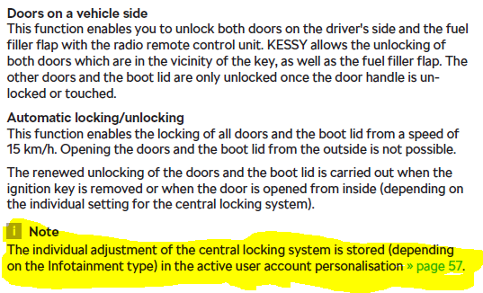

You can only do that if you selected 'Driver Personalisation' as a factory cost option...
If your Octavia doesn't have 'Driver Personalisation' you need to alter the settings to how you require them for each key whilst it is in the ignition, or in the car with the ignition on (KESSY)...
