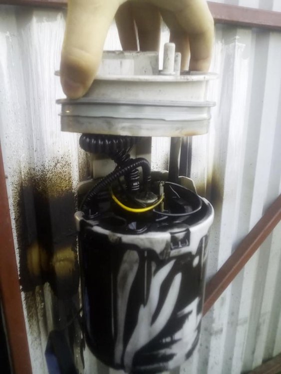

few months ago we broke down and car will not start the rec guy sed fuel pump problem
got it to my garage we always go to this was in late dec
done the following so far
 fuel pump
crankshaft sensor
 ecu for a plug and play
also ordered a 2nd hand SKODA Fabia VRS 1.9 TDI In Tank Lift Pump / Sender Unit from a breakers on ebay
garage wants to change the injectors now i have a set i bought while back stanard set
anyone else know what else it could be
