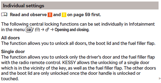

I made the change on my 2017 without having to use anything other than the Amundsen infotainment screen. Pretty sure it was in Car Settings and then something like Lock/Unlock.
As above, on my 2016. 👍
And on my 2014
Found the setting today..... it wasn't there earlier in the week

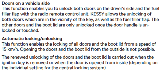

All modern Skoda models allow for the 'open all doors' with a single press of the unlock button on the keyfob.
