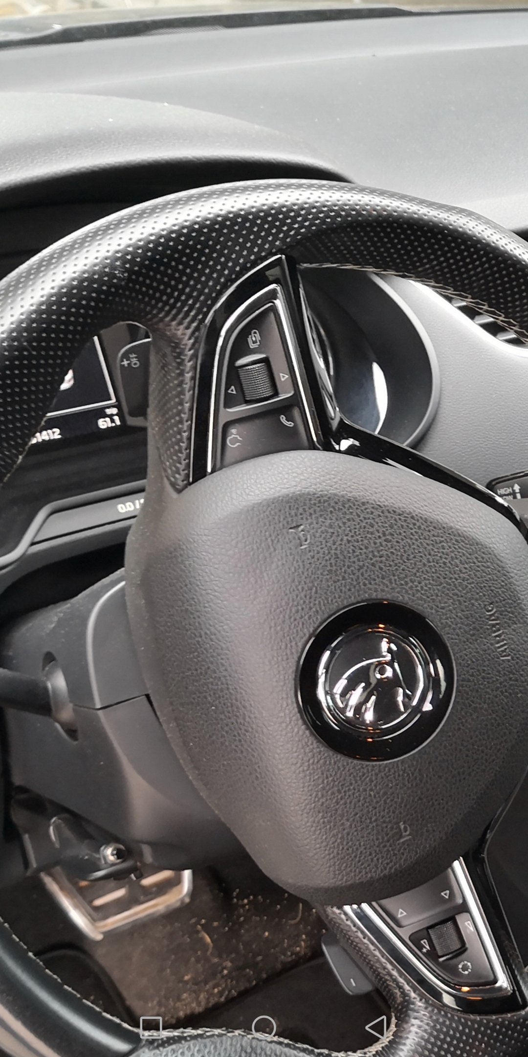

Why not use the wiper plug? Does your screen have the Voice and BT buttons?
Hello Sasha again. I do not have screen wiper.... bt i have. voice i think not
If you don’t have the Voice button then RVC low cannot be activated.
voice button i have, the whole voice command i think is not working

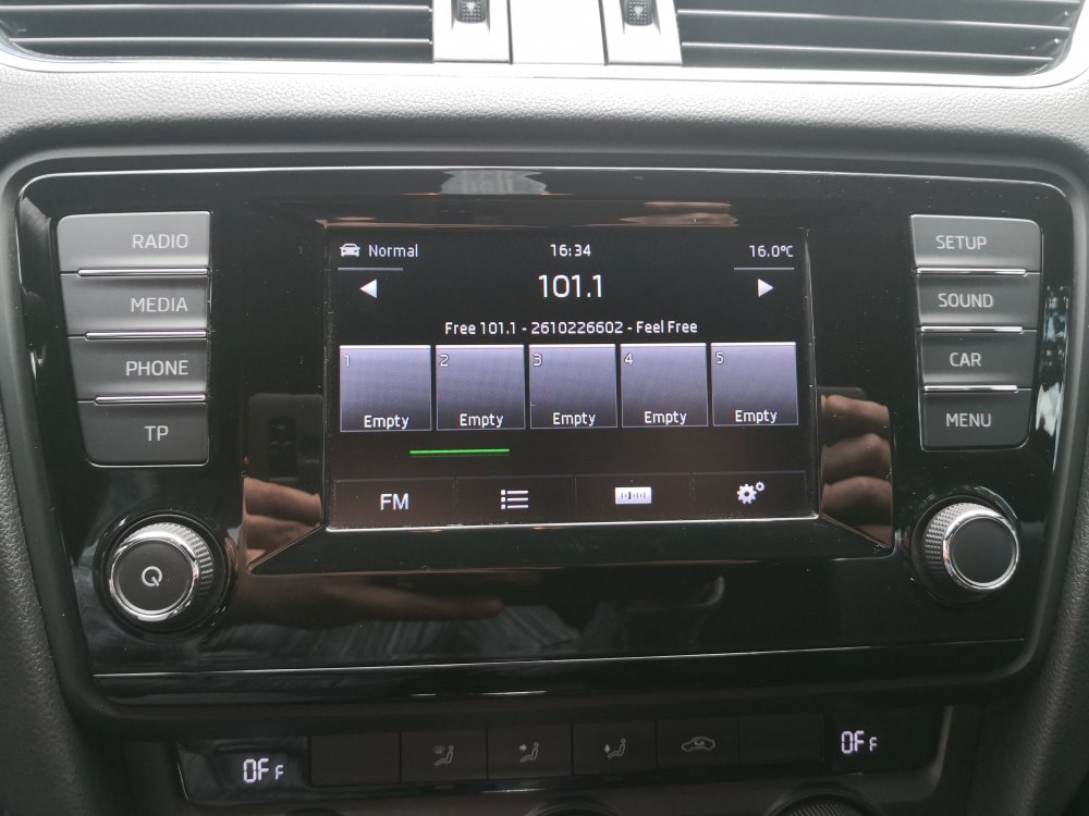

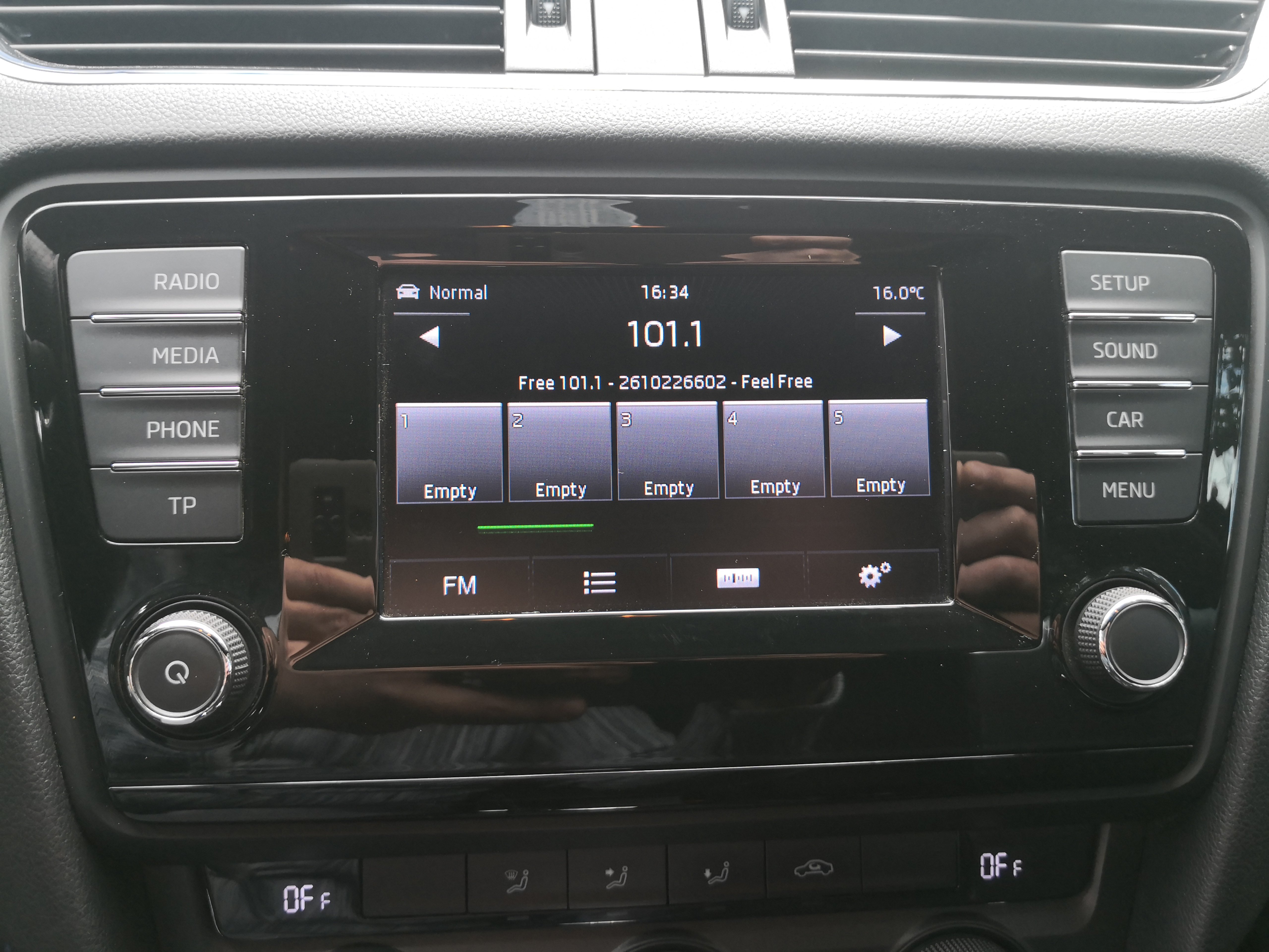

Please take a picture of the radio screen and upload a whole adaptation map of the 5F module and I’ll take a look :)
Thank you Sasha! First thing in the morning.
Unfortunately RVC is not compatible with this radio. See you have a TP button, needs the Voice button here to be compatible. This version of the MIB1 Bolero isn’t compatible. Another, higher spec MIB will be needed to complete the install.
