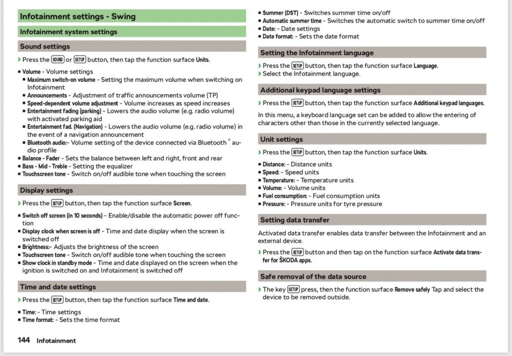

Haven’t tried it but does the automatic summer time option not work?
Not on our Kodiaq, no.
Frustrating, the description in the manual and on the screen suggests it should, but on our 2018 Kodiaq it doesn't work. We have to change it manually.
Yes, my 2019 Kodi didn`t have this option as well before I coded it.
Agreed, really strange why this feature is not abled by default.

On 29/03/2020 at 17:17, silver1011 said:
Does it simply adjust the time by 1 hour, or does it change the time to European time (CET)?
Is there therefore a setting for the UK (BST), instead of Europe?
I believe the option to set either EU or US when making this update relates to the date at which summertime changes, US is beginning of March and EU 3 weeks later, end March.
If I remember correctly, there were only two options: Europe or blank.
When I changed mine a month ago there were 3 options, EU, US and automatic.
