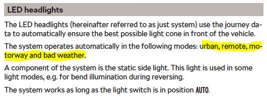

That doesn't sound right to me, perhaps there is an issue. It certainly sounds as though it would be worth getting their alignment checked out.
There are four modes that alter the cone of light...
Unfortunately I can't find the speed at which they change between 'urban', 'remote' and 'motorway' modes.

Thanks.. Yes, this makes sense.. Mine are like the low beam on the first video of 35mph, fact is I'm not driving any distances at present, cars only been on the motorway once on day 2 of ownership in day light..(had it 3 weeks) and only 270 miles on it... Bloody lockdown social distancing!
