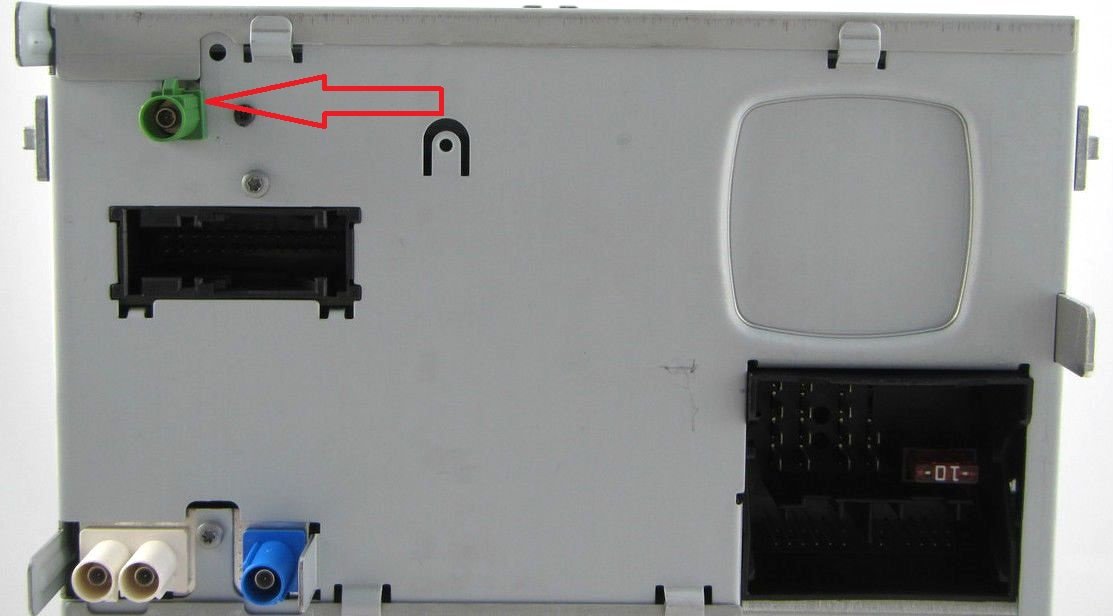

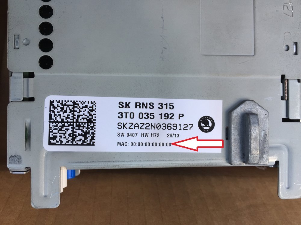

RNS315 will plug and play, and yes can be coded.................... but be careful.......they don't all have bluetooth in them, so you would still need a bluetooth module and loom as well, can sometimes
work out cheaper buying a NON bluetooth unit and adding the additonal module / wiring which is also plug and play.
The way to tell, is if your looking at images of them, if there is an image of the factory part label, if the MAC address is NOT all 0's and is numbers etc then it has built in bluetooth.
Same goes for DAB, they don't all have it.
Image showing a unit WITH DAB.......(arrowed green connector)
Also, image showing label with MAC address as all 0's.......NO bluetooth.
