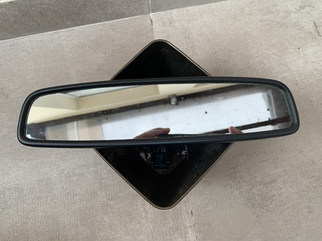

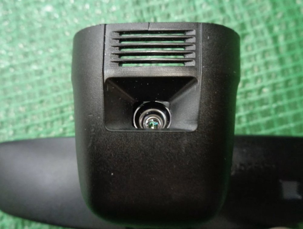

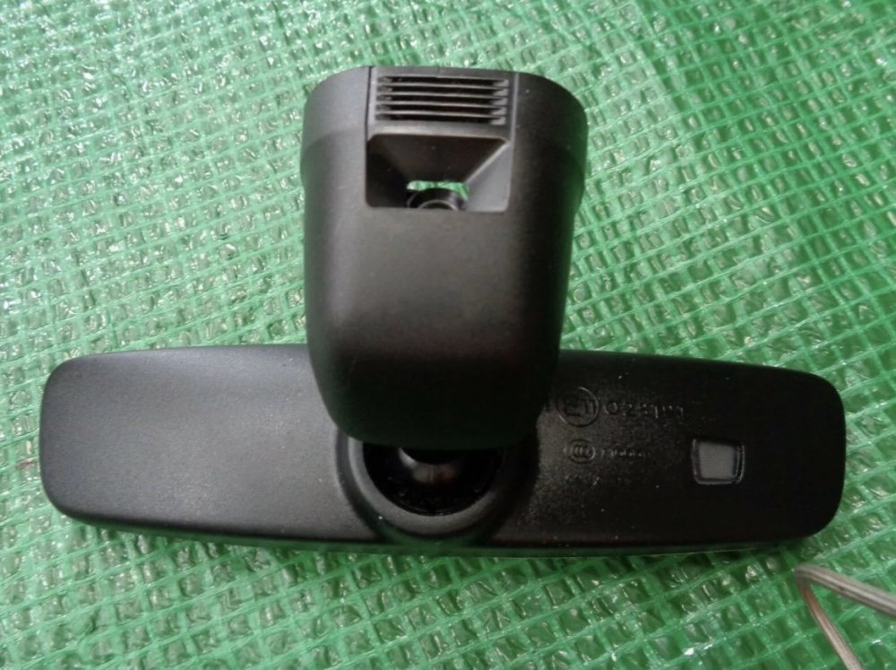

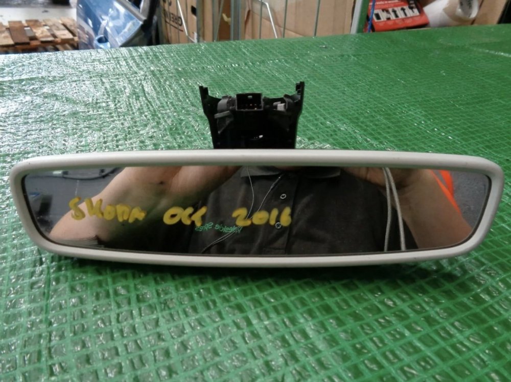

Here is what I ordered on ebay today, and it only cost me ~37 eur + shipping.
viber_image_2020-03-31_23-40-03.thumb.jpg.0d615ac57888b8286789662d3b83cb42.jpg  viber_image_2020-03-31_23-40-023.thumb.jpg.52cf7a58e0147a4682b6fad7130b77bf.jpg  viber_image_2020-03-31_23-40-064.thumb.jpg.e5abc885f38027fb8c32a9123f8ef218.jpg
As you can see, I will need to repaint the front part to be black like the current one, but that will be the easiest job.

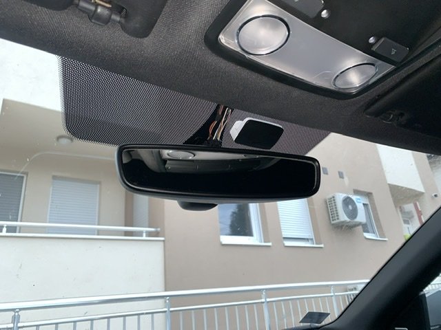

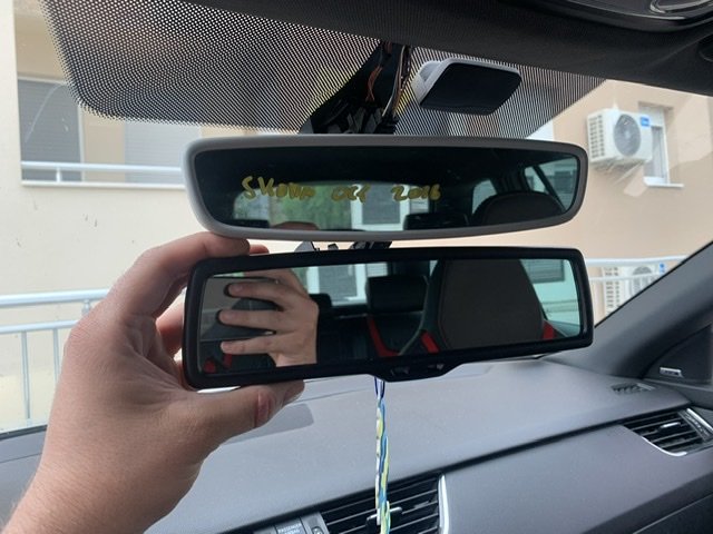

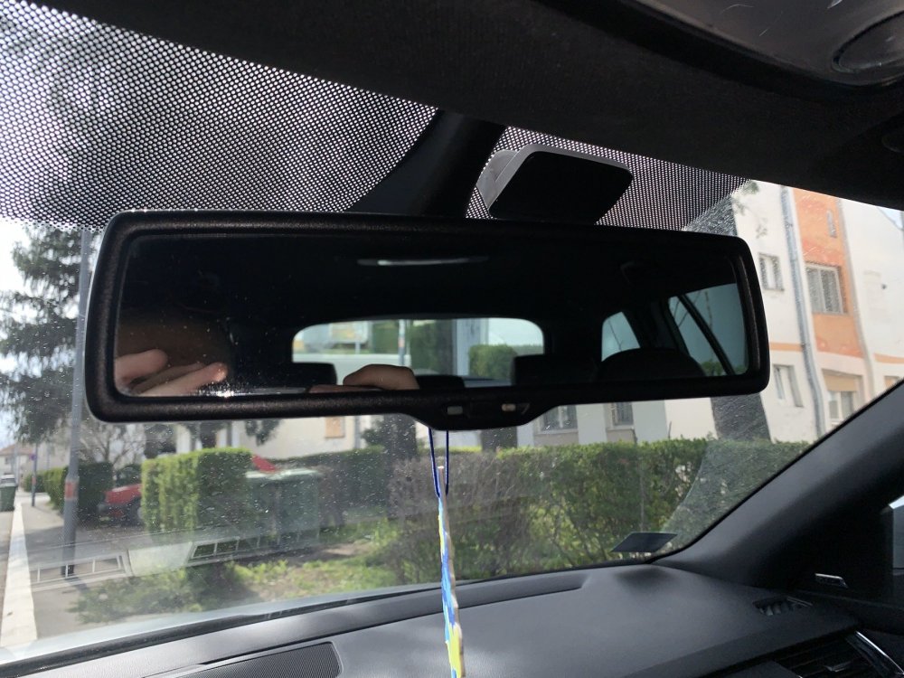

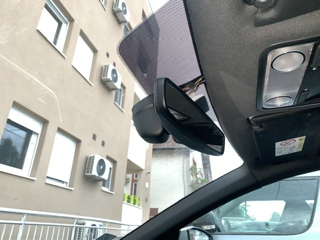

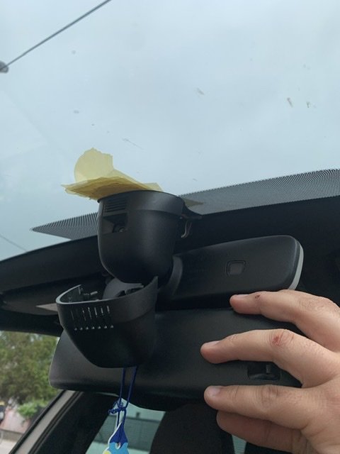

Mirror arrived! :)
20FAB4F6-C119-4C48-A0DE-DCD24FE64F6F.jpeg.584395489820ba391508b1302fe88559.jpeg42ACFE45-18EF-4FCE-B406-4A407E1EF455.jpeg.3fd681a960f21bd6ff17962ffb76eba0.jpeg

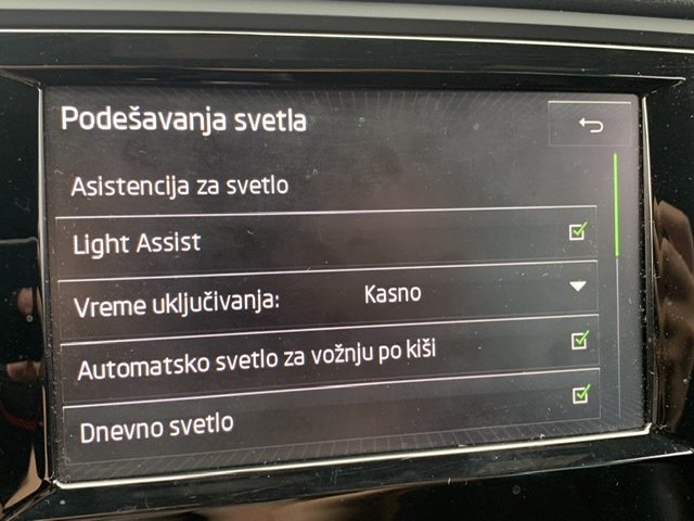

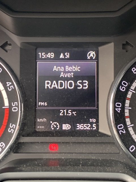

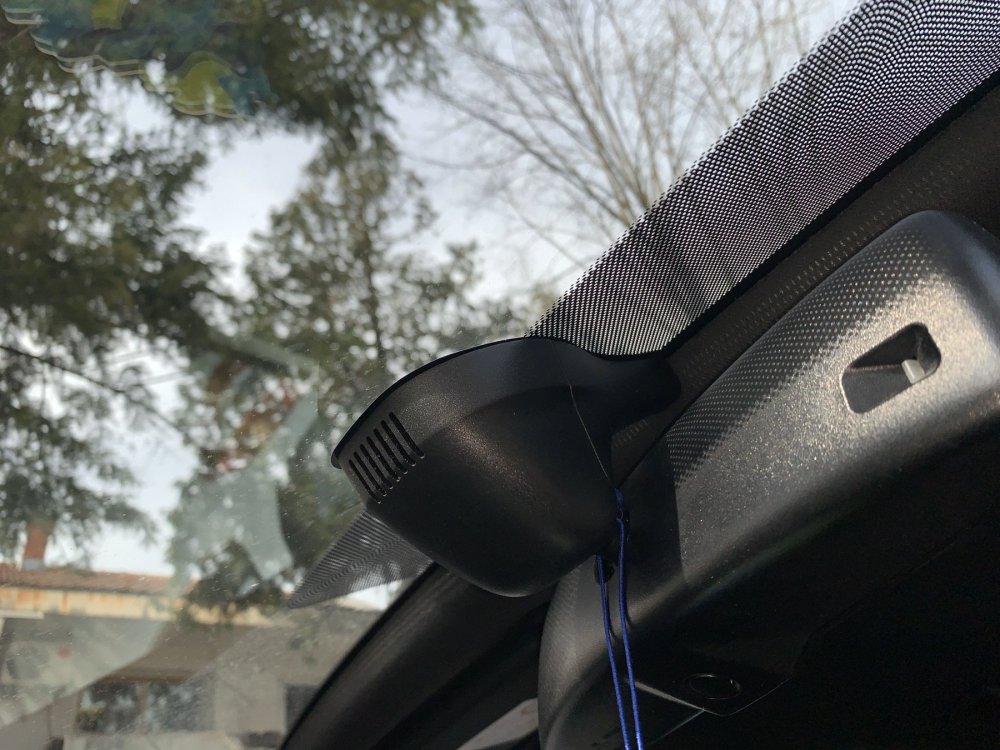

The frame was immediately painted in black, and after coding that was provided by SashaGrace it was alive!
72004451-4488-42FC-8E53-945856198E13.jpeg.c1f3123d5886562a174ce074281be9e4.jpeg15744723-BA54-4F9F-82FA-8435AAB51954.jpeg.33cb7a3f29caaff617c7f47565d45a8c.jpegC35E9BF4-7255-4CE8-BE78-11AC16073D61.jpeg.37e3880fb939d20c6acf5c9b9b36246e.jpegEA7FDE46-C1F5-4AB7-B2B2-31731EAF51BA.jpeg.792534c3e11413eab3d19d05a9263fe6.jpeg41C7C0B8-F097-42D9-BA5E-18196A67A78C.jpeg.af993d9f7ebc9be96812b3eed7b68a41.jpeg
Everything went pretty easy, the coding was a little bit different because I used OBD11, but I managed to find everything.
