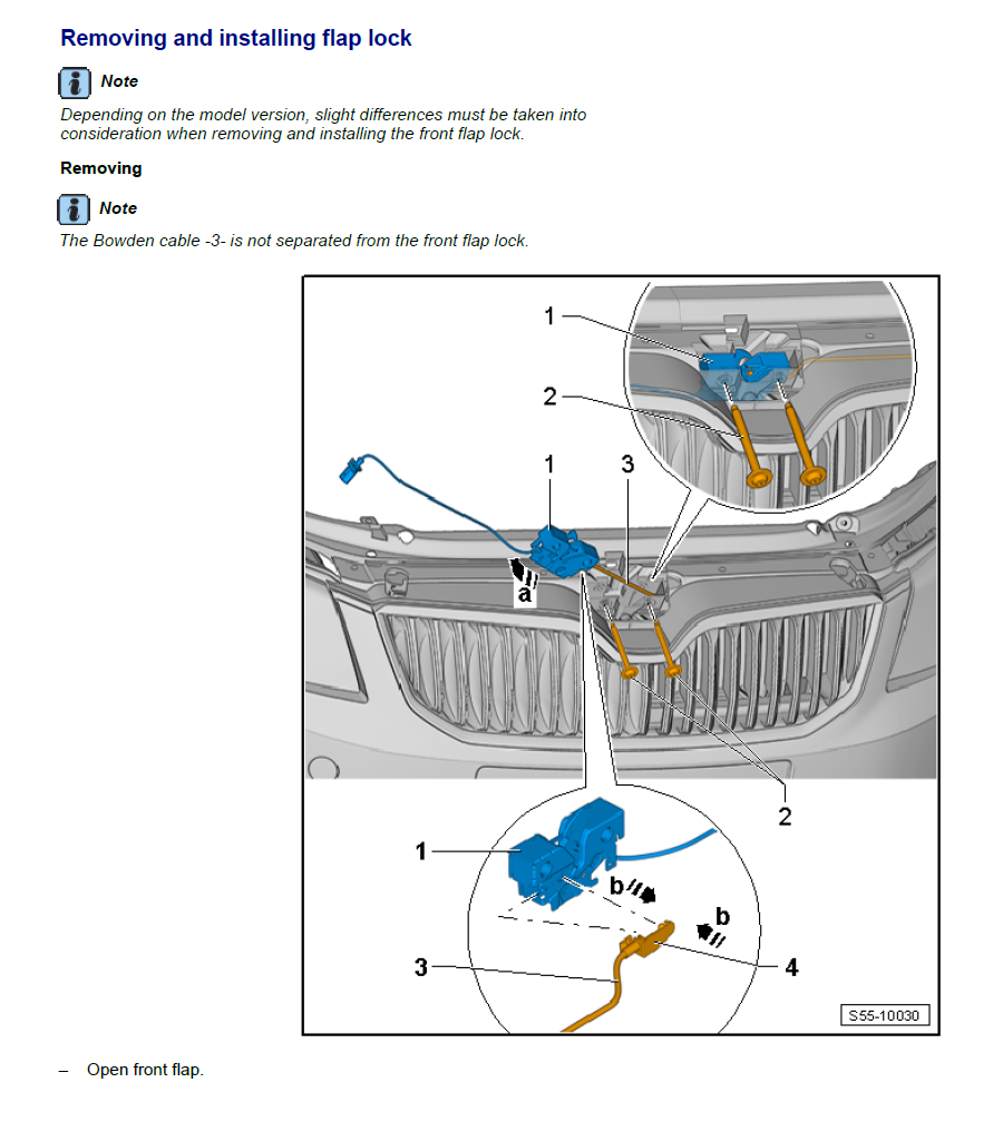

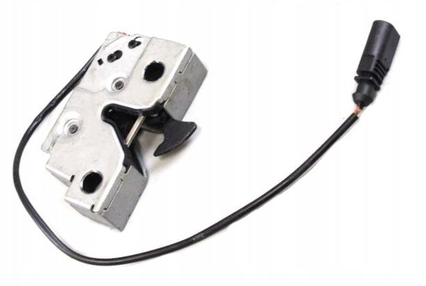

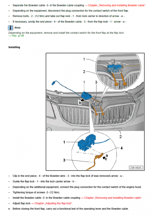

Microswitch in the bonnet lock, could start by checking is the wiring connector corroded
