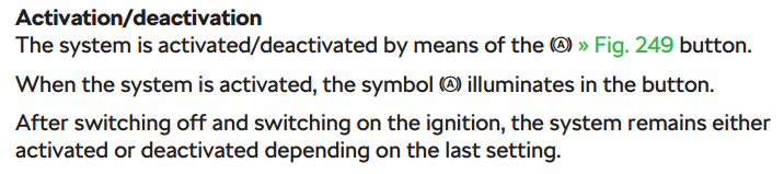

Both the electronic handbrake as well as the Auto hold function are off unless you switch them on.
2020-04-01_203416.png.2071d8be287a0a0142052a0493550be5.png2020-04-01_203445.png.9f47c65de6a77363116cd4c5583e2bb9.png
