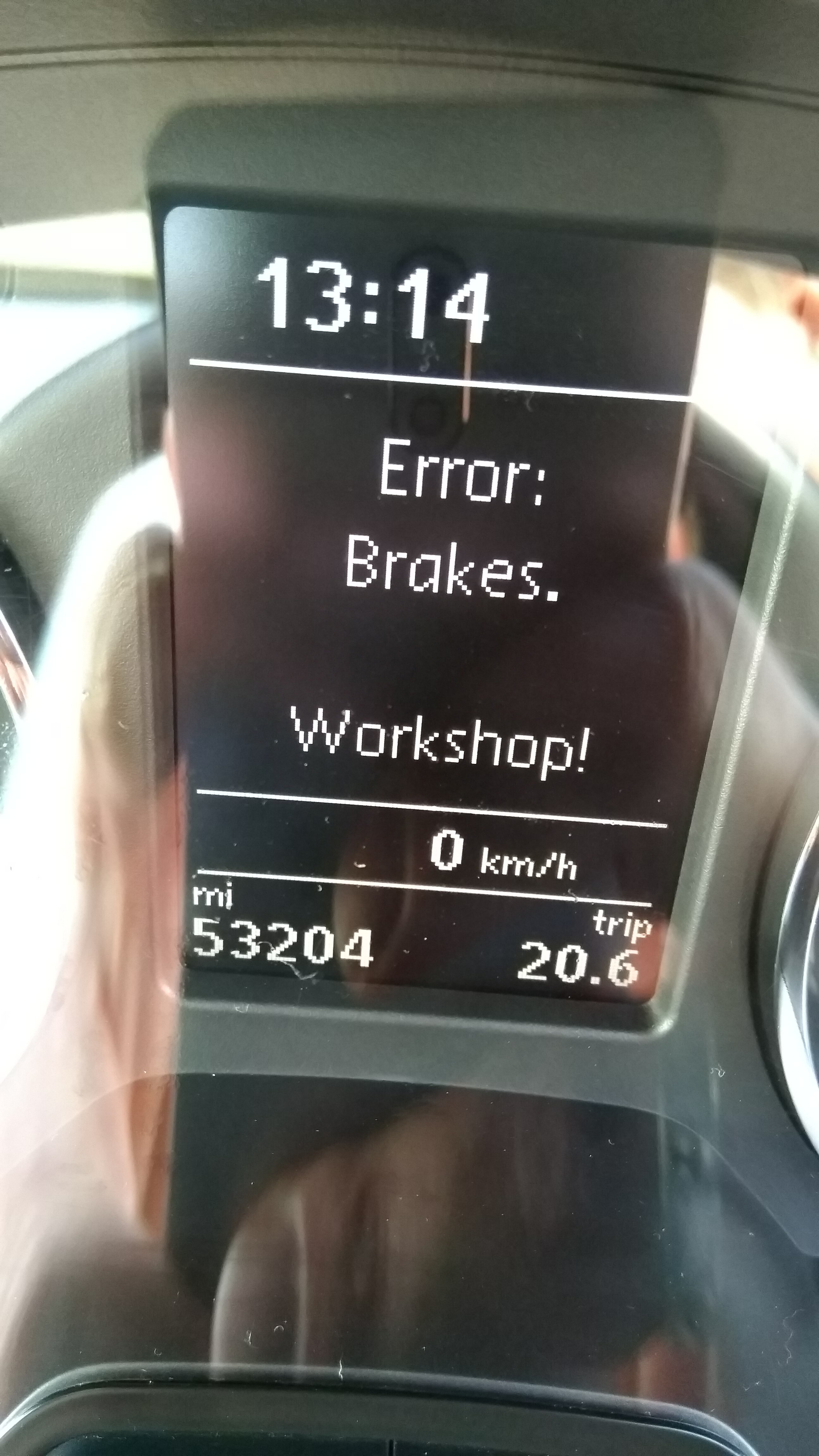

Hi,
My car hasn't been used for a week, and come to start it today and the following message popped up.
Is this because the car hasn't moved?
It went into the garage recently for a service, and they said the brake fluid was around 3% water so I should.get it changed as soon as possible. Not sure if that's any relevance?

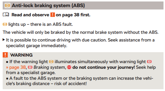

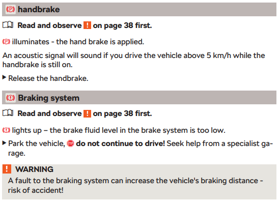

The only thought from me given the mileage, are the brake pads low or brake fluid low. Both would maybe give a dash warning if low.
My Mazda gives a red brake warning light on the dash if fluid is low.
Check the above first but consult the handbook for answers but if your knowledge is limited then best call is a garage if available.
Presumably you don't also have any of these warning lights on the speedo accompanying the central display error message?
Thanks for the replies!
Apparently it popped up because the battery was flat.
Charged it up and the message has gone.
