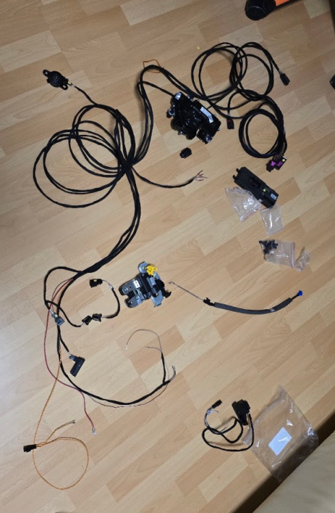

I succefully retrofited eletric tailgate for my Octavia MK4 Estate
What u will need
Odis with online account or ODBEleven with PRO sub and Odis offline
Control unit 5WB959107 from donor octavia mk4 or from diffrent car/new but u will need to flash correct dataset for this unit with ODIS
Cableset https://www.aliexpress.com/item/1005011673296593.html
Bowden
Motor for bowden should have same letter as bowden on IT
Different lock for tailgate
Interiour button on drivers door
Button on tailgate
Speaker
Electric Tailgate Support Rod
Bolts
Coding
Edited by Horalius
By any change do you have any part numbers for the entire retrofit?thanks
All parts ale for combi/estate model
cableset from china
2x small cables from china, dont need if u cut the original cables
https://www.aliexpress.com/item/1005001908131035.html model 6 and model 3
Driver Door Button need also plastic around it! cant find it atm
565959831
Tailgate button
3C0959831A
Ball Studs
657827850 4x please chceck correct vehicle year
2x Trim
5E9827721A
Servomotor for rear lid
5E7827851 2x please chceck correct vehicle yeari used aftermarket one original too expensive
Servomotor for rear lid lock
5TA827887B
Bowden for rear lid lock
3V9827532B number on this should be same as on lid for servomotor for rear lid lock
Lid Lock
5E3827506
Buzzer for tailgate
8E0919279
Control Unit suggest to get from donor car or u will need to upload dataset via ODIS
5wb959107
Hope i didnt forget anything <3

Looks same as mine, what is different?
If u connect it according to this it should works.

it can be connection between BCM and Gateway soo its doenst matter if u connect it to BCM pins or Gateway pins, i was connecting it to gateway pins
With also goes into Tailgate locking mechanism
ok my car is RHD and BCM module and fuse box are on left side by side so I will connect that to.BCM
gateway is on right .thx
pozdravujem na Slovensko.dik
I suggest to connect it to the Gateway according to manual.

update job done
Connected to BCM pin 16/17
fuse to position 37(Fuse 16.2/2X6.3 N91274203)
rest like guide from previous post
I used sane parts like Horalius in first post
just electric tailgate motor 565 827 851 A I have hatchback
modul 5WB959107A(dataset V03935356FW) taken from hatchback

Good job!! :)
