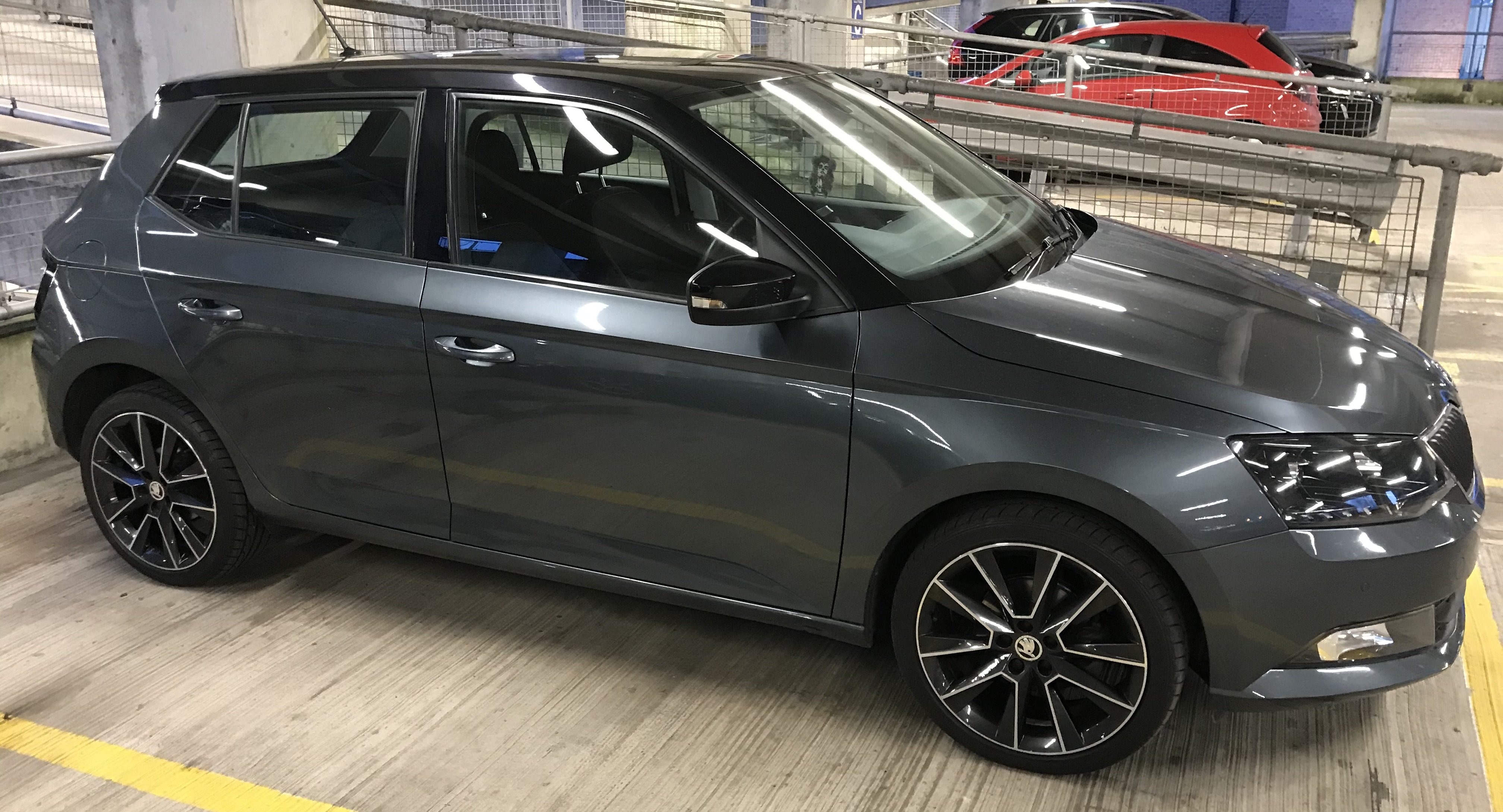

Haha that's not mine, just grabbed a pic off the 'net. Mine's Quartz Grey;

That's nice colour. Did you get extended warranty direct from Skoda?
