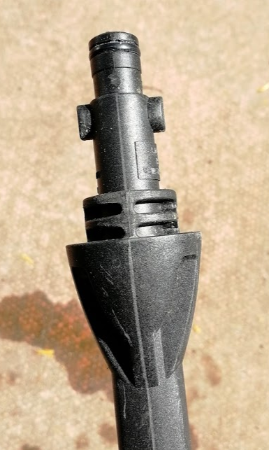

The connector on my C110.7 (i.e. the end of the lance that attaches to the gun) is this:
That seems to match the Pro connector most closely...but I didn't think the C110 was classed as a Pro model?

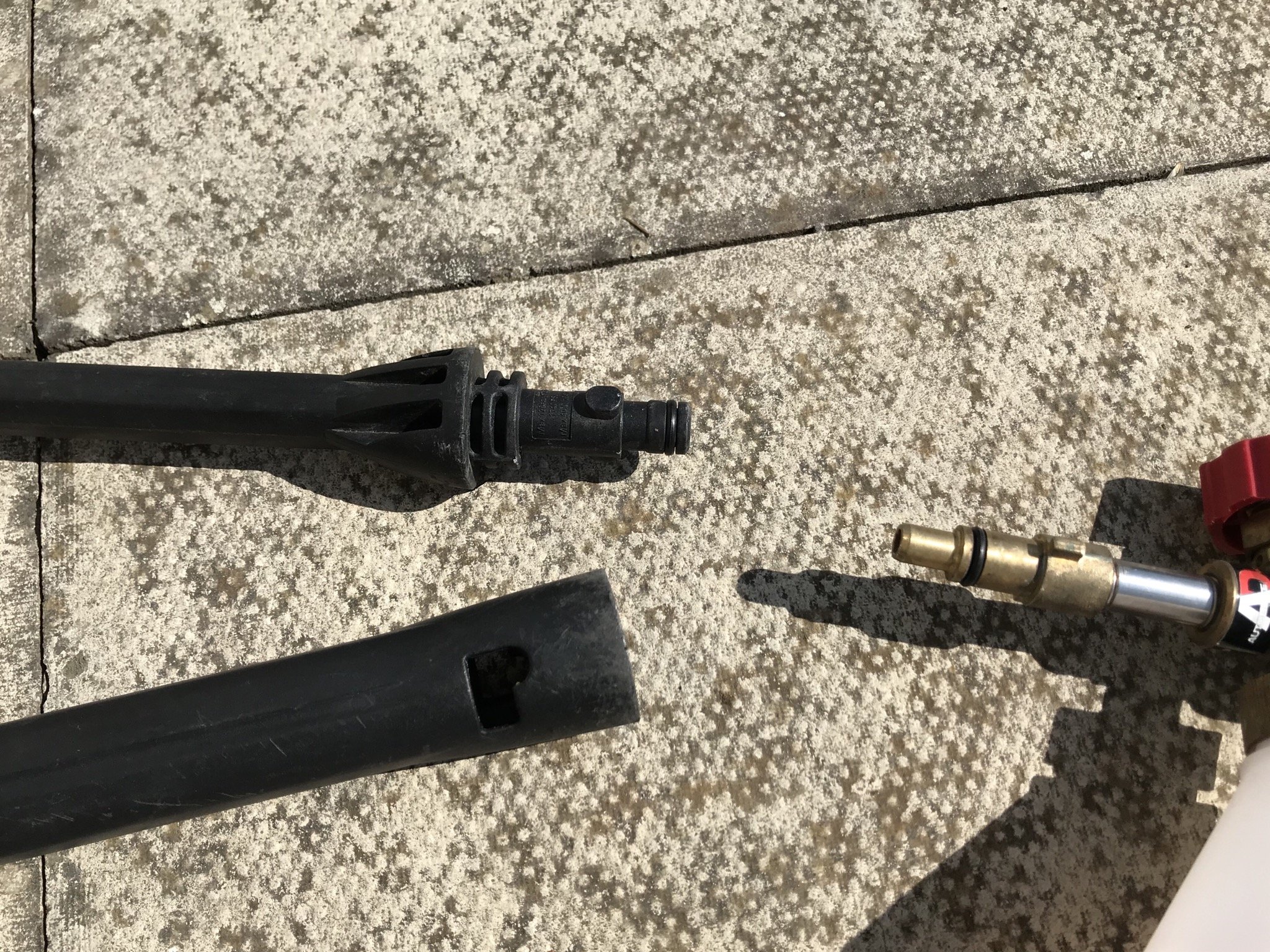

I’ve the bayonet for my c120.... it looks like you’re trying to attach it to the wrong part!
The adapter fits on the snowfoam bottle that then slots in the gun of the jet washer (the bottom of the two on the left of the picture)

1 hour ago, slicendice said:
You need the one on the right, Nilfisk/Alto fitment.
I ordered a snow foam lance for my Nilfisk and I just emailed the pics same as you have to the company and they told me what I needed. 👍
Saved me from buying the wrong one and having to wait for a few more days before running around the car like a big kid!😁
