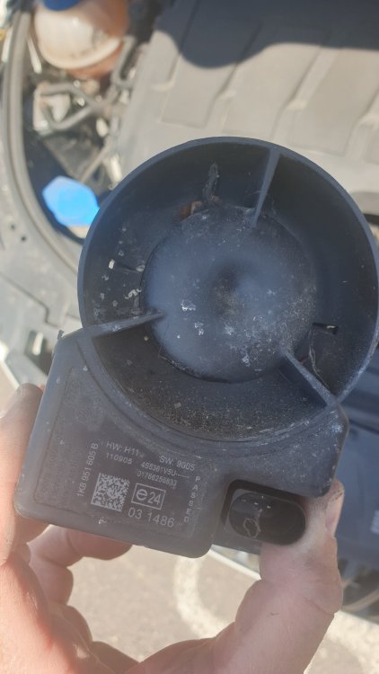

As Cozza89 has said, my Fabia Monte Carlo has done the same. I whipped the siren off of it this morning which is located under the scuttle next to the right wiper.
I have been looking for a replacement battery but can't seem to find one.
There are plenty of sirens available but i guess i just take the chance that they are not coded and the battery is good.
At the minute the car locks and drives fine with out it. Plus no annoying 5 o'clock wake up.

My alarm seemed to reset itself and behave once I'd disconnected and reconnected the main battery. I've since replaced this battery with no probs so far, but that's a really useful photo Skodasimo, thank you. Now if it misbehaves again I'll know which part to rip out at 5am! 😀

While it seems that you can't buy the correct internal battery, from interweb chat about this, you just buy 2 1/2 batteries and tape them and wire them up same as the original one.
