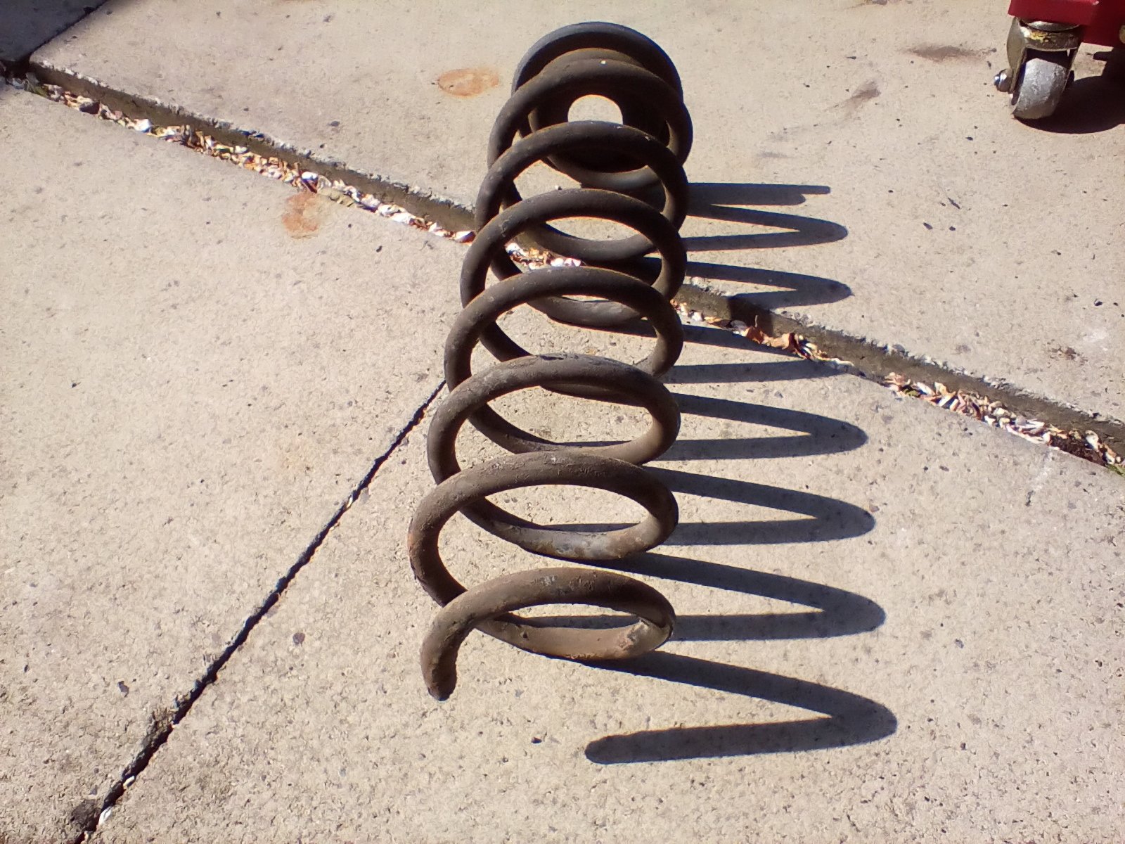

Hi All, while servicing my scout I have noticed one of the rear springs has a bit missing off the bottom (see pic), are they heavy duty springs or just standard ones, on eurocarparts  website it lists 4 standard and one heavy duty, now I do tow  a caravan so I am thinking about the HD ones so I presume they would fit ? Anybody know for sure ? Cheers Stuart
The paint on it is grn\grn\red and looking on Zzap for info it's a 1K0511115CR !

According to the gknautomotive.com online catalogue, 1K0 511 115 CS is the standard rear spring for the Skoda Octavia Estate 4x4 Scout 2010-2013, and 1K0 511 115 CT is the reinforced rear spring for the Skoda Octavia Estate 4x4 Scout 2010-2013. As you can see from the specification of each spring, the CR version is the softest, the CS version is a bit firmer, and the CT version is the firmest.

You can see that the 4x4 version uses much heavier duty rear springs than the two wheel drive estate, and for that reason you may find that the standard 1K0 511 115 CR rear springs are hard enough.
