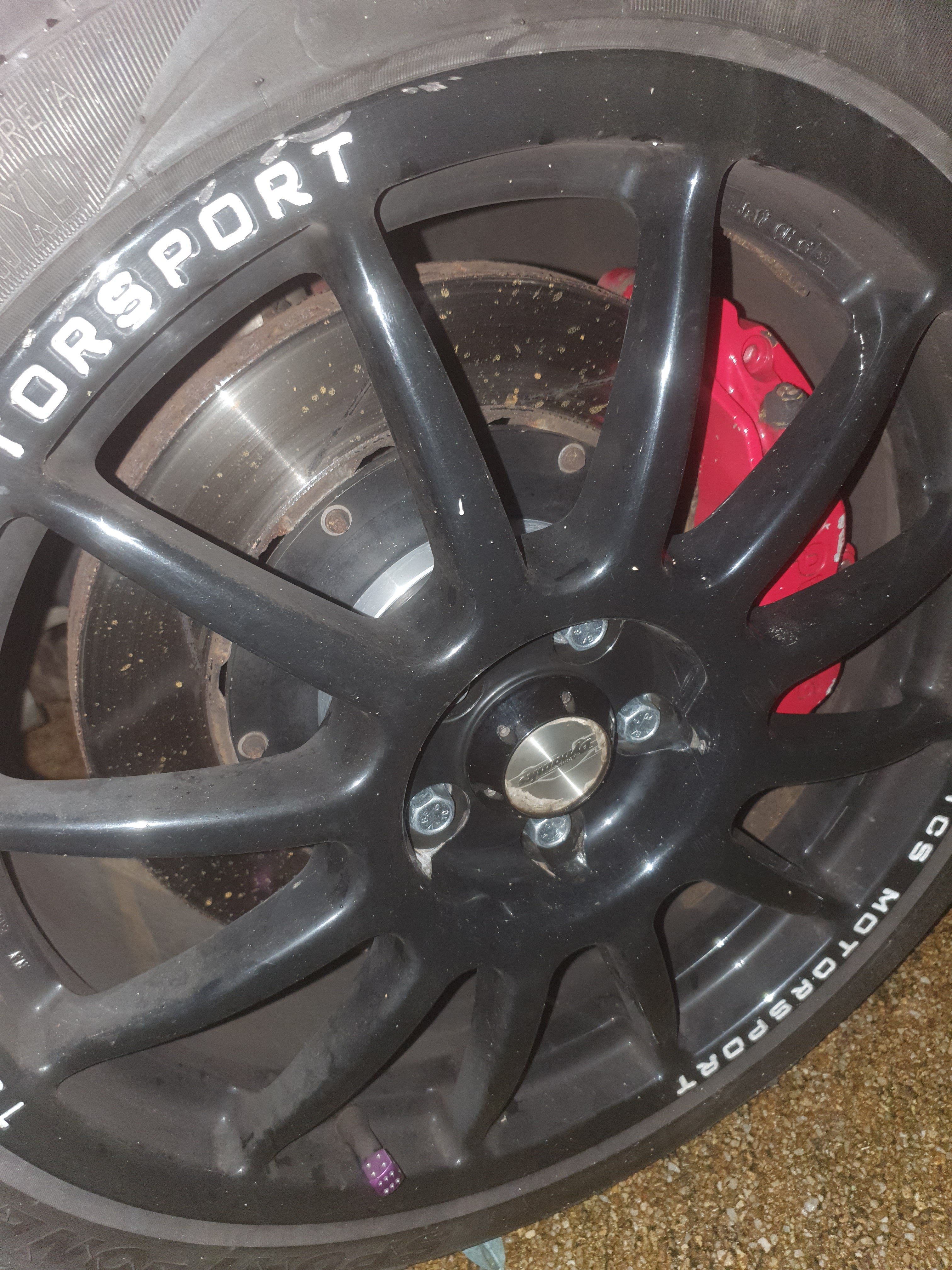

I have these brakes on my fabia vrs i want new disks but these floating disks are really exspensive would rather buy lcr brembos. Does anyone know if i can get solid 330mm disks as i there fairly priced or for these do i have to stick to the floating disks thanks20200209_184707.thumb.jpg.9497f70db82c753b75a1b3b018e6ea51.jpg

That type of caliper is really designed to work with the floating discs, you may have trouble finding a fixed disc with the correct dimensions, you could remove those discs and have them machined to remove the lip and clean up the surface if there's enough meat left on them.
if they are the same APs that were on the ibiza cupra they will work with the standard cupra discs which were 312mm non floating

They're 330mm, how are 312's gonna fit?
