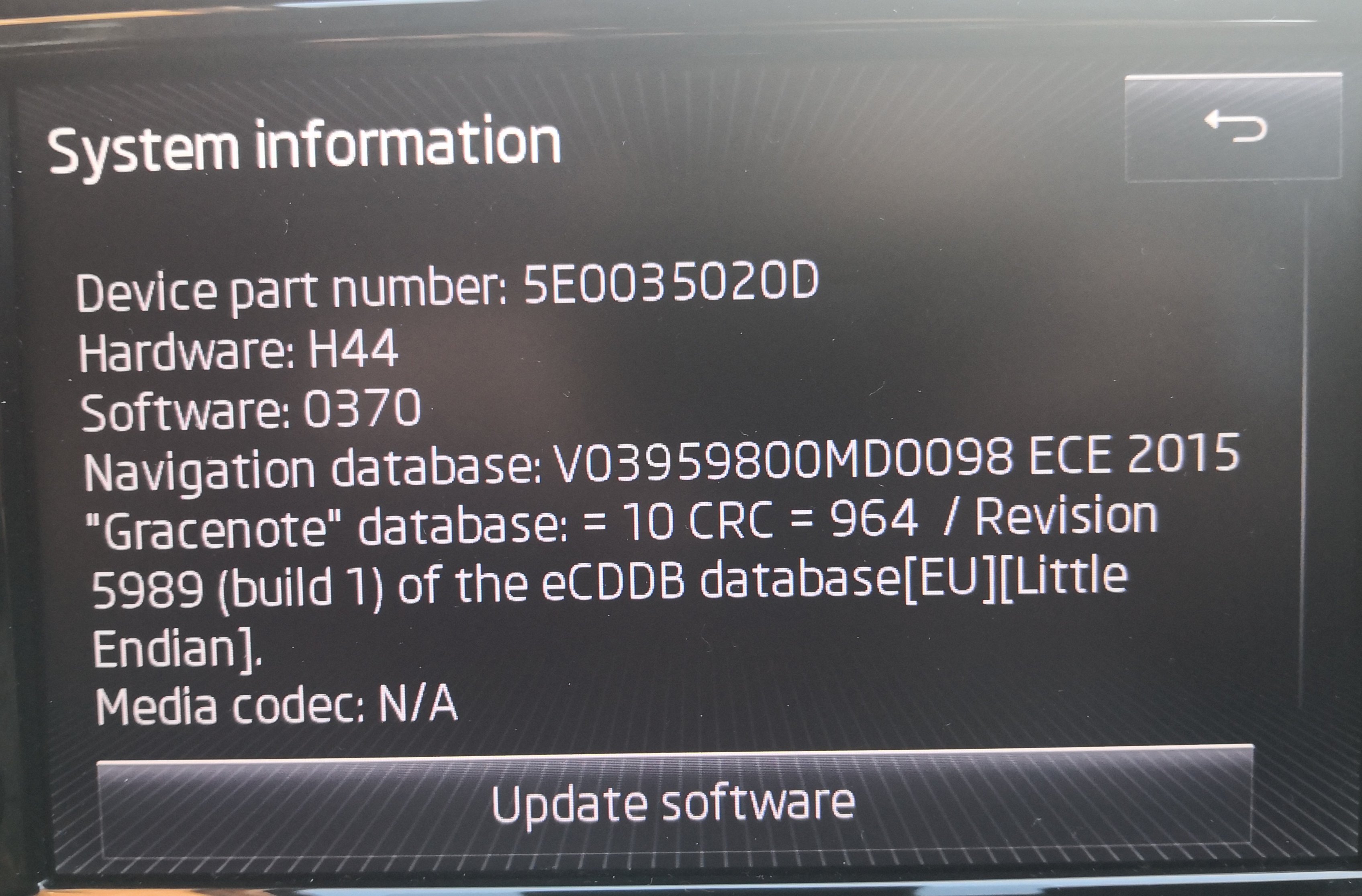

I've uploaded a pic of the software etc if that helps?!

Try holding the power button down on the radio to reset it. I think you hold it down for 10 seconds or until it reboots. Sometimes it is a software issue and is easily fixed.
Thanks mate, I tried this after someone had posted about a similar experience.... Unfortunately for me it didn't work ☹️
Next thing is to try where the antenna connects but not sure where that is yet!
