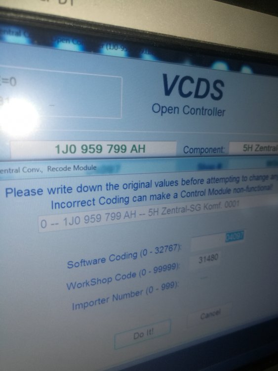

Today my friend tried to reprogrm my CCM for remote Windows oppening/closing-it is not offered in menu for my CCM.
Part number is on the picture.
So which CCM part number do I need?????
Help appreciated

Unless I'm mistaken, the MK1 does not have this feature, it's only for the MK2 2006 onwards.
If you wanted that feature you'd need the AlienTech controller - http://www.alientech.net/

Hi, tnx. Alientech doesn't selo this module for now, and in that thread mentioned link for downloading program iz doesn't exist any more. But thanks for the effort and info. I mailed alientech if I can buy one. We'll see what they say.

Do you also have VRS 1.8T?
What is your CCM number?
My is 1J0 959 799 AH

1C0 959 799 B ON MINE , never had an issue at all

Well I found this:
MKM Lite 1.20 version can be used only in the cars with comfort units 1C0 959 799, therefore the third generation units. These units are in the following cars:
* Škoda Octavia / Octavia Combi – since vintage 05/2001
* Škoda Superb
* VW Passat / Passat Variant since model year 2001 (vintage year 2000)
* WV Golf / Golf Variant since model year 2001 (vintage year 2000)
* VW Bora / Bora Variant since model year 2001 (vintage year 2000)
* VW New Beetle since model year 2002 (vintage year 2001)
* Seat Toledo since model year 2001 (vintage year 2000)
* Seat Leon since model year 2001 (vintage year 2000)
I just tried on my late 54 and my late 55 and it doesn’t work. I have the 1C0 959 799 B. So I or anyone else would need to download the MKM Lite software and get it activated.
