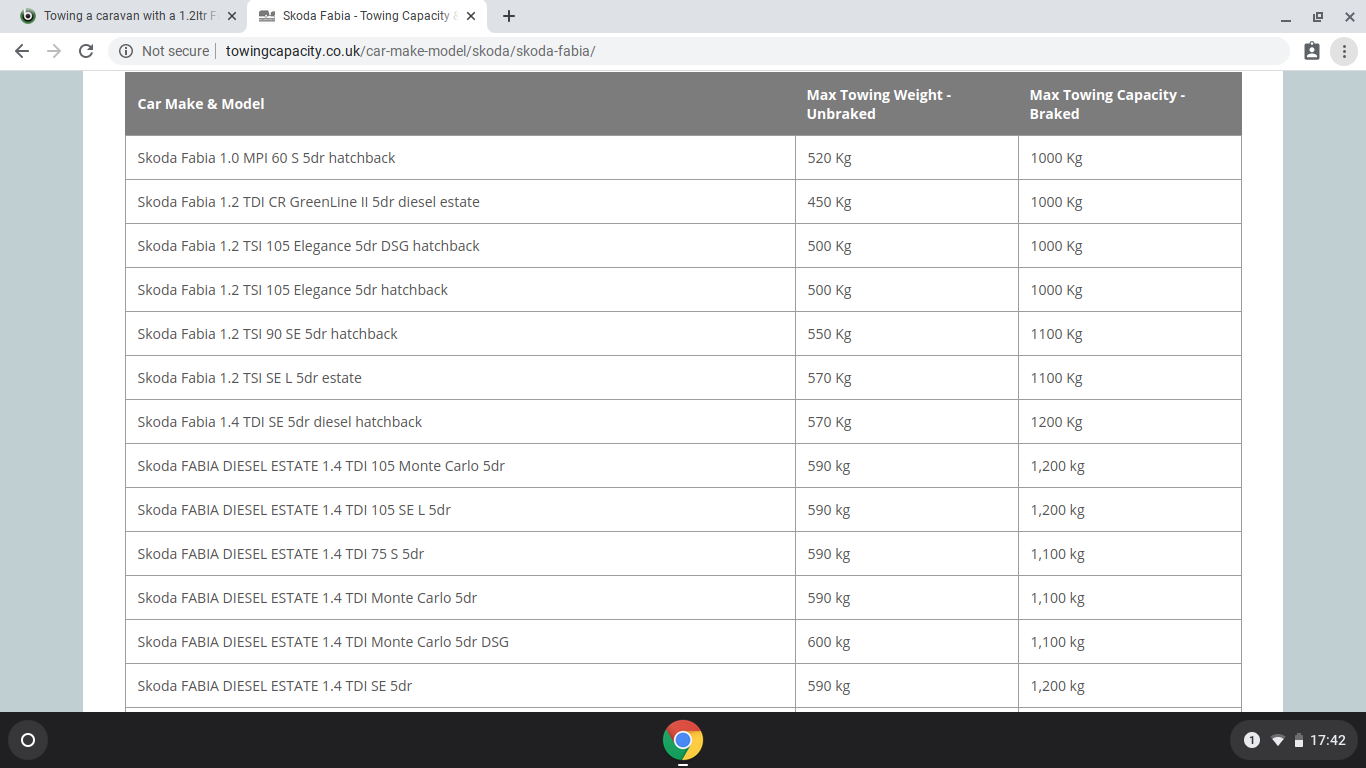

It will tow a caravan that weight.  It can tow one.
Take into account the weight of what is going in the caravan and in the boot of your car.
