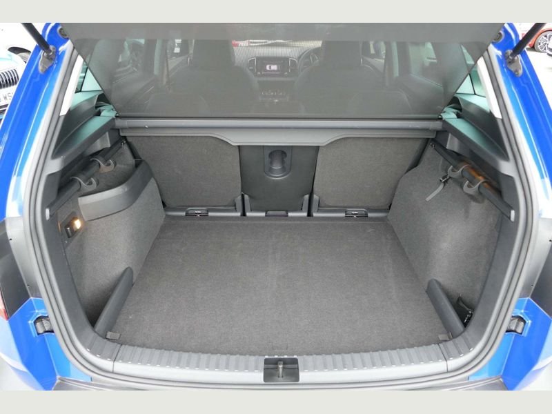

I've drawn a blank searching around for pics of Karoq with the variable / adjustable height boot floor. Can't even find ones on used section. Seems like it's a £180 option only cars with a fixed rear bench - i.e. SE, SE Tech and Sportline.
Did anyone select this option when purchasing their car? Was just interested in what sort of mechanism is used on the karoq. Most other manufacturers simply have a false floor which you can remove and then set to a different position but I know from my Octavia estate that the floor is fixed and it's adjustable with a wheel-type mechanism. I can understand the reason for such a complicated contraption on an estate but on a small SUV?

Further research shows this is described on page 211 of the Karoq owners manual. (You can download a copy of this from the Skoda UK website even without owning a car!)
Basically it shows that the far end of the variable boot floor engages in one of two support ledges on the sides of the boot, which are set at two different heights.
It also shows a higher level ledge that will tilt the floor up to connect to the folded rear seat back!
And very interestingly the page states "Park position: For instance to reach the spare wheel more easily the variable loading floor can be set to the parking position. " This holds the floor up vertically at around 80 degrees to the horizontal. So it looks like there is no problem with having a spare wheel under the variable boot floor - despite the configurator not letting you include both options. So perhaps my idea of including the variable boot floor as an option, and the spare wheel as an accessory afterwards??

Having seen the thread describing how to fit a full size spare wheel, perhaps it's because it blocks access to the release clips low down at the back of the VarioFlex seats??
I thought that too, but even with a factory fit space saver wheel, those clips don't appear to be accessible. Easy remedy tho, just slide seat forward and then you should be able to access it. ( In theory! I've never even seen a showroom car with the spare fitted to test ).
The only thing I can think of is the varioflex seatbacks sit higher than the fixed seatsbacks when foldec - i.e. they're above the height of the load lip. That'd leave a ridge therefore may be why it's not an option. Wouldn't matter to me tho, it's the free space underneath the floor that's of most concern to me.
If the varioflex seats are like those in the Yeti then the seats cannot be tipped forward unless they are in the rearmost position.
I DIY'ed my Yeti variofloor using one from a MK1 Octavia (as I had already done on my MK2 Octavia) and came up against the above problem, I had to make it slightly shorter and move the bulkhead rearward to access the seat lift mechanism, I made a honged flap which closes off the gap to stop items falling down the gap, I think the OEM variofloor has something similar.

which describes the variable boot floor at 5 mins in, and shows that there is a soft carpet-like layer under the variable boot floor which he lifts up to reveal an empty spare wheel space. Looks like you could add a spare wheel there but it may make the bottom of the boot a bit lumpy rather than flat, and may stop you lowering the variable boot floor to it's lowest level.
