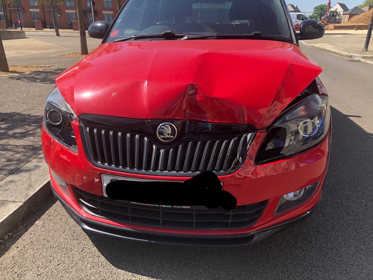

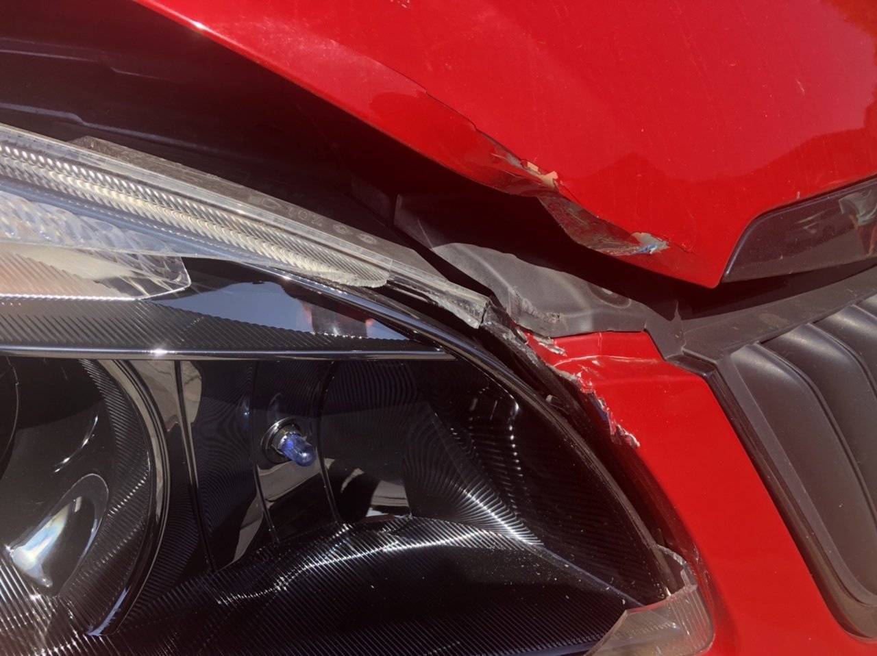

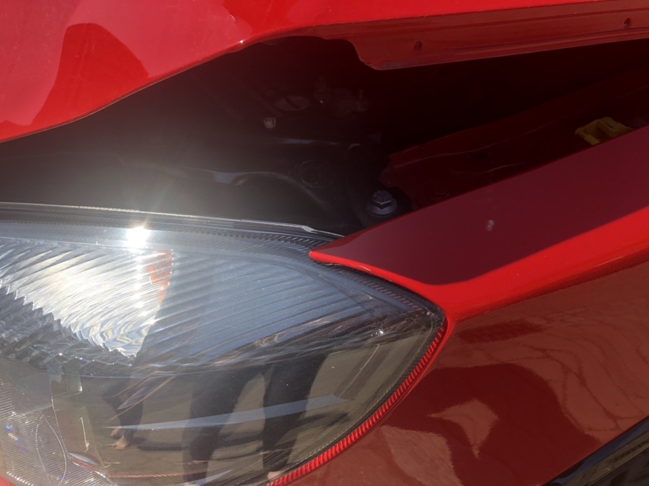

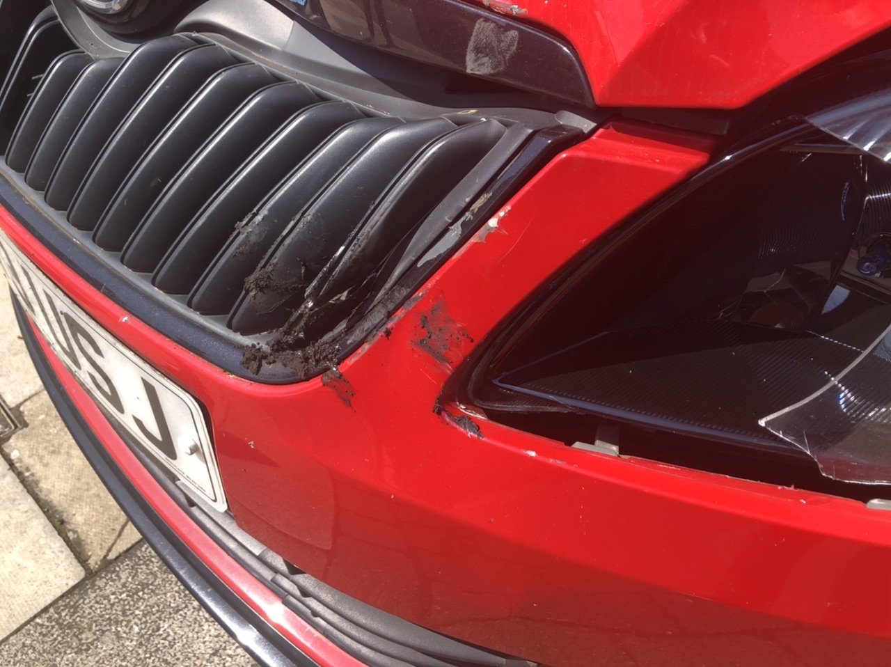

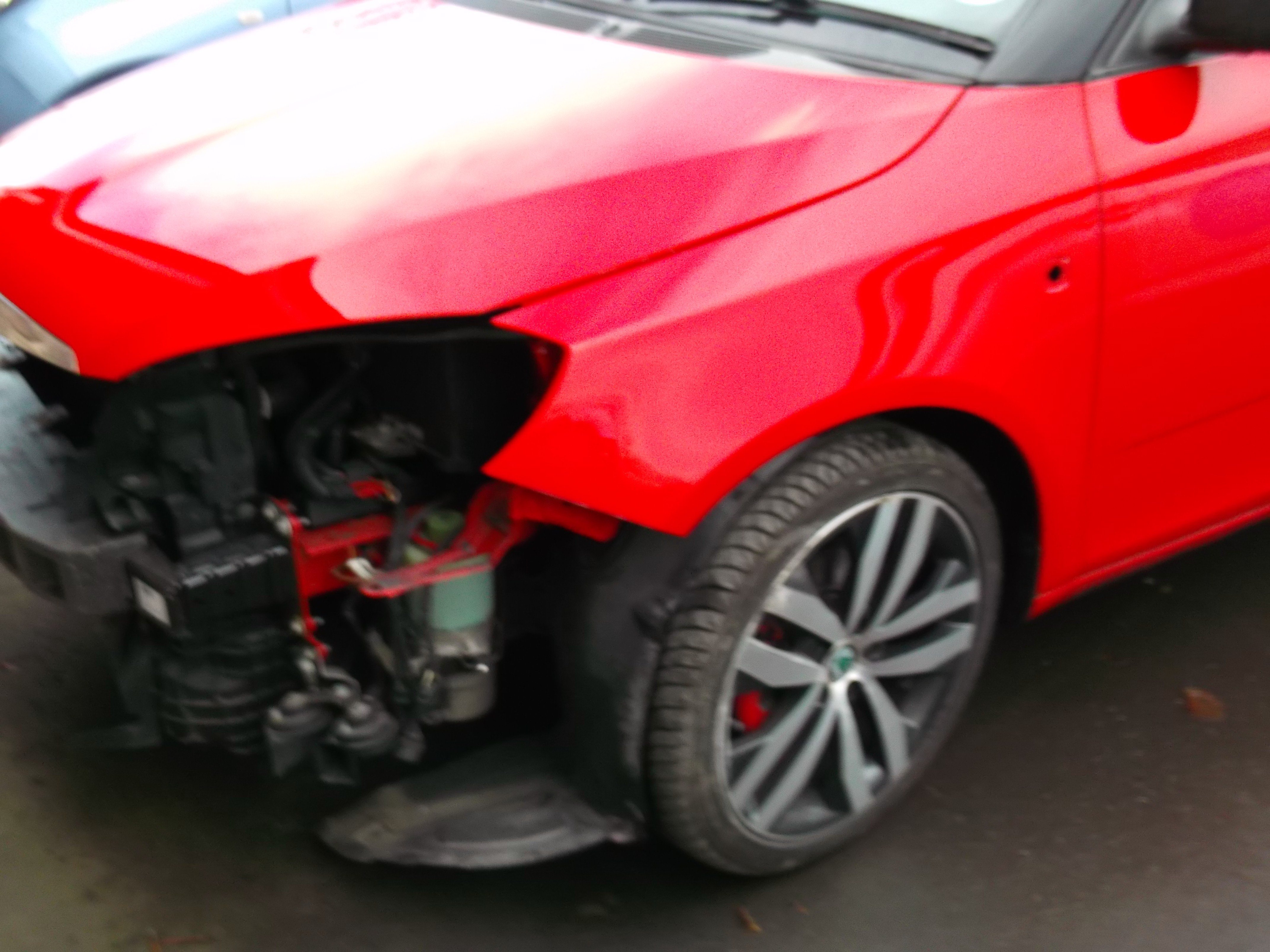

Lorry reversed into me today at low speed, I was reversing too, just not quick enough!   No engine lights on and drives ok so, on the face of it  looks like bonnet, both front lights, minor bummer damage and possibly a wing.  It’s a 63 reg Monte Carlo tech with 48k on the clock.  Thanks

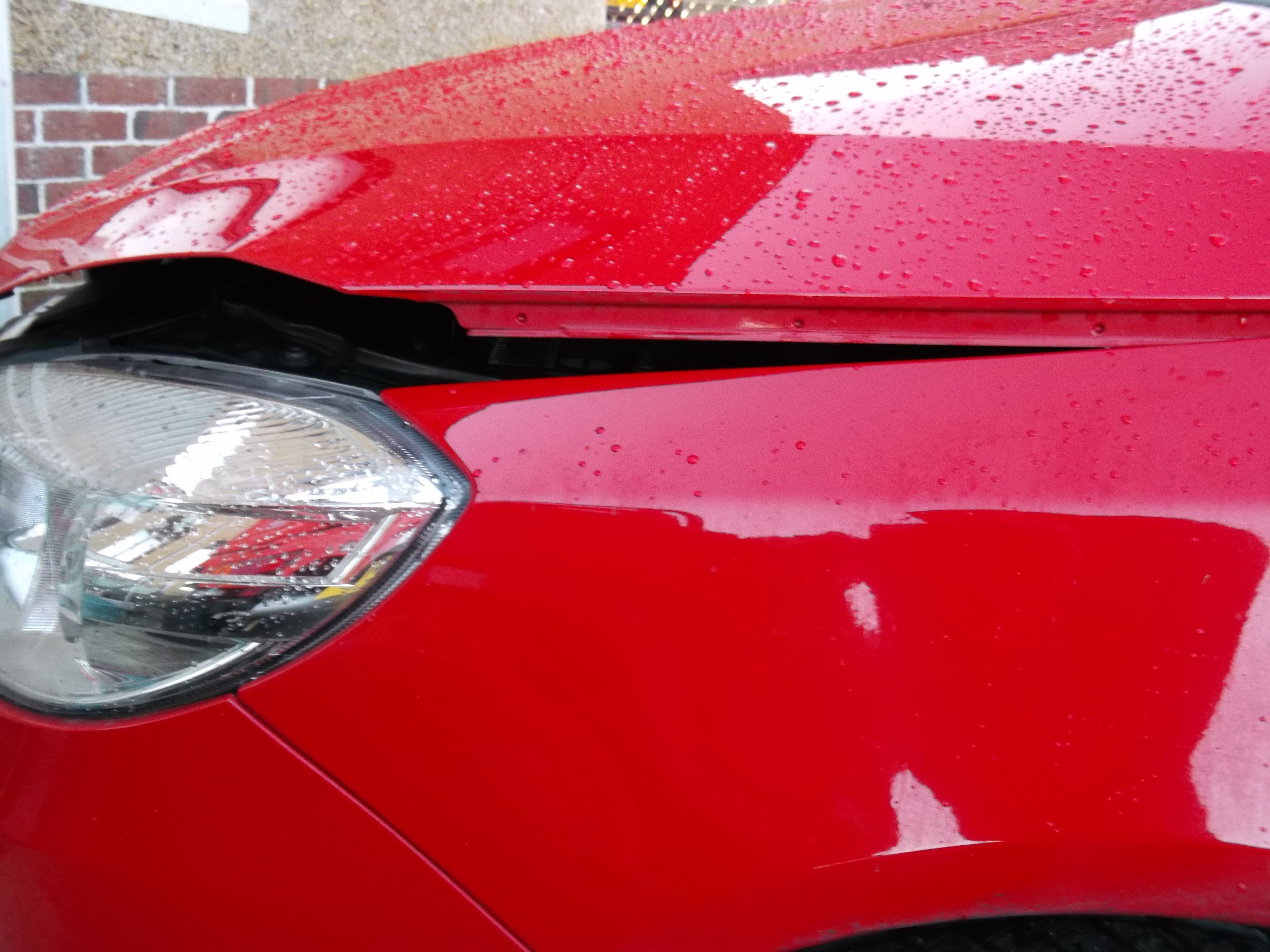

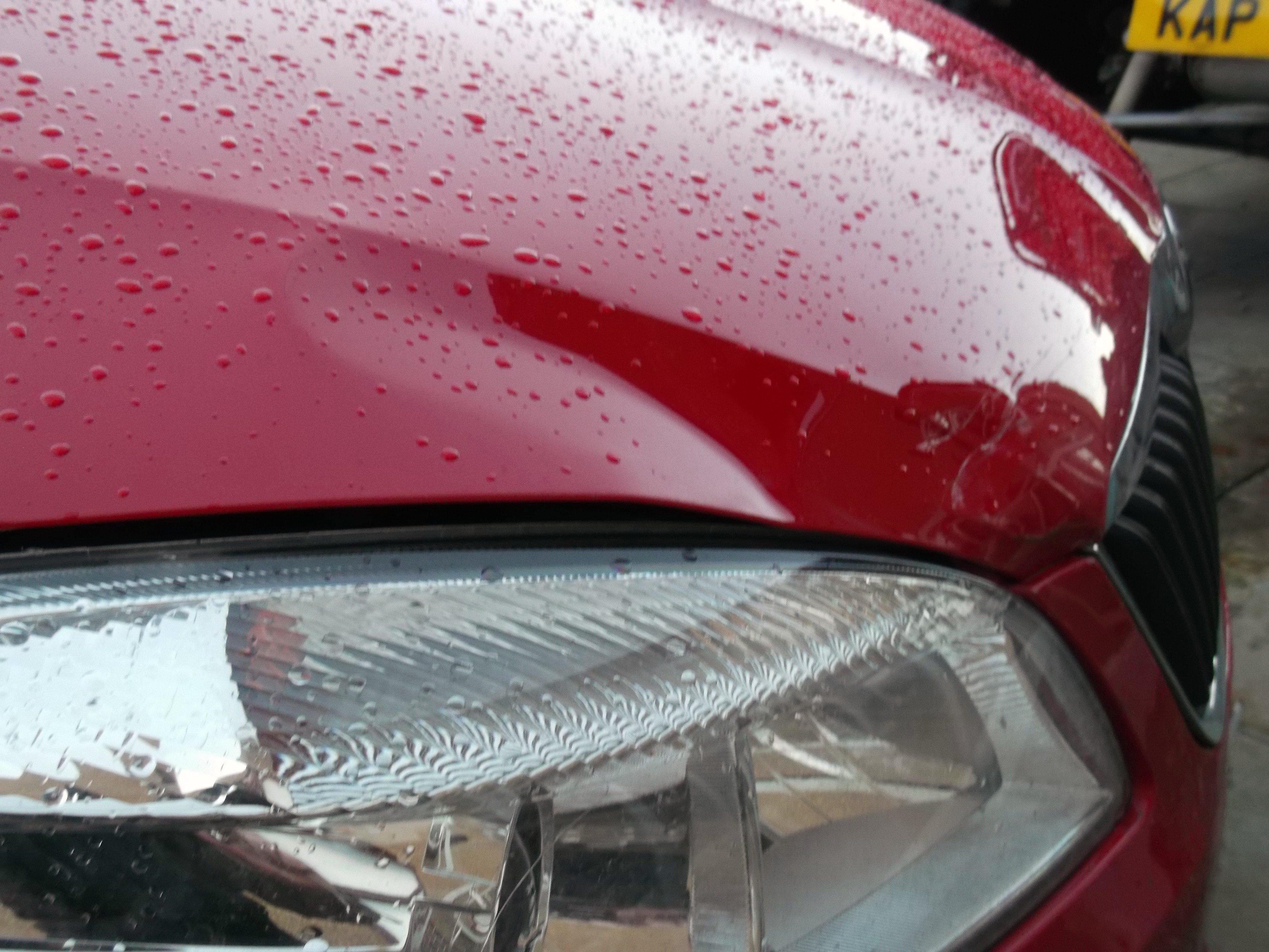

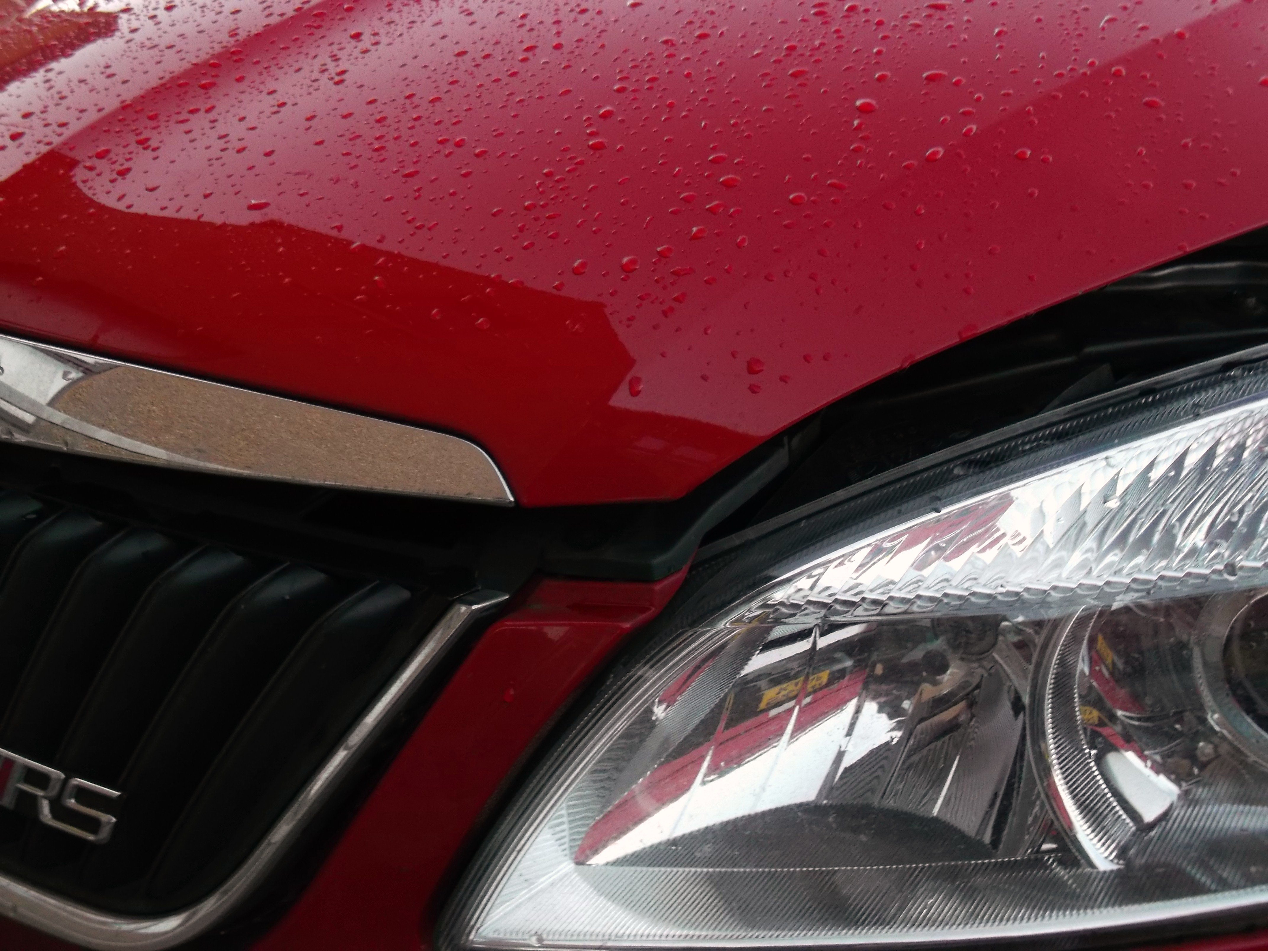

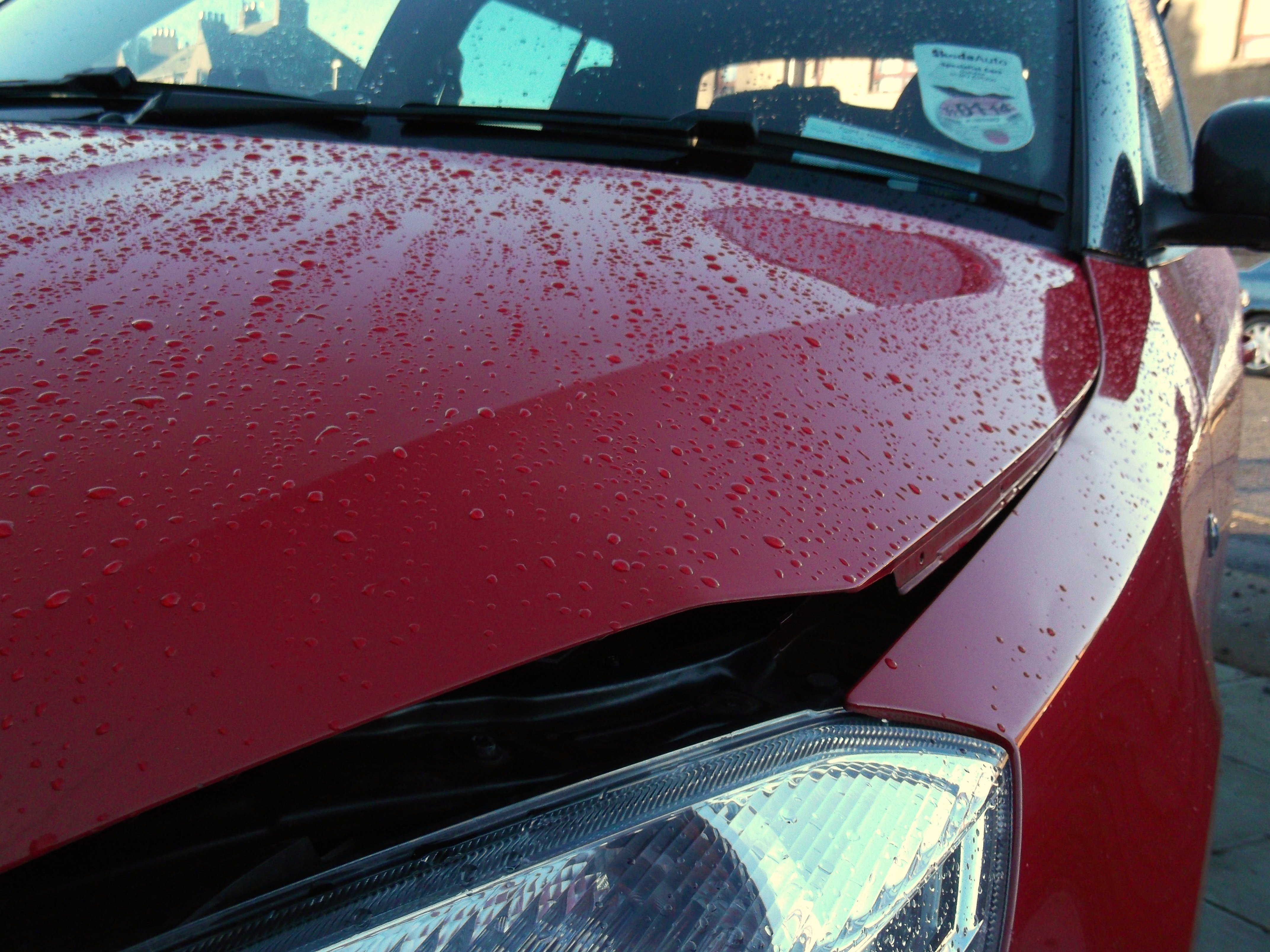

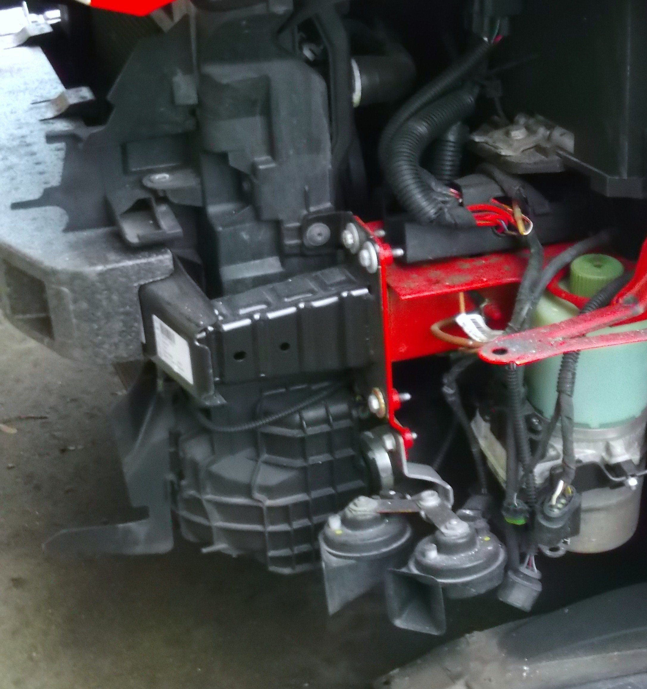

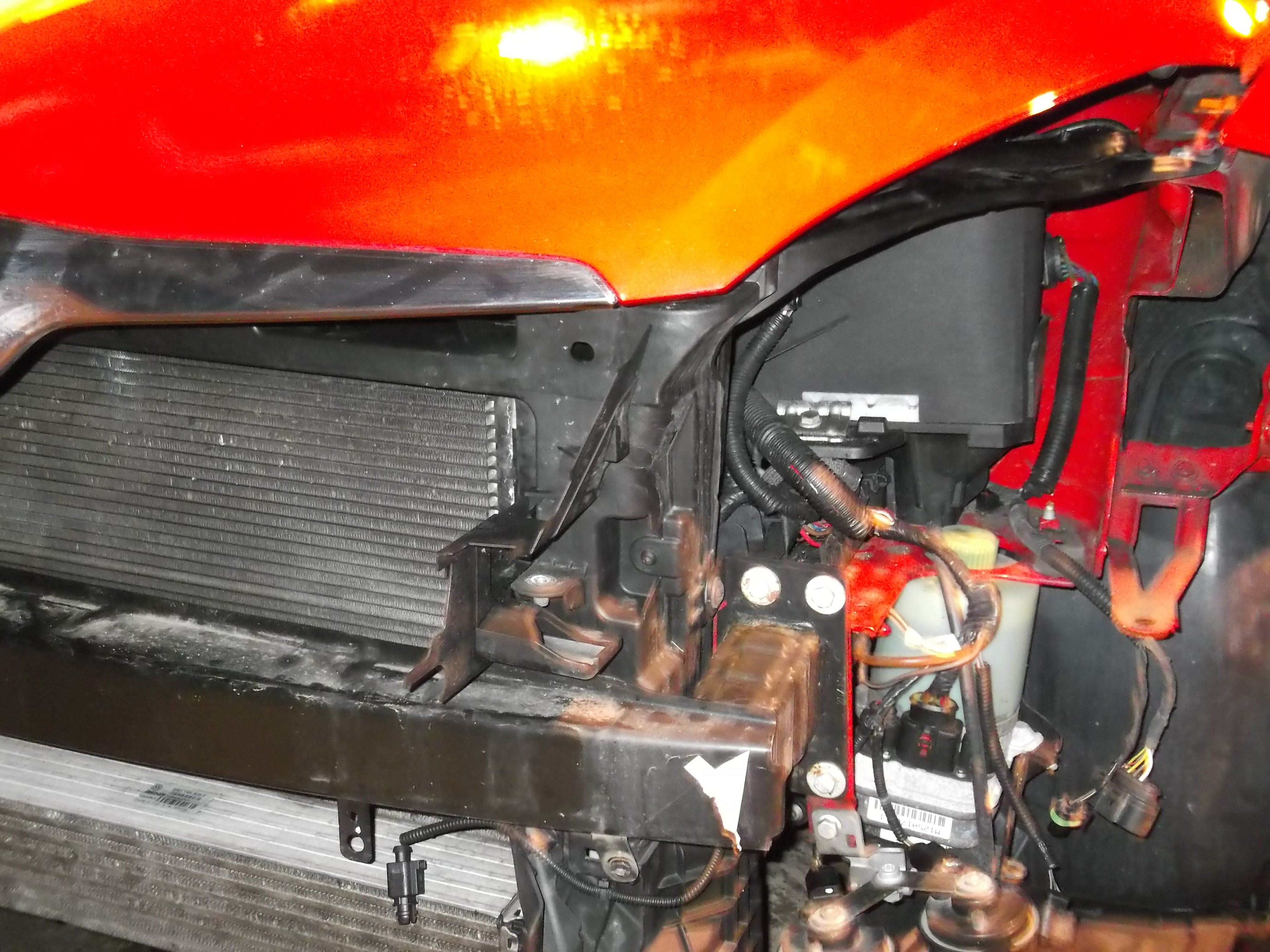

I had a vRS maybe 5 years back with a bit less damage but same parts and the Insurance quotes were £3,500 ish.
Bonnet, hinges, front panel, headlight, front crash bar and bits and pieces. Not a front grill though.

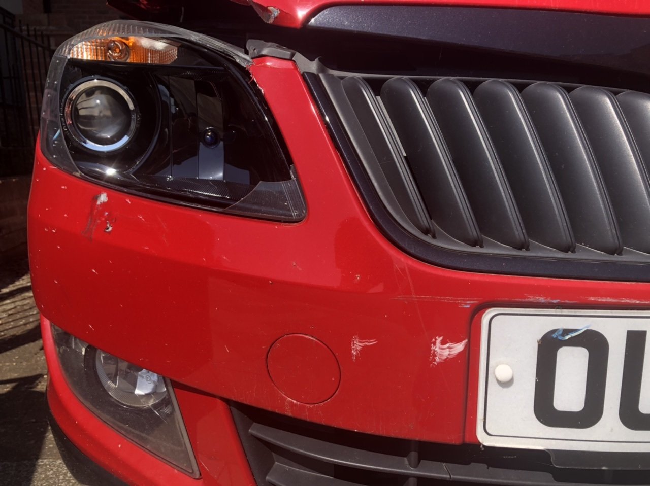

You see the two little paint scuffs on the bumper of the first photograph?

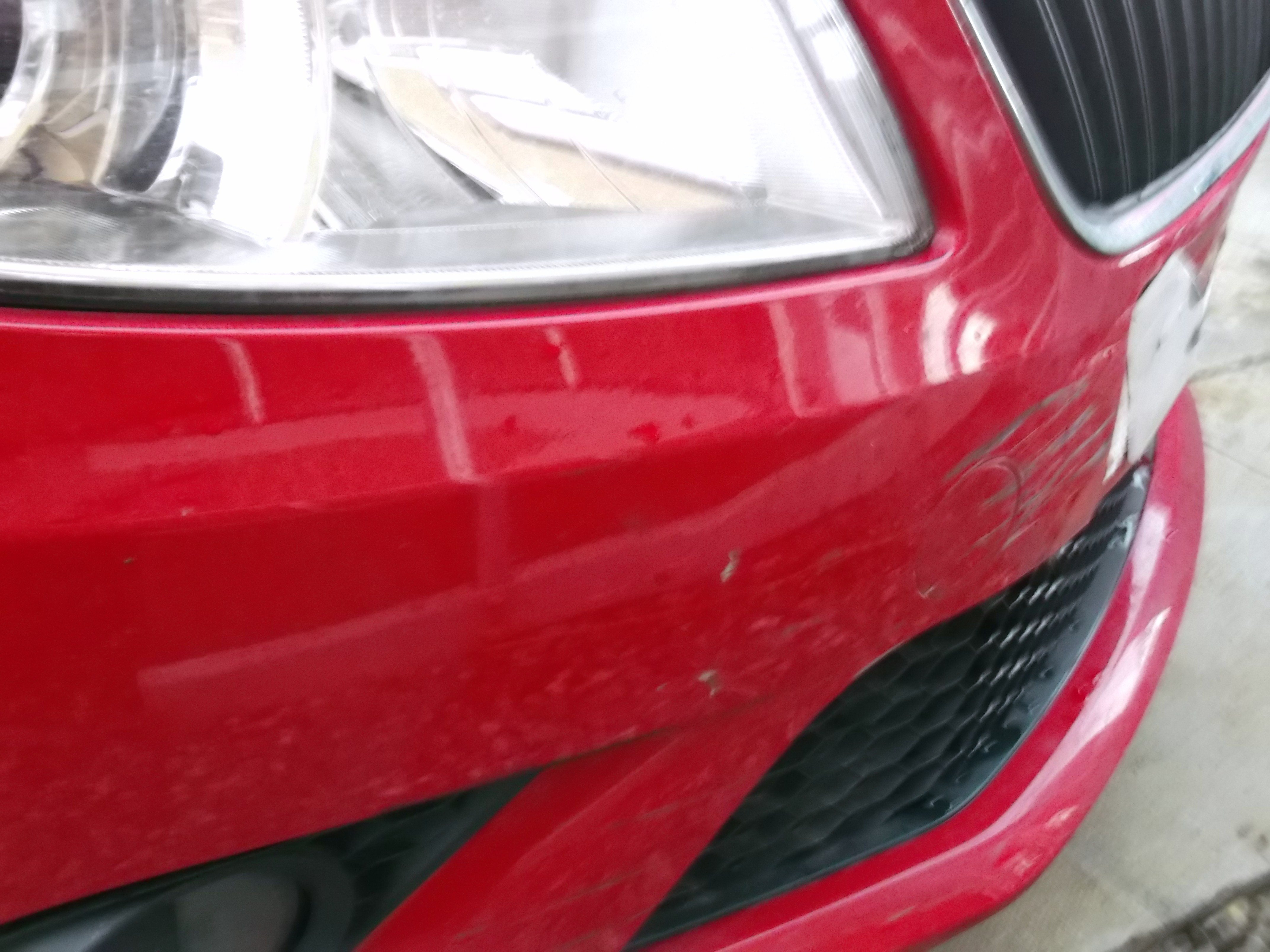

My 2015 Yeti had (still has in fact) just one like that but half the size and the vehicle was written off 😯
No bonnet damage, a couple of slats in the grille broken and a cracked number plate.
It had however deployed all the airbags rupturing the dashboard and set off the seatbelt pyrotechnics.
During the rebuild it was found that the inner bumper iron LH longeron had compressed, it is the primary crumple zone, this impact was transmitted into the main chassis without deforming anything but setting off the airbag G sensor, the bumper iron had moved back and kissed the aircon condensor causing a leak.
The bumper (with new bumper iron) was refitted with just a cursory T cut over the scuffed area, no paint cracks or anything, I even reused the polystyrene shock pad behind it. Incredibly whatever the collision was transmitted sufficient force through a painted plastic bumper and polystyrene shock pad to collapse a crumple zone and deploy the airbags leaving no more than a tiny spot of scuffed paint and broken plastic grille slats.
It would be interesting to see if your car is economically repairable, if written off someone else will surely buy the salvage and repair it, you could have first refusal if it interests you.
Edited by J.R.
Sorry to hear that. Remember you should get offer to buy back the car from insurane company, depending what they offer. All these parts are bolt on. Granted, the car will be classed as write off repairable, so something to bear in mind as will undoubtedly effect resale price. Push comes to shove, the bumper will fine once prepped for painting, no cracks. Be interesting to see if any damage behind, such as radiator and fan, it all adds up.

Update all,  doesn’t look this is a write off all the damage is cosmetic nothing structural.  Garage have to do the dance with the insurance company now but looks like it will be back on the road

Can still see this being a write off the garage bill may be too steep for the insurance to consider. Borderline
Repairs have been authorised.  Should be back in 10 days £4300 was the quoted cost of repair.
No idea how you have managed to get that through, probably 75% of the value of the car maybe more 😲
this is why cars are written off, garages / repair centres simply rape the insurance companies......
If you were sourcing all the parts yourself im pretty confident you could fix that for <£1000
Maybe even £500 could scrape it
Agreed, and they will not even use genuine parts, those will be massively inflated prices on pattern parts.
