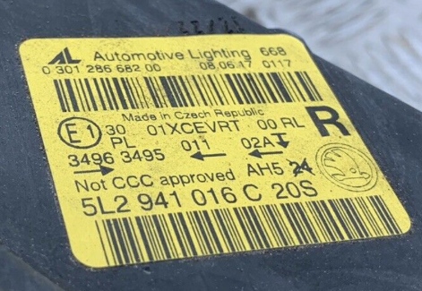

There will be a part number on a sticker on the rear of the light, what spec is the car and is it a RHD car?

Here is the part No.
5L2 is the model = 5L Yeti facelift 2 = RHD
941 016 C 20S is the exact spec of the light

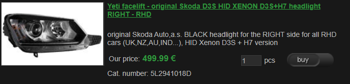

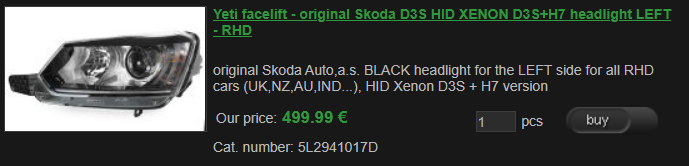

Superskoda sell them for €499 EUR / £440 GBP each...
http://www.superskoda.com/Skoda/Yeti/Lights/
