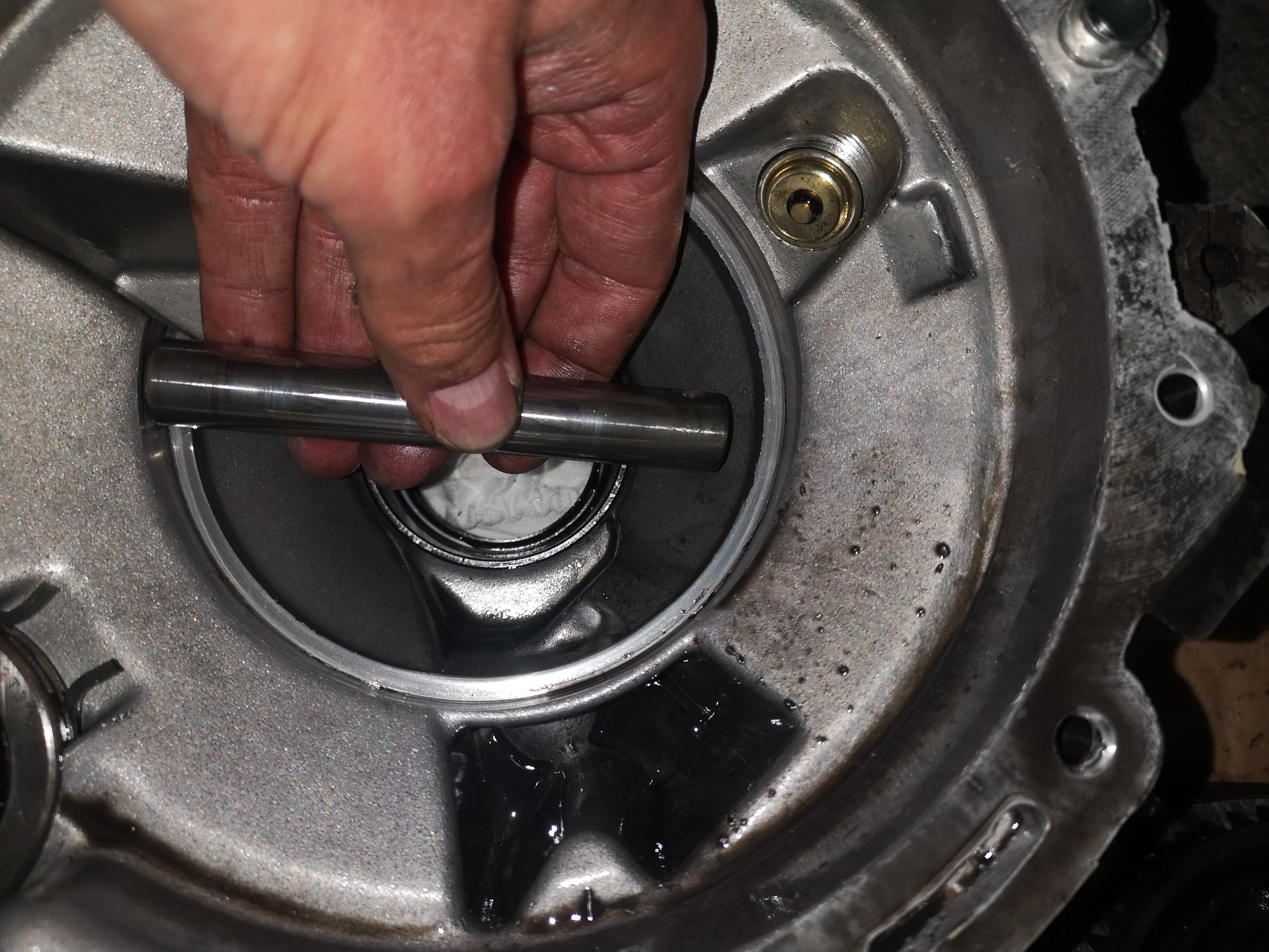

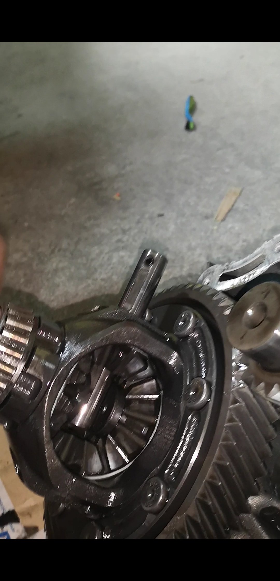

Safety pin which keeps the planetary shaft in place was broken. The planetary shaft protruded from the differential gears and was rubbing the casing untill it wore down and cracked.
Will check if can be welded.
Edited by pavinjo
