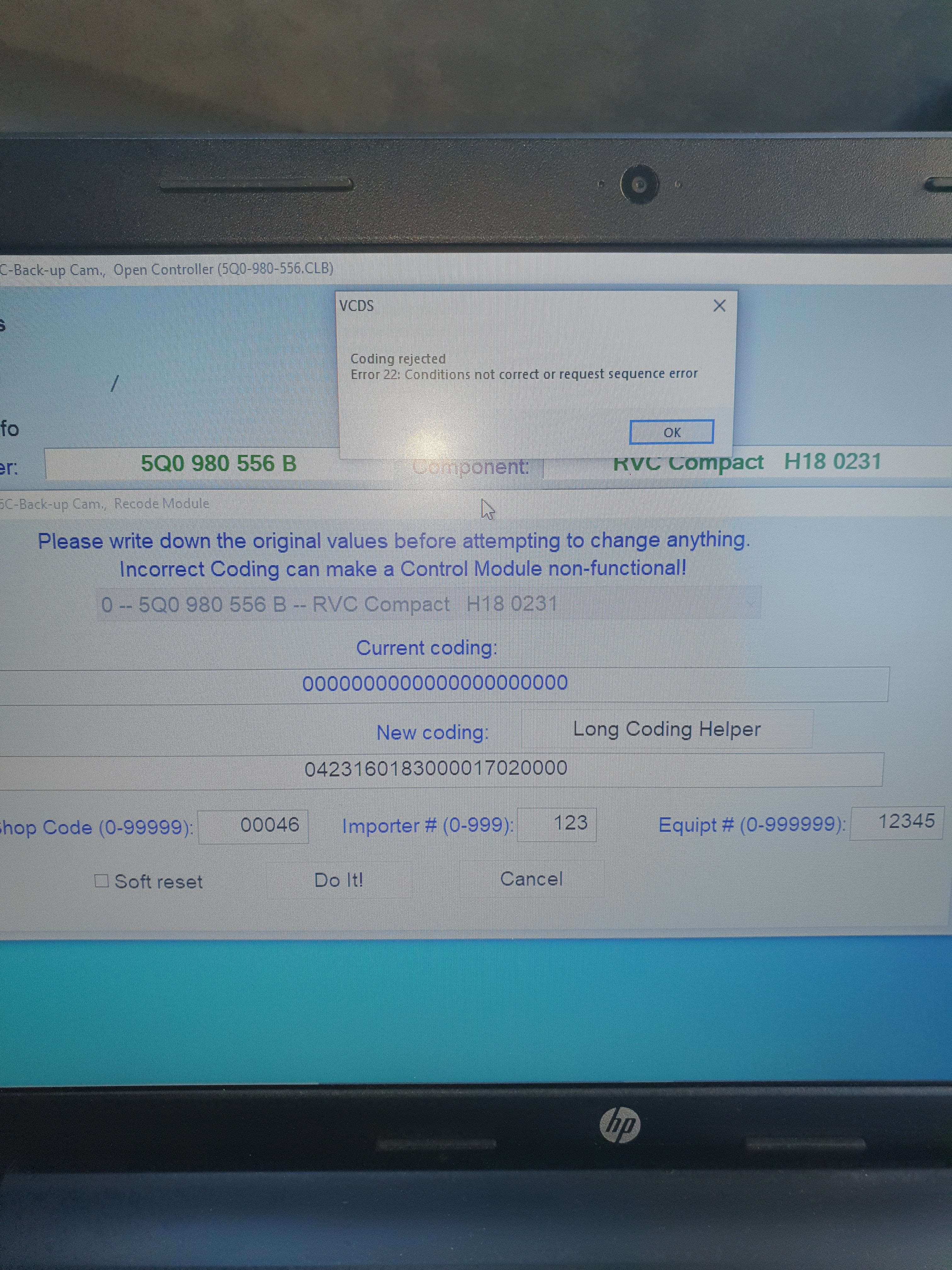

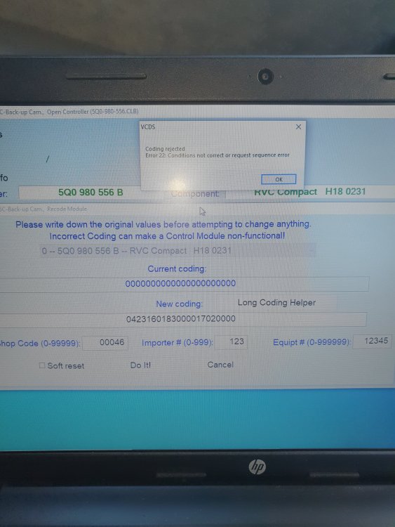

My new lead turned up a tried to code it and it wouldn't except a code.

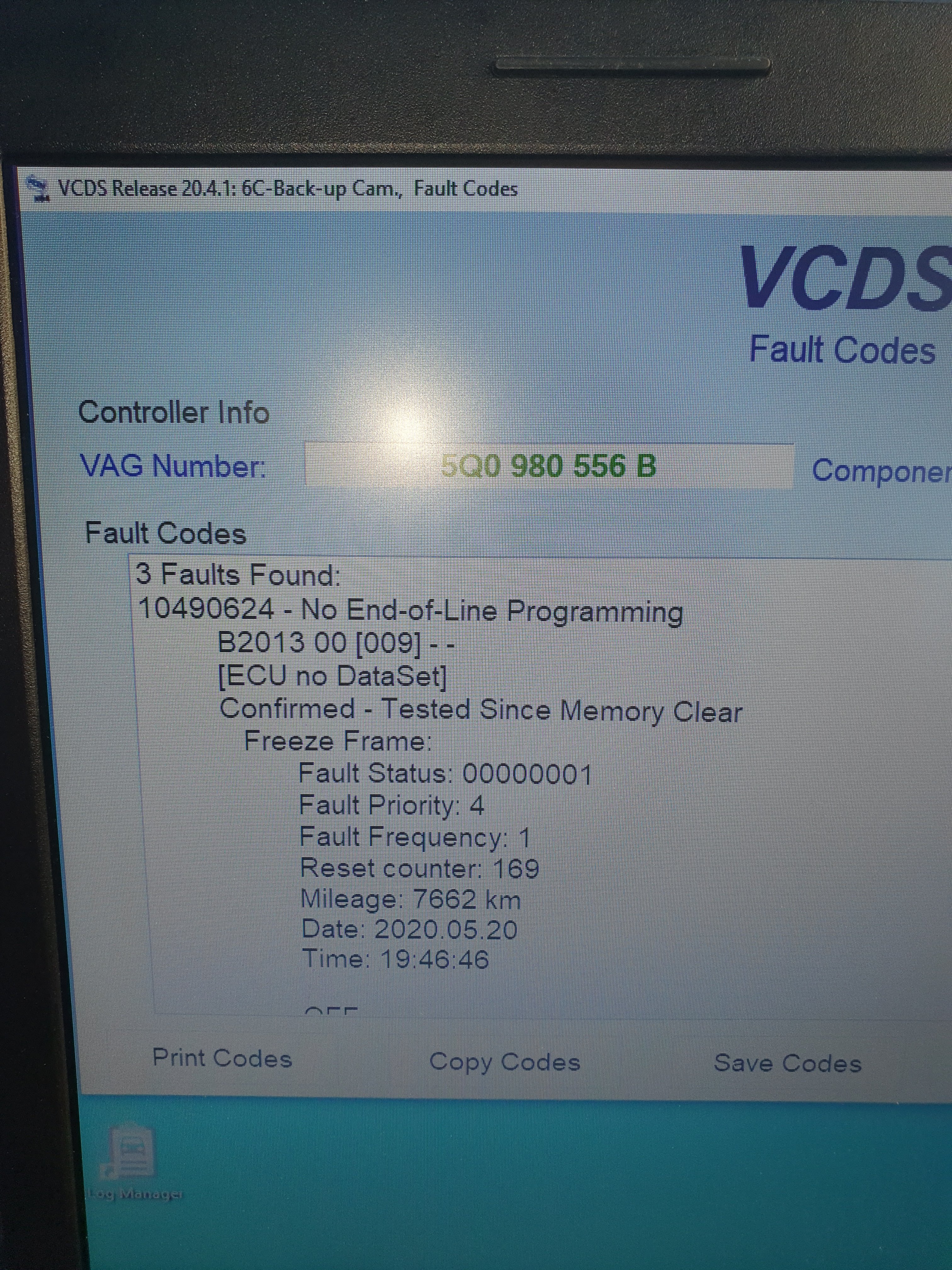

There is 3 faults in rear camera, 1 is control unit not coded, 1 is no basic setting carried out and the final is no end of line programming.
Theres a poc of me trying to code it
As a fully fledged paid-up Ross-Tech customer you should now be able to contact them directly to ask for assistance?
Hopefully they've seen this before...
Thanks for that info,
After posting a thread on the Ross-tech forum,l was told it can only be done at a dealer.
Spoke with my local dealer and there are going to sort it out in June
