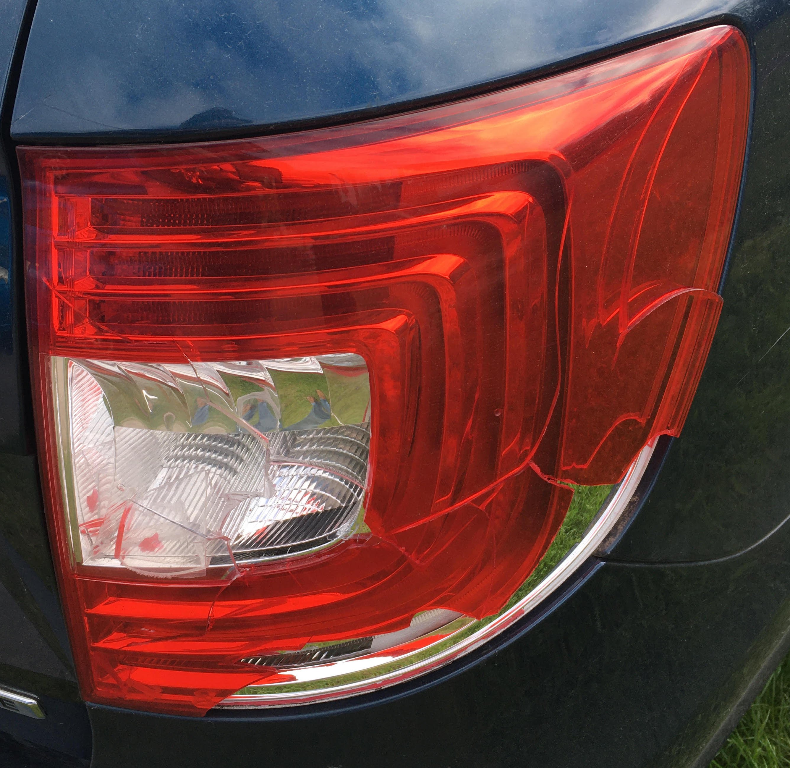

I have a Skoda superb estate greenline 1.4 TDI  (year 2014 and register in June 2014) and the rear RHS brake light is smashed requiring a replacement unit.   Can someone confirm the part no?

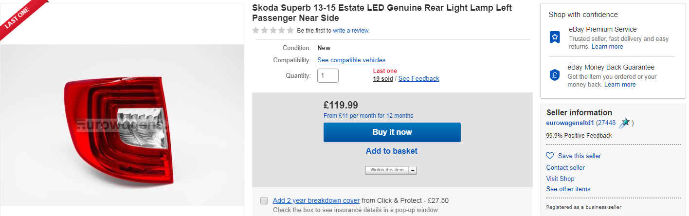

Thinks its 3t9945096 but I am not certain.  Also is ebay the best place to find a "bargain"

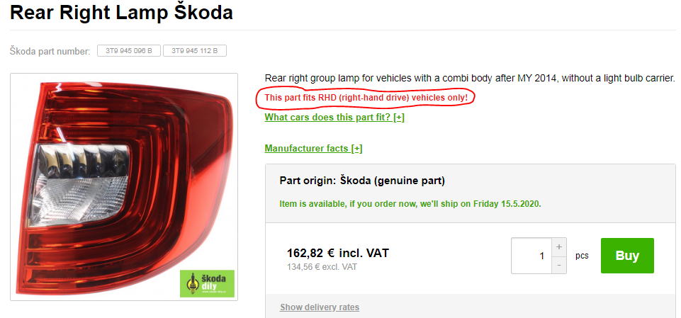

@xman sorry for late response.   I think the first option but not certain (damaged one pictured)
That's a MY2014> (facelift) rear light cluster with LED functionality.
You therefore need the style in xman's first link...
Make sure you source a unit suitable for RHD (Right Hand Drive) vehicles only, as the LED's for the rear fog light are on one side only i.e. if you buy the wrong part the fog light will be on the wrong side and won't work properly.
