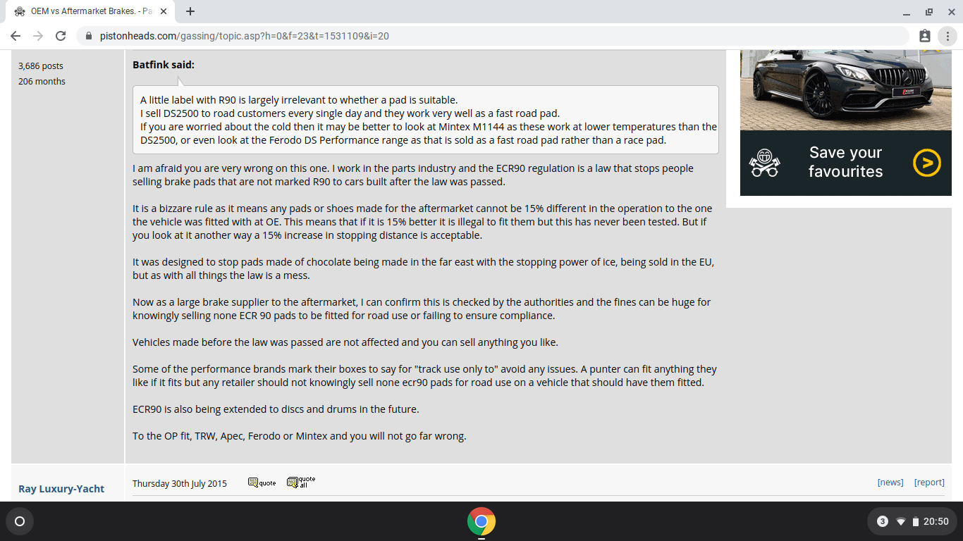

Cold braking exceeded the OEM pads (IMHO). I've read the regs stipulate that any brake components such as pads, discs, lining that are not OE have to perform within 15% (better or worse) of the standard equipment. Unfortunately brakes which are considerably better fall foul of the regs.

@DriverTom
I know all the speal and have driven a few cars with better performance pads that were crap on winter mornings.
It just does not cut it with a loss adjuster from an insurance company.
