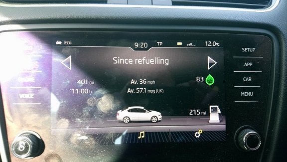

And my refuelling data - notice this hasn't reset.

Even allowing for a margin of error, that's outstanding mpg from any petrol engine let alone a 1.5 turbo.  57 over 400 miles - wow.

So I refuelled (with 200 indicated miles left in the tank).
404 miles driven with the car reporting 56.8mpg. Topped the tank up to second click (as usual) and it took 33.27 litres which makes it a real mpg of 55.2mpg which isn't a million miles away from the indicated (about 3% under).
Quite pleased with that - I tend to pootle along at 56-60mph on the 9 miles of dual carriageway on the way to work and back and there is 3 miles of town driving on the way in but either a fast ring road (6 miles) on the way back or back through town if I'm on a late and it is quiet.
