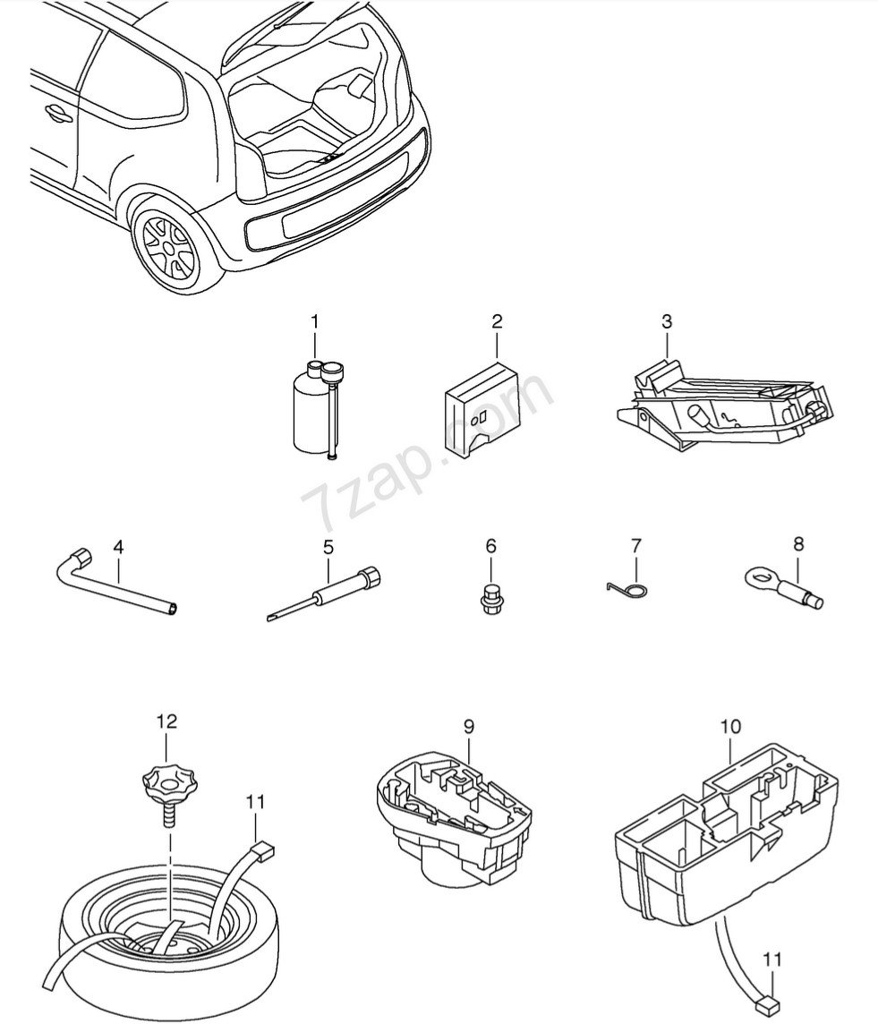

If we thinking about same part (no. 12 on the attached diagram) than vag part number is 6Q0803899A
That’s great, thanks. From the diagram I’ve also just realised we are missing the strap which is number 11 on the diagram. Do you know the part number for that strap too?

Part number for the strap would be 6H0867749

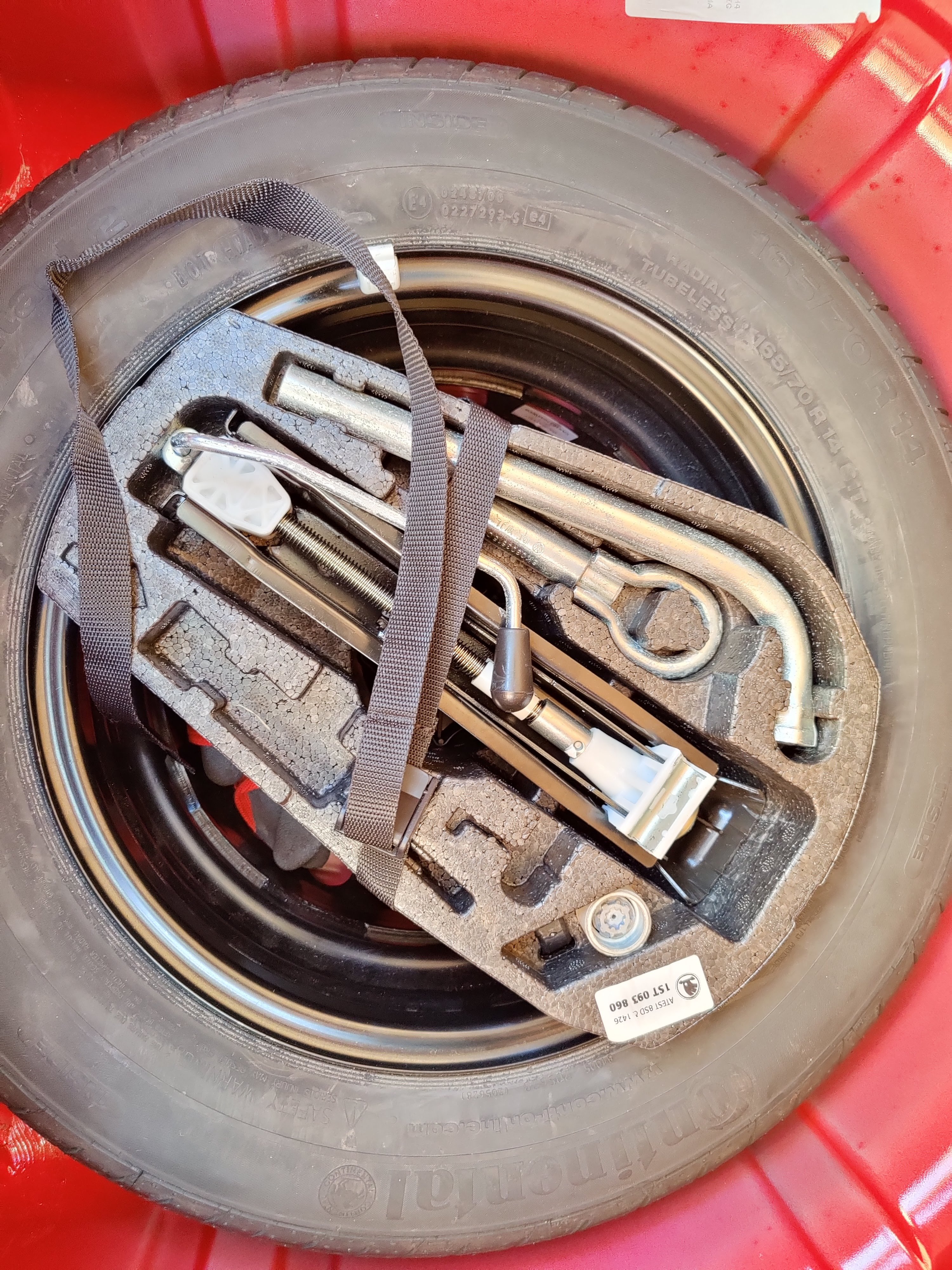

In my opinion, if you would use the securing bolt/screw there is no need for the strap. The strap is only there to hold the toolbox/polyesterene insert.
As above: The strap is indeed only there to hold the polystyrene insert in place inside the spare wheel- any sort of luggage strap would suffice, Unless you were buying the full tool kit insert which includes the strap and screw.

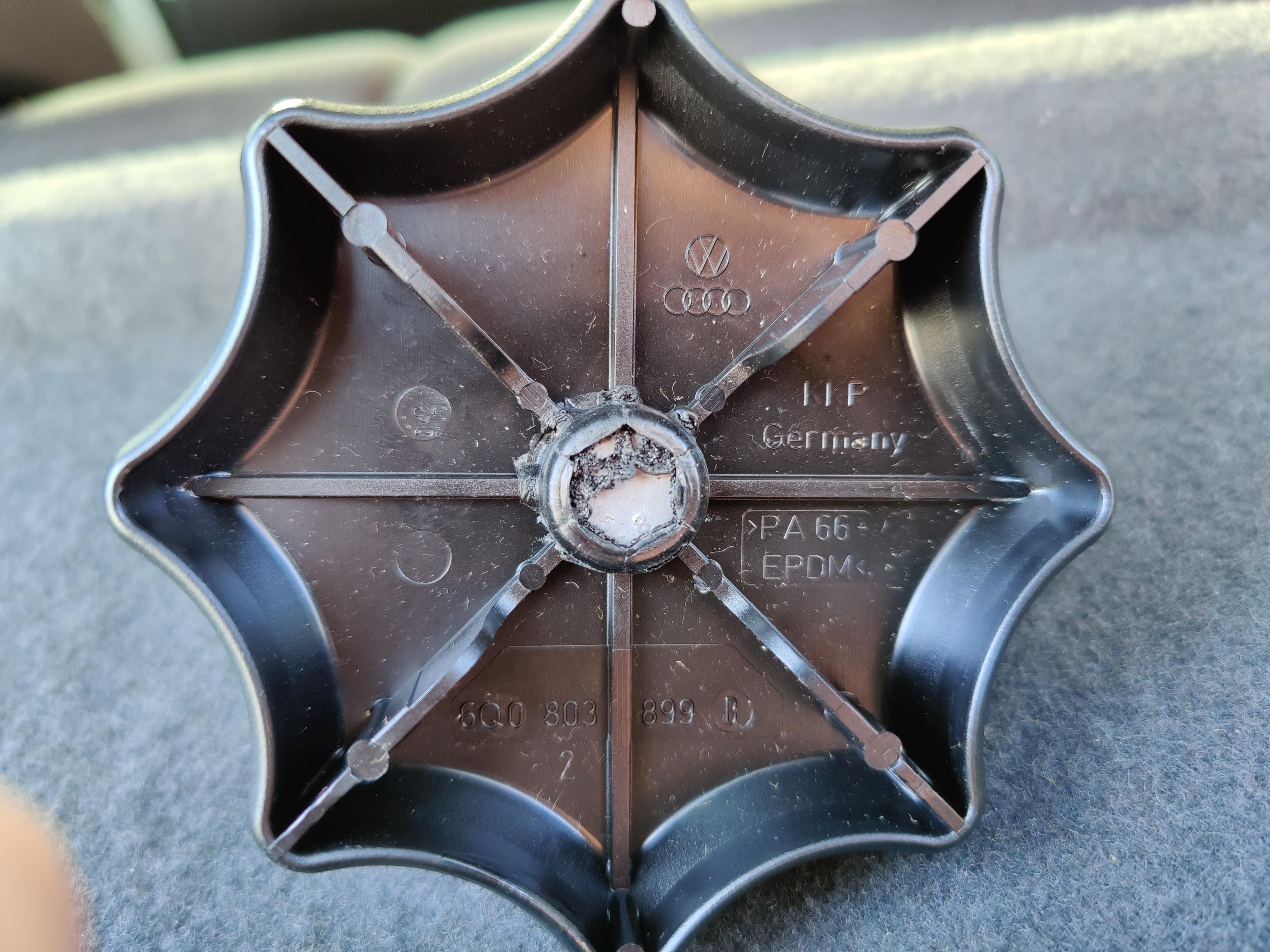

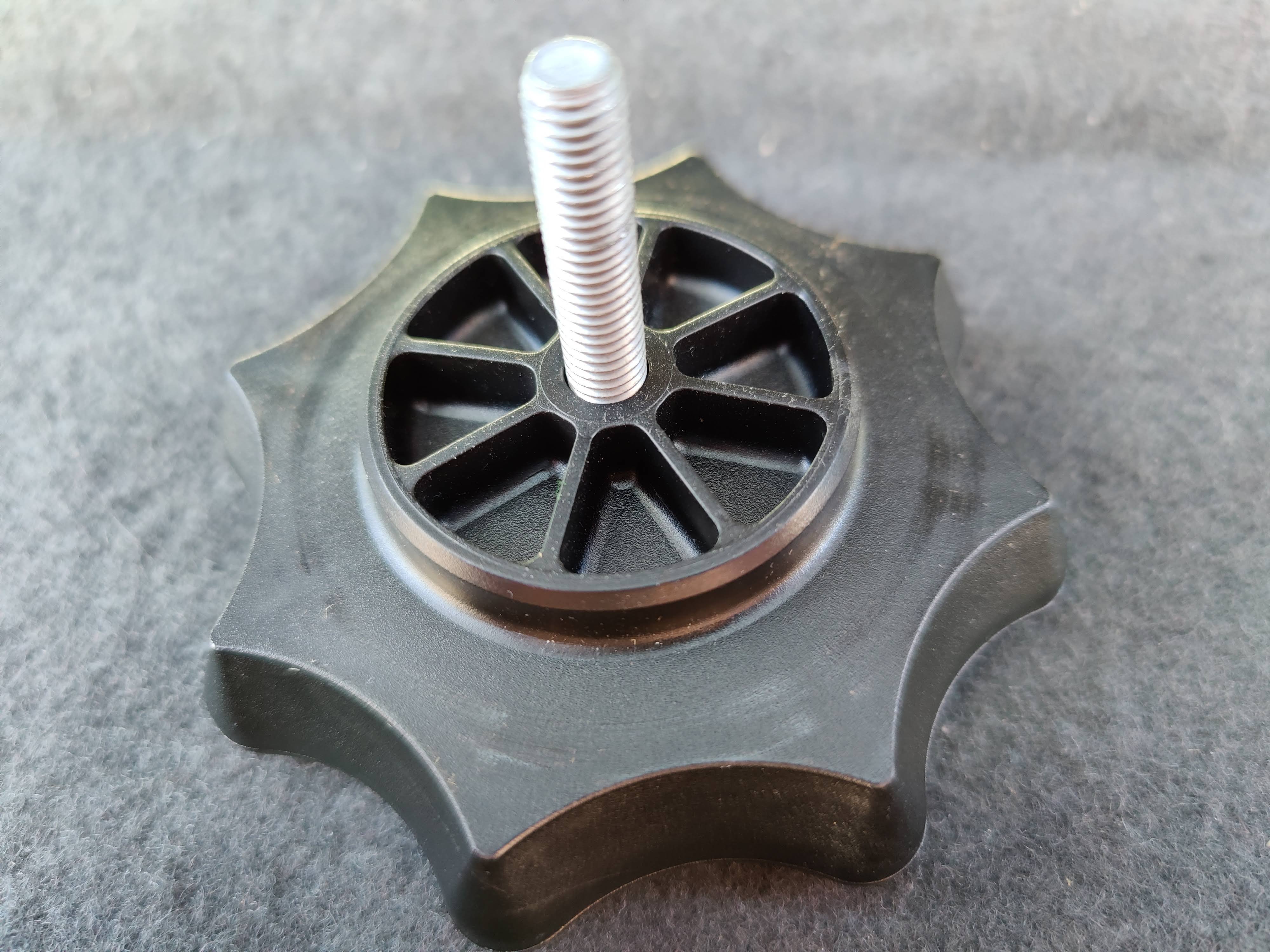

Re. the screw clamp - I think that a lot of VW/Audi models have a larger thread size. Here's some photos:
