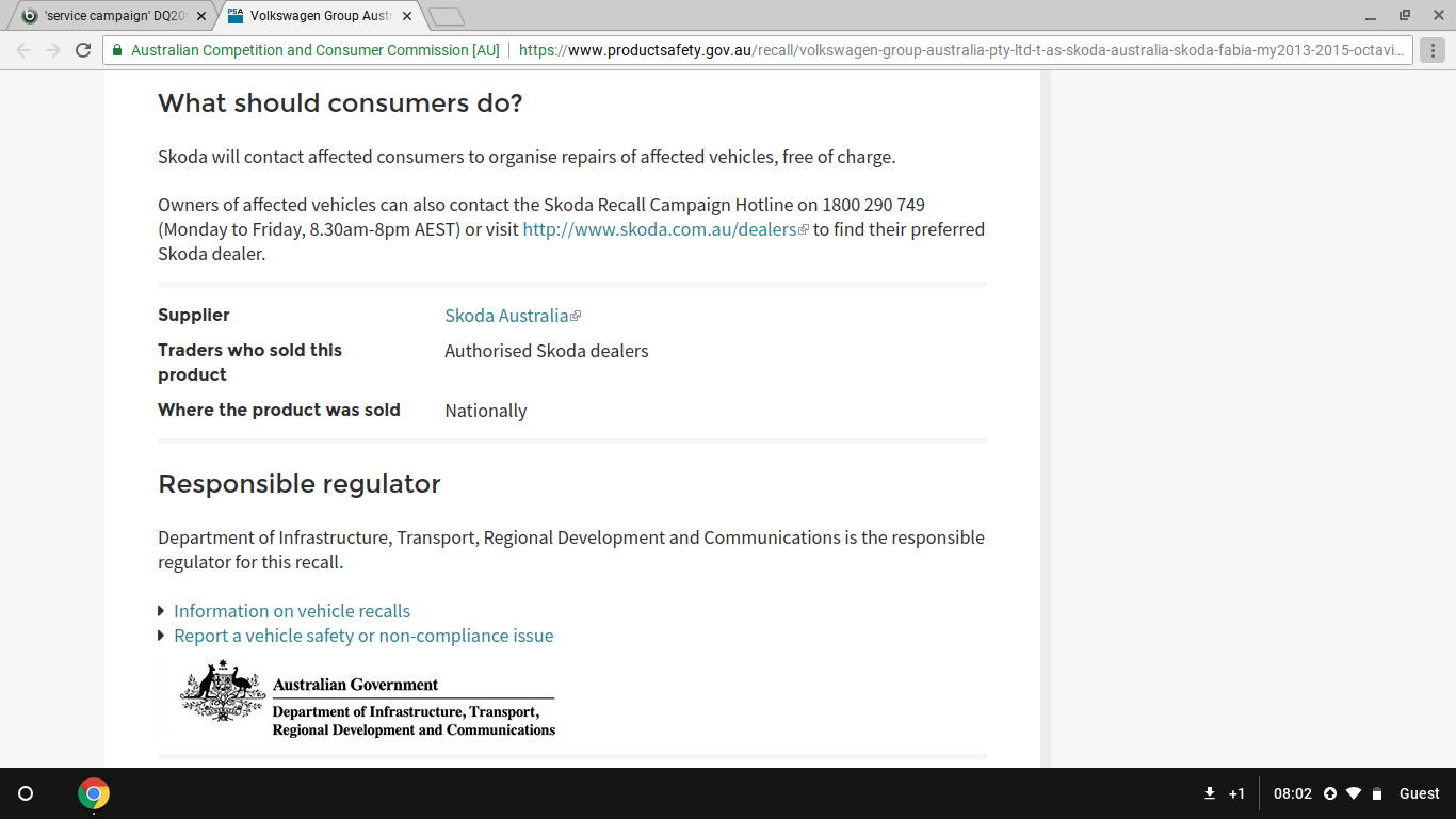

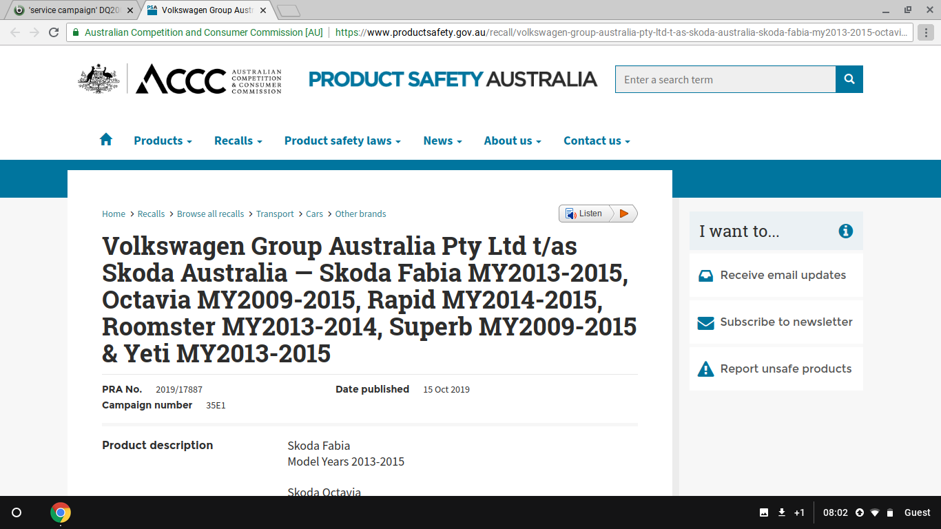

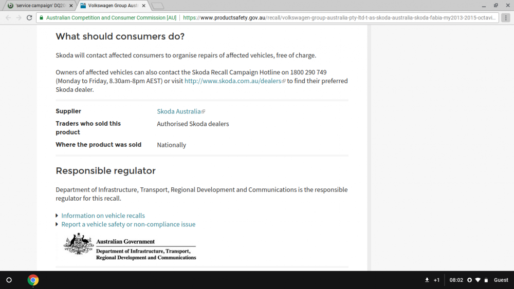

EDIT
From the link by @OzFabia  Your car might not be in the latest Recall.
But still a KNOWN ISSUE.
