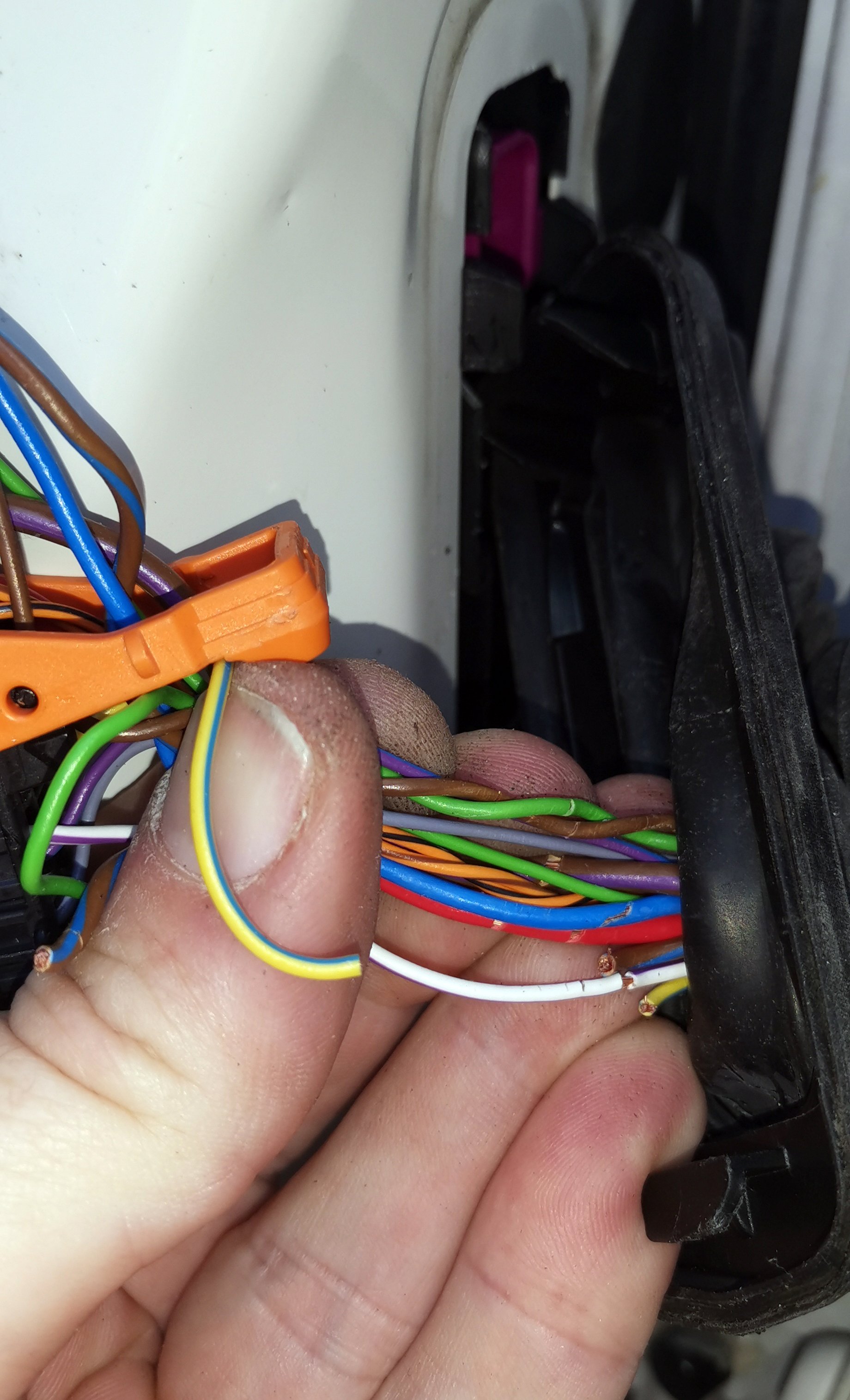

Hi @DrCorbyLee  the fault definitely lies within rubber gator. in fact there are several broken wires and nearly all of them have damaged / cracked insulation exposing the copper wires. See attached photo. Certainly not going to be able to fix that with some inline crimps and insulating tape ☹️. Looks like I will also be having to get the wiring loom replaced as well. Would be interested to know what they have quoted you for replacing the wiring loom? but understand if you down want to post it here.   but thanks for pointing me in the right direction - much appreciated 🙂
No problem with pointing you in the right direction, it's only thanks to the forum that I knew what the problem was when it happened to me so happy to pass on the group knowledge.
The multiple damaged wires certainly ties in with other's experience, I suspect mine is similar but never managed to disconnect the gator (hands like shovels!).  You'd never notice if say the wire to the tweeter by door handle had failed or the likely intermittent connections you are getting to other switches etc in the door,, it's only when something obvious fails continuously like central locking or, in our case, main speaker that you realise there is an issue.  I thought I'd gone deaf in one ear when it happened  when I closed the door at start of 3-1/2 hour drive up from London!

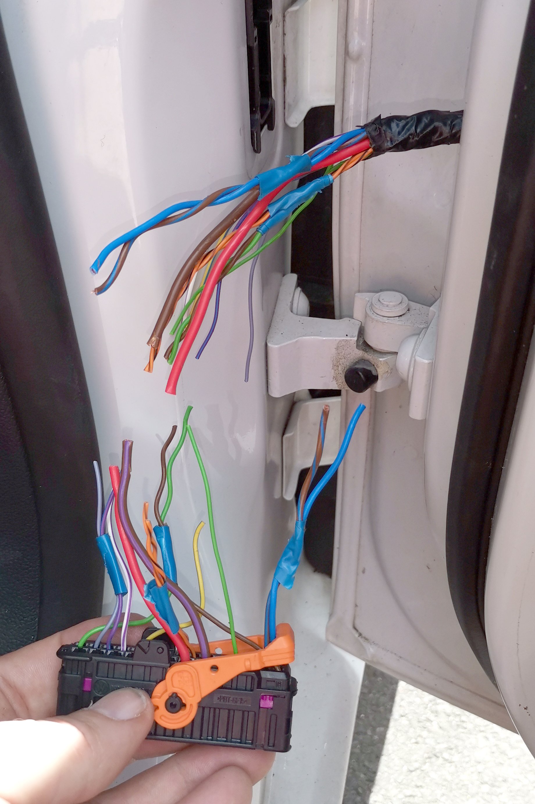

If you have the door card off and connector unclipped your as well getting a wee soldering iron , lengths of wire the correct guage and shrinkwrap and doing the job properly yourself
Your over half way there already.
Just cut out old wire and replace with slightly longer wire to stop problem happening again.
Take you half an hour from there👍
Thanks everyone, having read all the comments I have decided to take the leap of faith and having found enough slack on the door loom to allow the connector to prodrude enough to comfortably work on, I have cut the connector off and will attempt to solder in a an extra length of  (6-8inches) of wires and heat shrink them for mechanical protection. Off  now to get some wire and heat shrink.. 🙂
