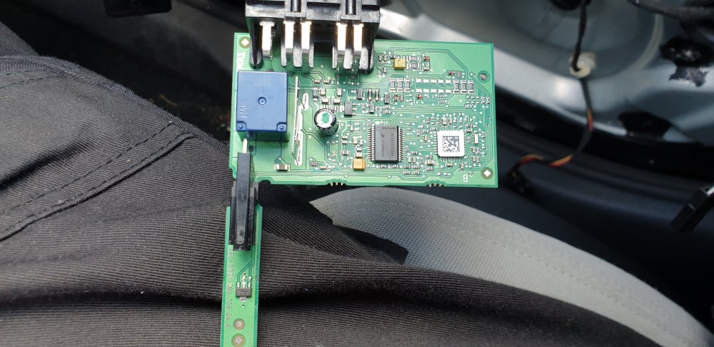

Heard about the PCB faults on the board in the regulator (drivers window motor). Replaced the Relay and capacitor.  £10.00 Again nothing.
Bought secondhand Drivers side motor £48 after checking to get exact match for Software and hardware numbers.
Received new window motor, worked immediately Bingo!!  Then tested passenger window using both switches  drivers and passenger door - nothing.
Unplugged - replugged.  Turn ignition off on.  Then tried passenger window switch worked.
So now everything working perfectly.  Except turns out the motor I bought even though I bought from a UK seller for a UK car was back to front!! Presume from a LHD European car.
No worries, decided to use the Circuit Board from purchased Motor in my old Motor.

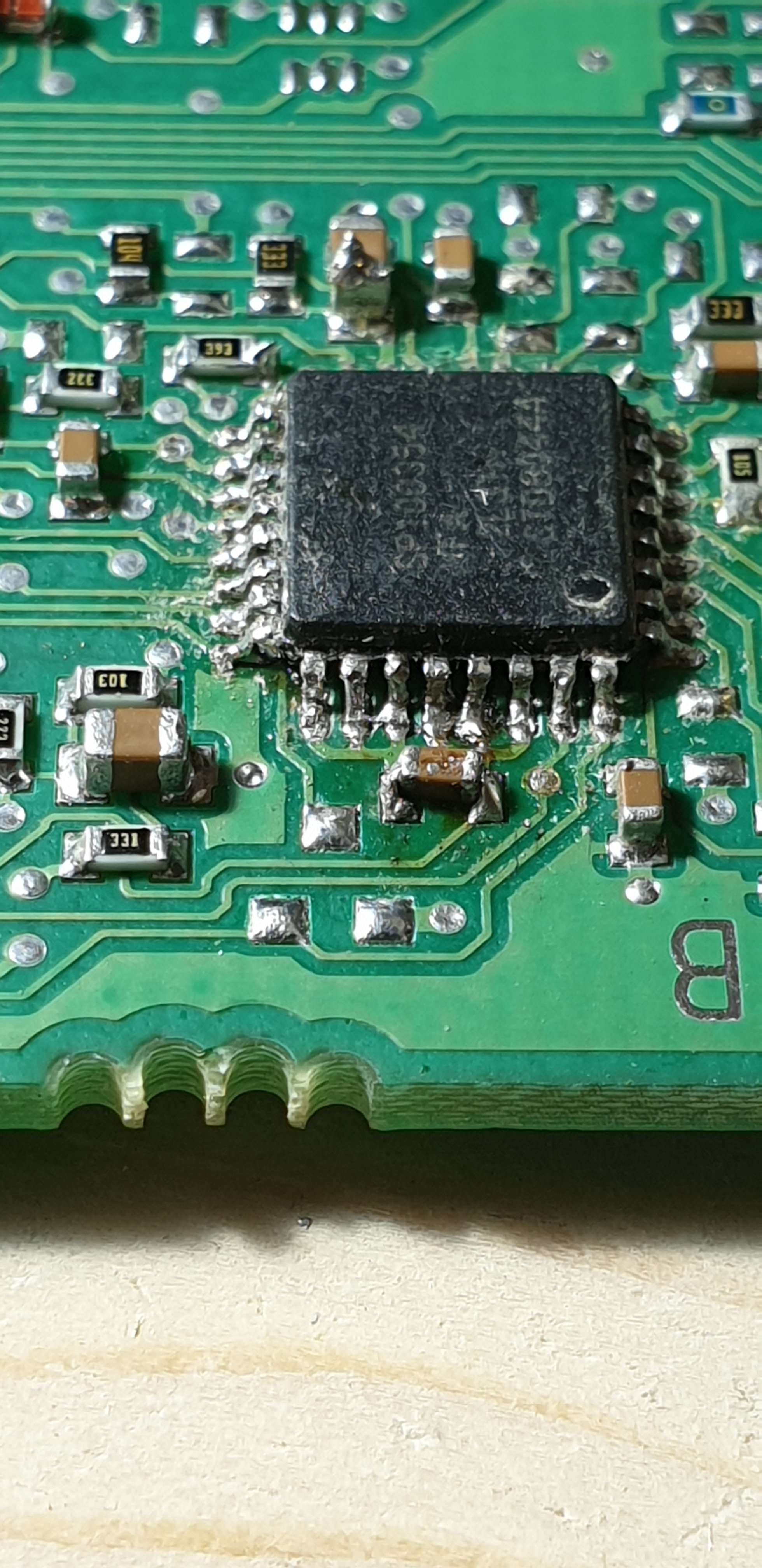

Thought I maybe had a faulty connection. Checked all wiring. No issues there. Checked the LIN wire from the drivers door motor (with a PICO scope) and found that the LIN wire didn't have a LIN signal when the windows were not working.
Then I stumbled across this video..
https://m.youtube.com/watch?v=ZlExAJYp2x4
I didn't have a heat gun to try this. I was, however, certain that the motor (PCB) was faulty and needed to be replaced. TPS  wanted £169 ex vat for new motor . Local Skoda dealer offered a discounted price of £169 including VAT.
I decided to resolder the small chip with the QR code sticker on top, as I thought there could be a dry  joint between the chip contact pins and the board.Not easy to do...but figured it was worth a go. It worked. Windows have been fine now for 3 weeks.
I dont advise buying a used motor as it's pure luck if you get one with the correct software/coding. Also,  the coding / full part numbers are not shown on the motors.
Warning.. obviously only attempt this if you are reasonable good with a soldering iron and were about to buy a new motor anyway. This is a last resort attempt at a fix. It worked for me.

I changed the Relay on the Regulator Motor PCB, I changed the capacitor On the same board.  I reworked LIN Network Chip and the Other Large chip on the same board. Nothing....

In summary - in my case - the fault was with the PCB board on the window regulator.  It seems to be something with the ignition power on the board.

Glad you managed to get it fixed. I had the same issue with the windows still working after the ignition was switched off. Removing the old solder (with a solder suction pump) and resoldering the LIN chip resolved this. I took a couple of attempts at resoldering the chip to get it working.
Windows still working. Hope it lasts.
