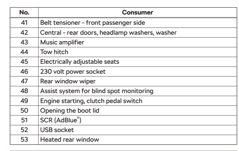

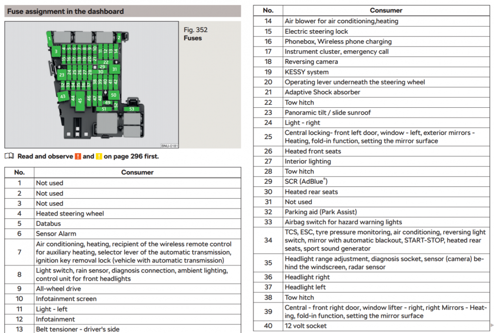

Does anyone know what fuses are contant, ignition only and acc on the O3 FL (MY19)?

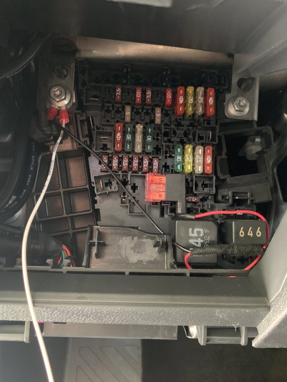

I'm having trouble finding a fuse i can tap into for my rearseat USB plugs (OEM USB hub).
I was hoping that i could have used fuse 10, since i know my radio turns ofter some time, but to my suprise that was handled by the radio itself and not by any switch since the USB plugs were still charging after 2 hours.
Currently i have two taps plugged in, one for the inbay QI charger which works as inteded and then the USB hub for rear passengers/quicker charge that i can't find a suitable place for.
I'm just looking for one that turns off with the ignition or atleast after a period of time (acc), but i can for the love of god not find any and hoping someone maybe knew more :).
