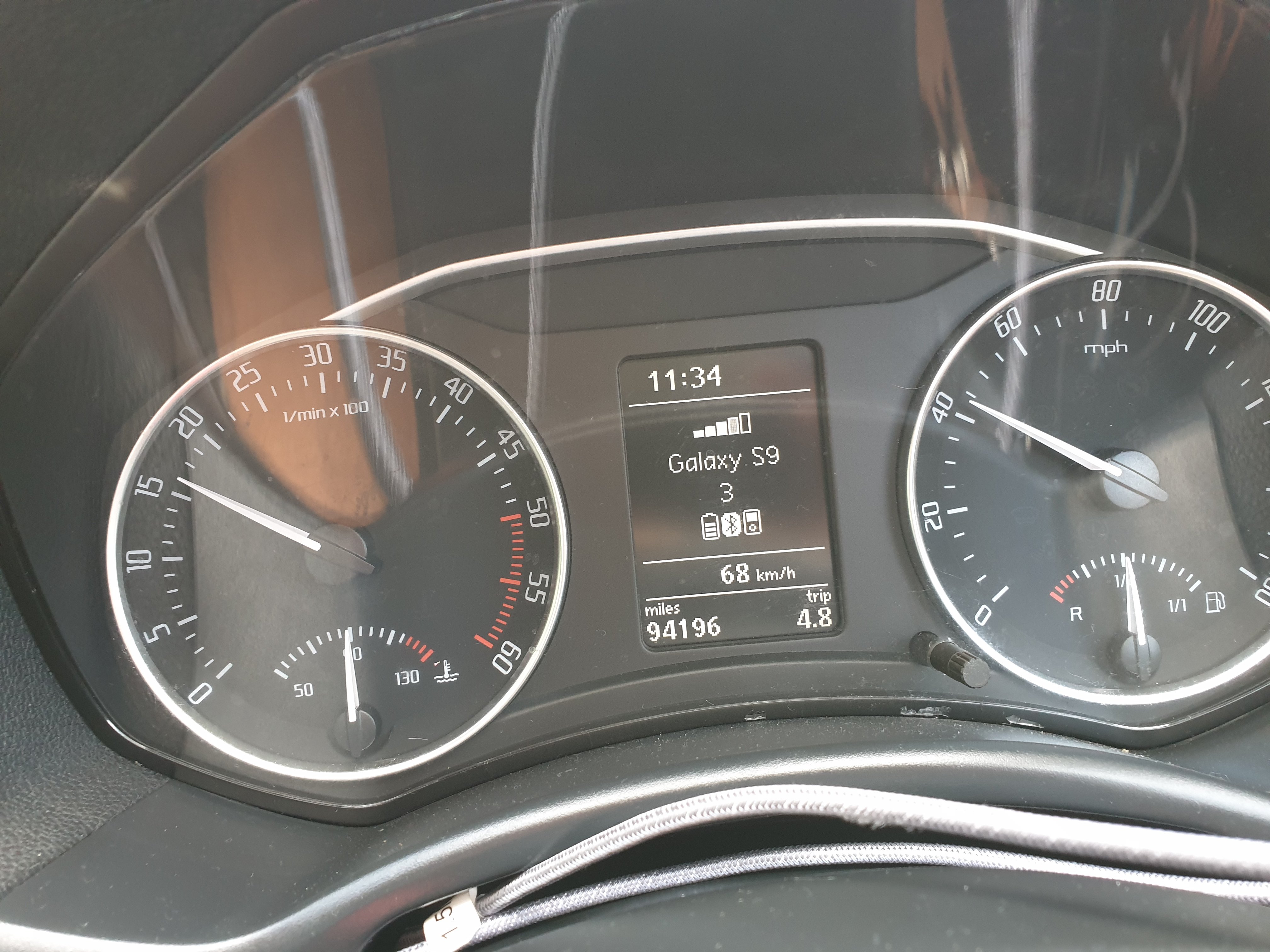

Hi Everyone,
I am new to the Skoda family and have just bought a Octavia 1.6 TDI CR SE  on a 61 plate and have a question to ask of the knowledgeable on this Forum, my car doesn't have the buttons on the windscreen stalk but can you still get things like average fuel consumption as at this moment I just get the speed in KPH and just another quick one can you change the clock to 12 hr instead of 24 hr.

morning, given you  have your phone on the bluetooth in pic, i presume you have a multifunction steering wheel?

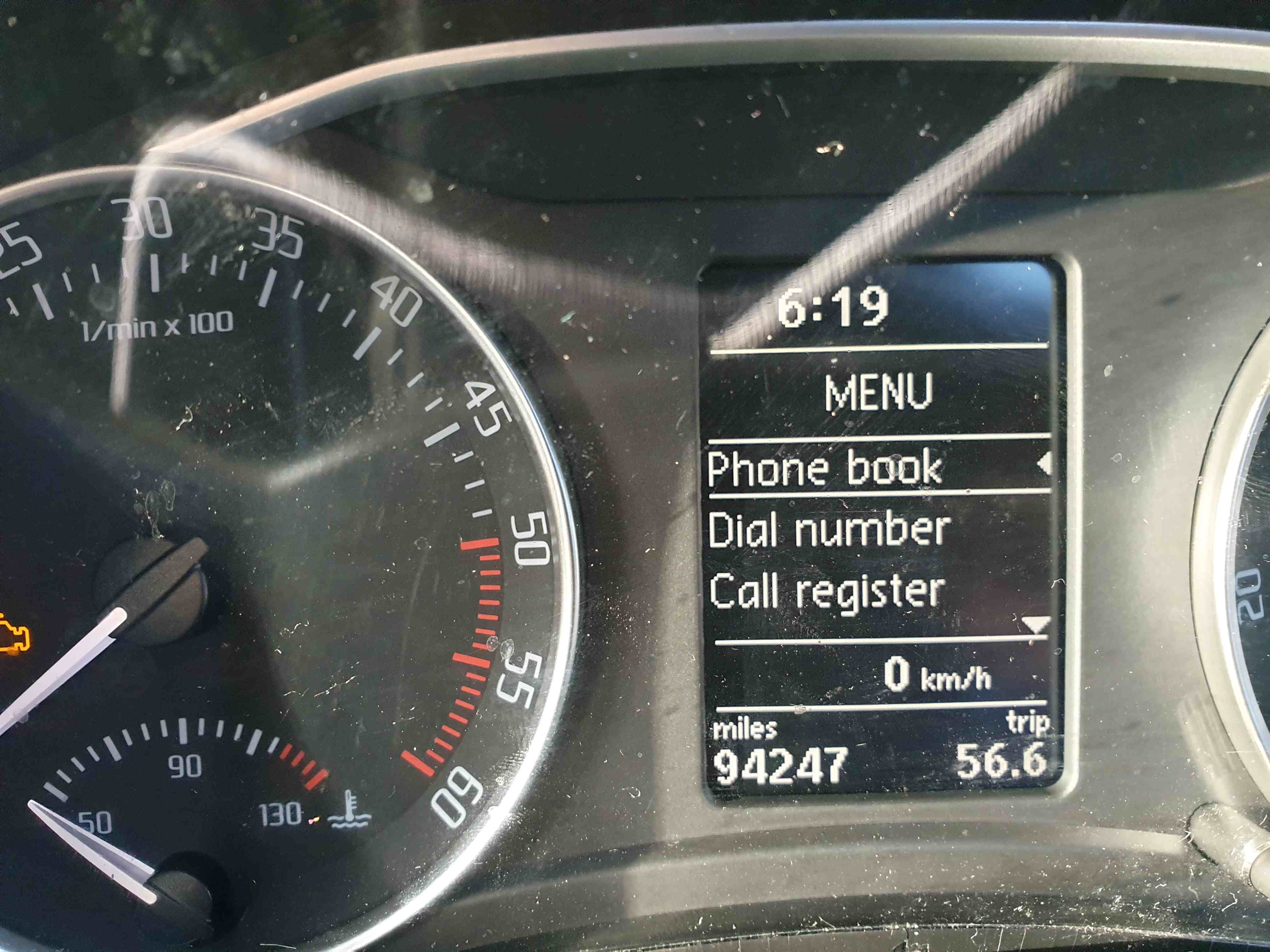

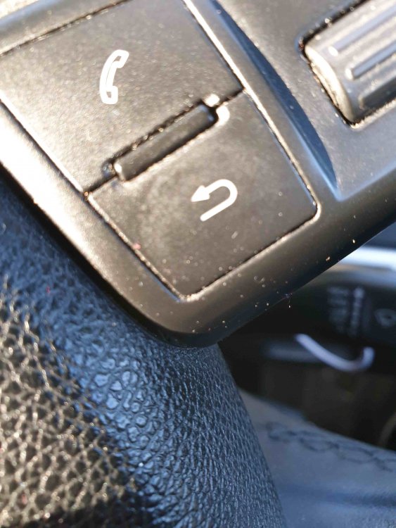

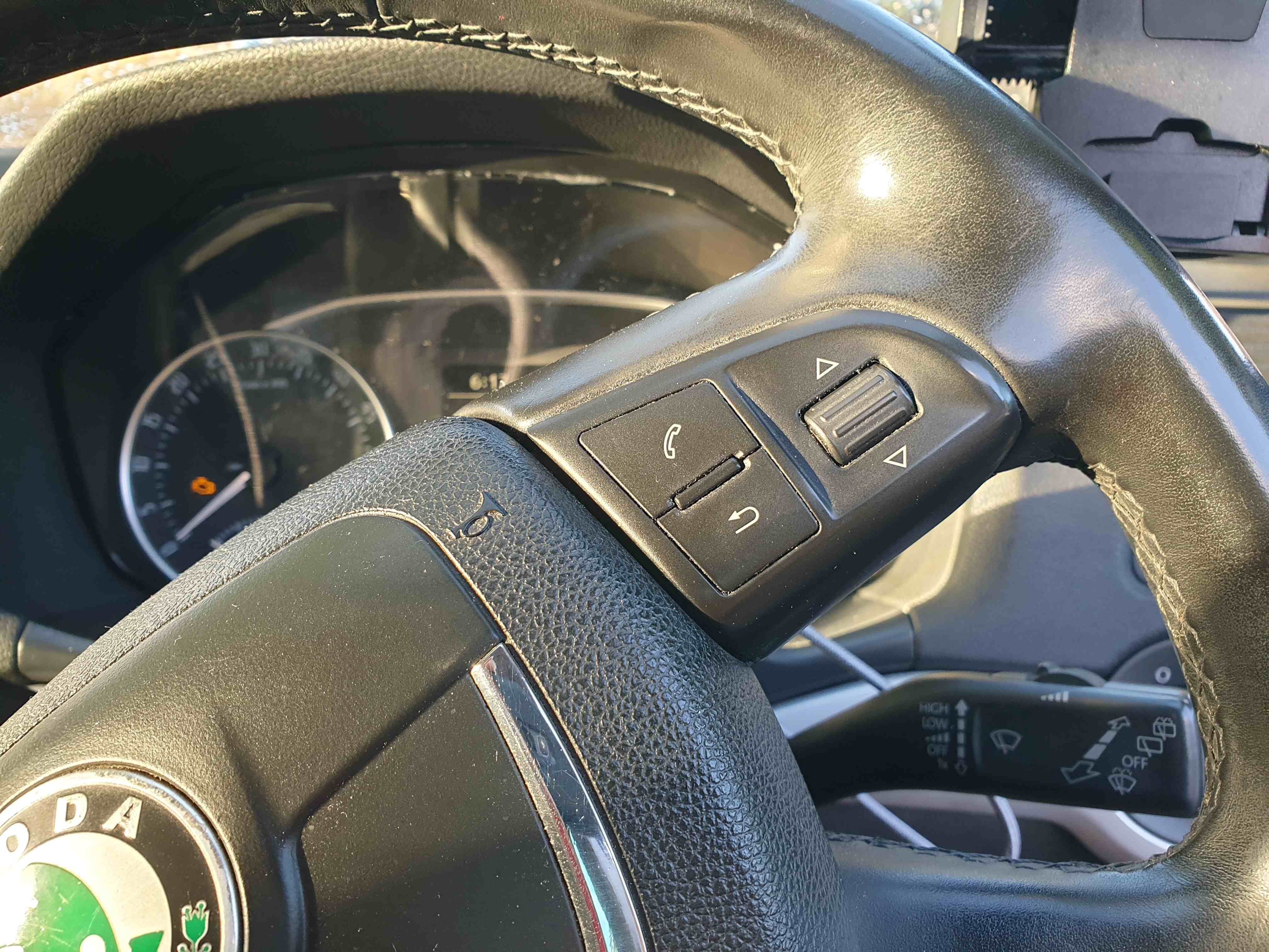

Hi Mac11irl,
Thanks for the prompt reply, and yes it has a multi function wheel and the only thing I can find relates to the phone here is a few more pics, does the car need to be either running or be driven to change the settings please, and a video would be great.

need to have ignition on, or engine running to activate the steering wheel functions.
the "first click" for the radio isnt enough.
the arrow button will then bring you back out to the main menu.

Yes I have tried it with the ignition on, engine running and whilst driving and still nothing except the phone menu, I have tried holding the button and return down (not at the same time though) for 10+ seconds nothing, I think that is what it tells you to do in the manual, I think I have tried every combination over the last couple of days that is why I was hoping there is some little trick I am missing or could it be that the module isn't working , I was hoping that someone can confirm that the model I have (Octavia 1.6 TDI CR SE) or all models of Octavia indeed has this function.

can you work your way the phone menu? go into the phone book and come back out etc?
Yes I can get in to the phone book and back out off, that is the only menu I can access that's why I was asking if a Octavia's have this feature or it's my car that either doesn't have it or it's not working, I have 1 months warranty with the car and would like to get it sorted.

I think the wrong steering control module can cause back button issues?
If you have a satnav, setting a destination should cause the maxidot to show the driving instructions. You can then hit back to get to the main settings. You'll still probably get stuck if you enter the phone menu though...
Unplugging the Bluetooth module should also let you get to the settings. It's probably under one of the front seats.
