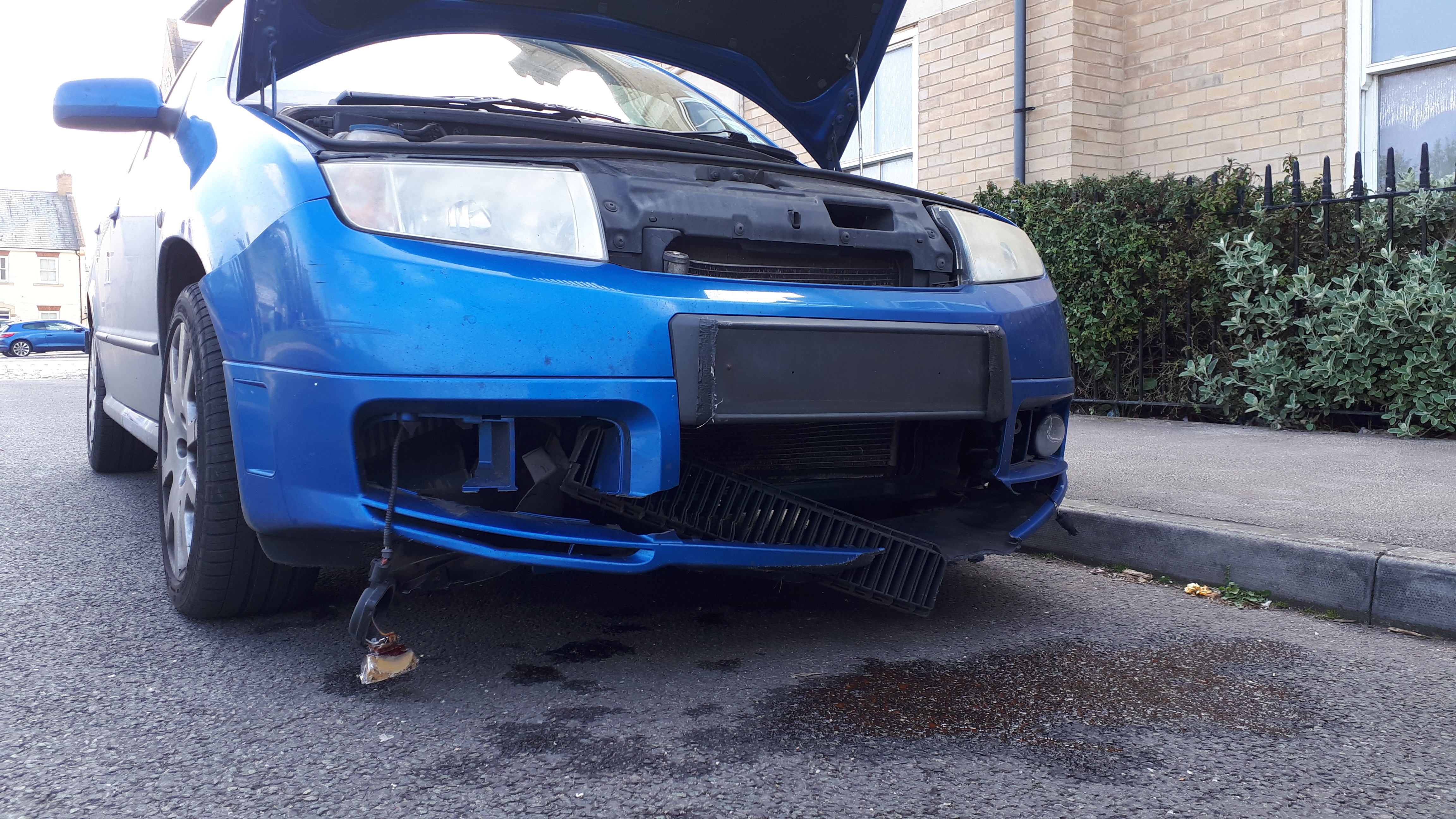

Morning fellow Briskies!
Apologies for hijacking this thread (Mods: Please move if wrongly posted), but would appreciate your thoughts:
Bambi did this (see image) to my Fabia VRS but came off worse.  I managed to make the 4 mile journey back home although both coolant rad and air con condenser have been ruptured as well as the damaged bodywork, number plate and fogs.  Can't be arsed to go thru insurance as they write it off, plus I have lockdown time on my hands to sort.  I've already taken the bumper and top panel off, but a few queries:
1)  Can I safely disconnect the refrigerant lines without blowing myself up and do I need any special tools?  (Haynes manual recommends anything to do with disconnecting the condenser should be done  dealer or specialist).  Note: The aircon hasn't worked for at least a couple of years before the deer-strike.
2)  Could I have damaged the air con compressor since I've been driving the 2 years or so without the air con working?
3)  I have a new rad, condenser, bumper etc. on order - do you recommend I also order a drier (looks like a sink waste bottle trap).
4)  My plan is to remove the rad and condenser when the new parts arrive, refit, replace coolant and then drive the vehicle for re-gassing.
5)  Alternatively, any thoughts on further butchering what's left of the bumper and fitting a FMIC with hard pipework?  (I've done the 're-attaching the stock boost pipes' a couple of times a while back).  If so, any perceived issues with mounting said FMIC in front of the new condenser?
Thanks in advance for any help/suggestions/comments etc.
Robstaaaar
1: if the condenser has been ruptured all the gas would of escaped anyway, the Haynes manual says take to specialist as the refrigerant needs to be recovered and not just released into the atmosphere as it damages the ozone, if your sure the condenser is ruptured then I personally would just start to dismantle and replace the busted parts of the system, maybe try not to sniff the open pipework 🤣 as there will still be traces of gas in there as you haven’t had the system under vacuum.
I would plug the car in and see why the AC hasn’t worked though just incase it isn’t a usually case of being low on gas.
2: I’d assume you’d be ok, as long as it’s had oil in it and moisture hasn’t got to the internals, you won’t be the first or last car that hasn’t had ac working for a while due to low gas in the system.
3: I’ve always been under the impression that a new dryer is needed when ever the system has been opened to the elements, but in the second breath a vacuum test put onto the system should also remove any moisture in the system, so it conflicts itself, regardless I would probably fit one, as iirc they also have a filter in them, just let the bloke filling the ac know you’ve replaced the condenser and dryer to account for any oil lost as per our previous discussion in this thread.
4: sounds perfectly normal to me
5: there won’t be any detrimental effect with mounting the FMIC in front of the AC condenser, and I’m sure a lot of manufacturers already do this.
best of luck getting it all back and looking spot on again 👍
