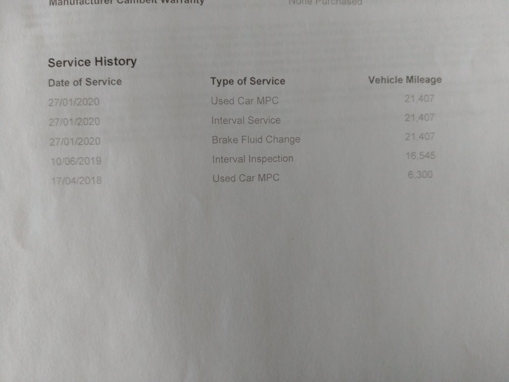

It had the attached services as per the history certificate from Skoda - I would hope they used the recommended oil.
OK, so possible first oil change at 16,545 miles which is not unusual if on Variable Servicing.
(Maybe nothing at 6,300 done.)
Is there an Invoice from 27/1/2020 showing what oil was used?
I would also hope they used the correct oil.
If i had a noisy 1.0 TSI or a keeper i would used the Oil that can be used for Fixed Servicing and go VW 502 so 5w 40 FS.
& do fixed servicing intervals. 9,400 miles / 372 days, which ever comes soonest.

I don't have the ivoice for that, previous owner was leasing it from Skoda- that is where all the service history is from. Before I purchased it they did an oil change and I will keep your suggested interval- it's the same I think as Skoda recommends.
