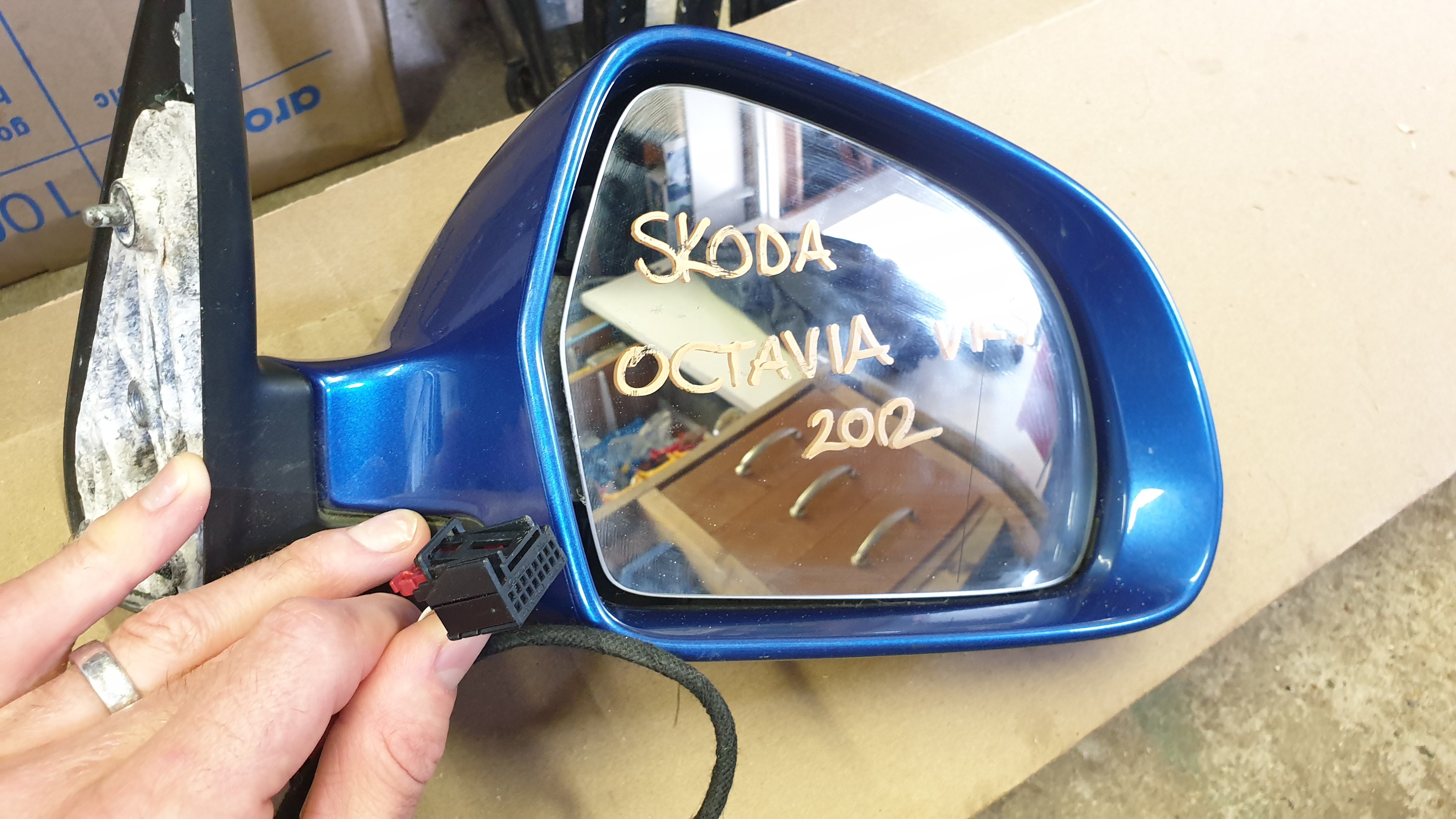

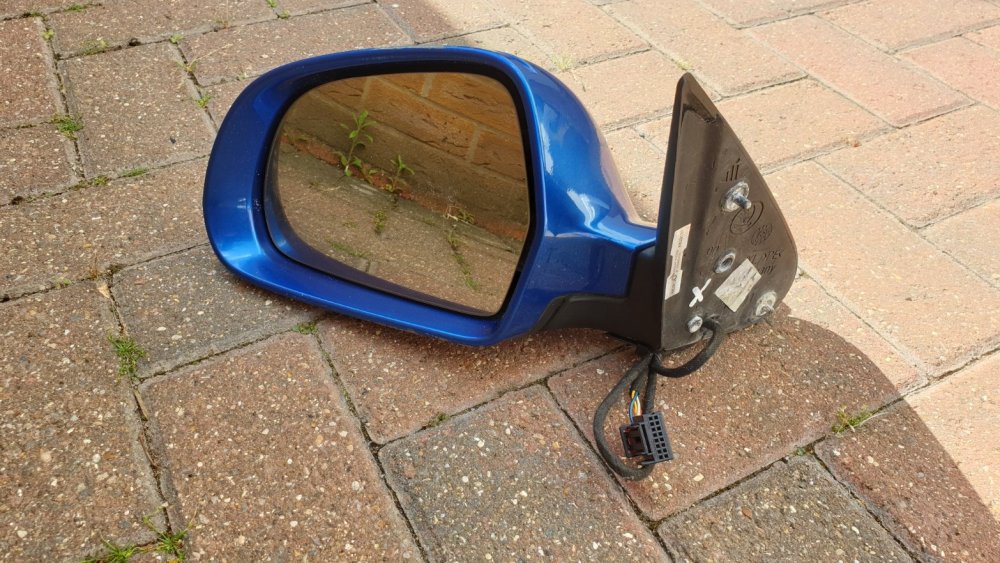

I've just bought a pair of facelift mirrors, to swap for my pre-facelift, and found that the connectors are different too.  Both my sets are vRS spec - non-folding, non-memory.
I have only compared the passenger side and like you said the pre-facelift mirror has 7 wires (versus 6 on the facelift).  However, if you look carefully two wires are connected to the same pin (black and brown = ground), thus effectively only 6 wires.

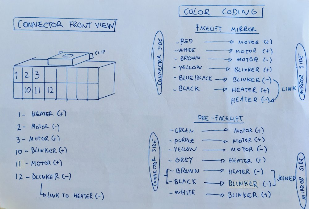

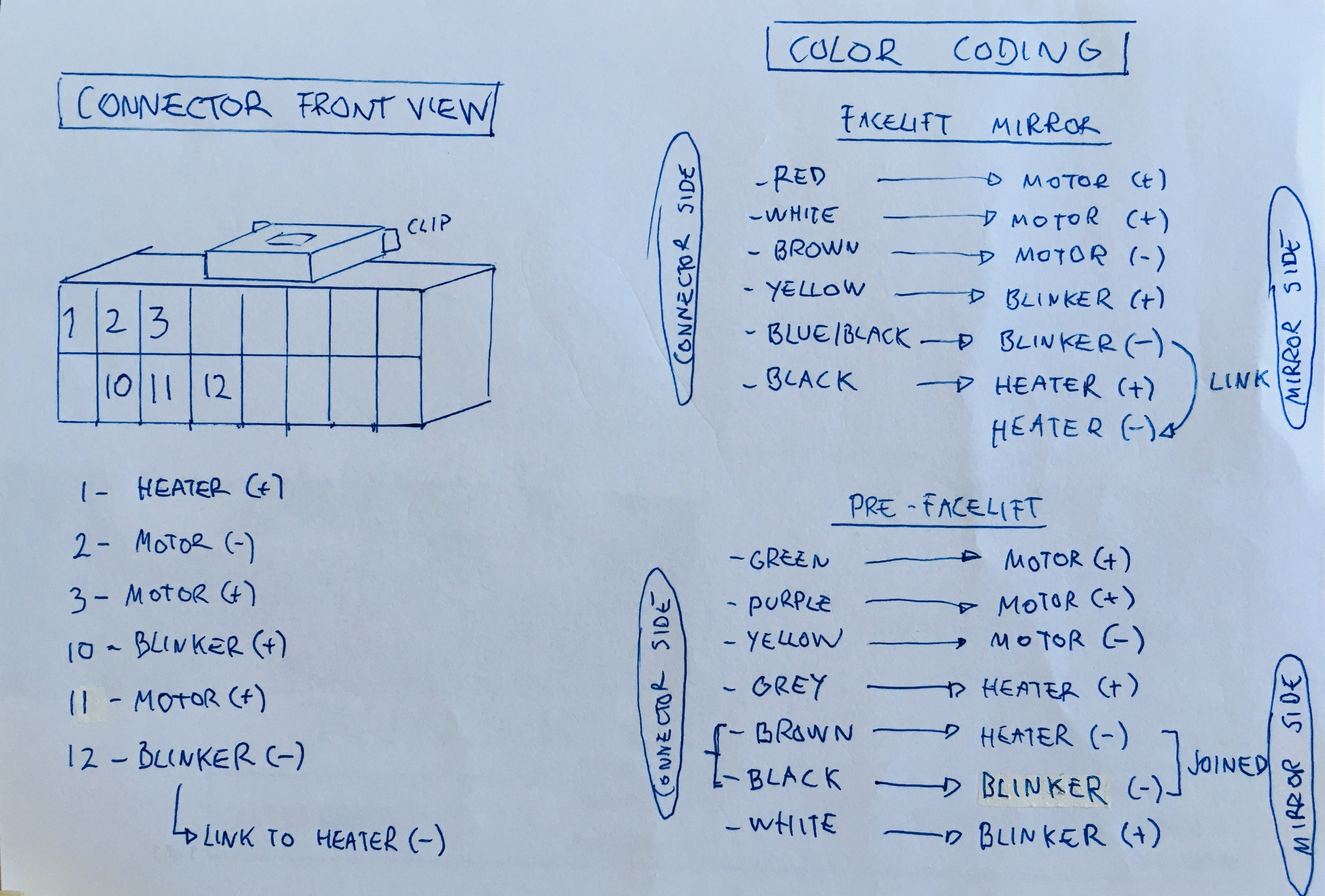

I just finished the installation this evening. I’m drawing the wire diagram/pin functions. But long story short, pre-facelift mirrors have 7 cables although 2 of them (grounds for heating and blinker  ) go into the same pin. So actually, 6 pins are used in the connector. And in facelift mirrors, 6 cables are used (and 6 pins) but the ground is cable is divided into 2 inside the mirror housing (one end to blinker ground and the other to heating ground).
Let me a couple days and I’ll draw the sketch into a clean diagram and I’ll post it here. My english might be confusing in the explanation above!

Would be very grateful for a diagram. I assume they are electrically the same then, just with different connectors? That's good to hear.
In that case I'm going to try and source a spare set of connectors from a breakers and make a short adapter loom.

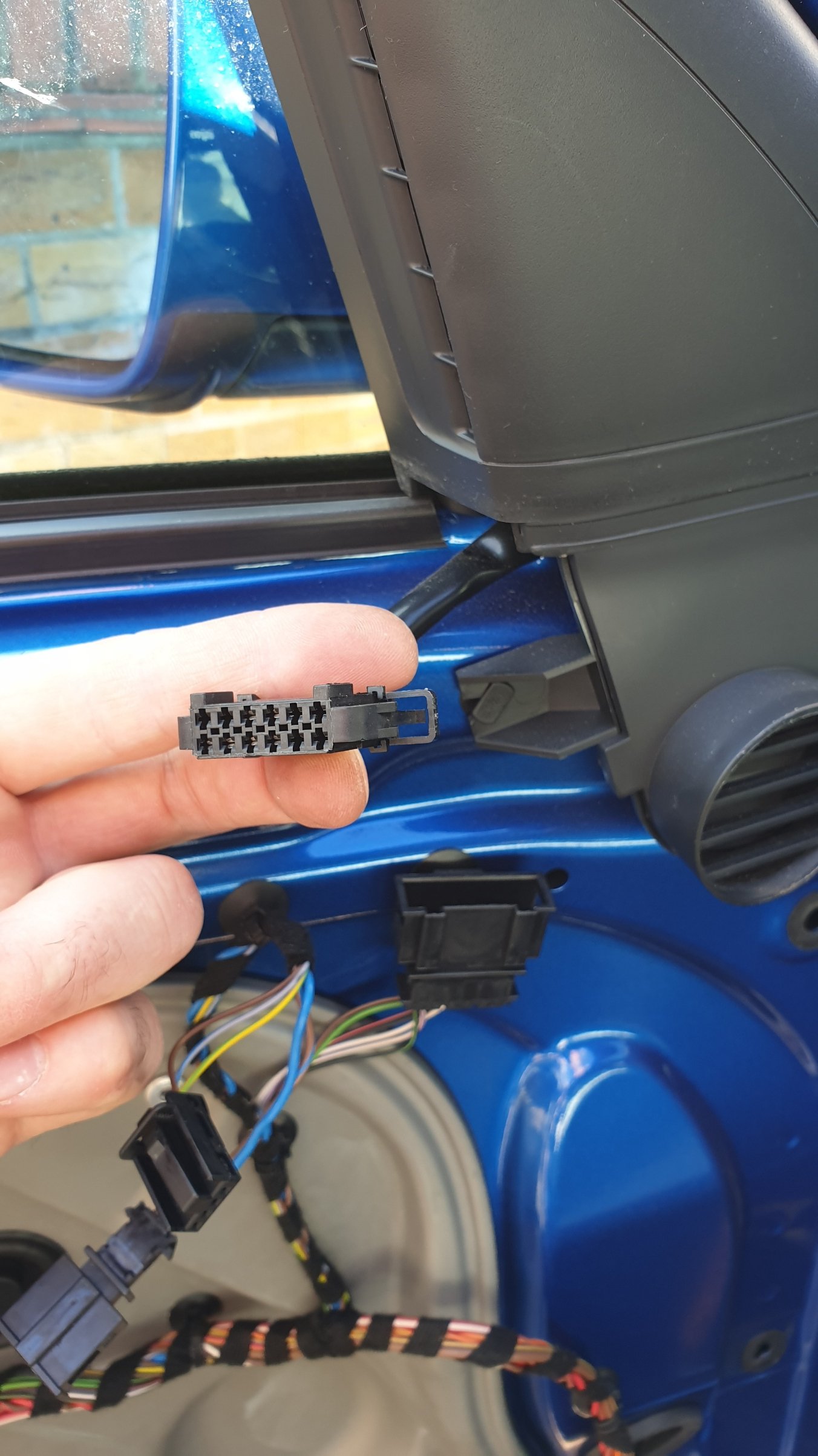

Hi @langers2k
I can confirm the pFL plug part number is 3B0972726.  Socket is 3B0972736.
The part number of the facelift plug is 1K0972926 I think. Following the pattern, there might be a socket ending 36?
I would need wires with terminals for both types. Wouldn't know where to buy these.
Here's a photo...

Well, this made a funny turn haha!
as far as the facelift connector, the part nº is 1K0972928A. What I did is soldering the cables (In your case, facelift mirror to “old” connector). The result is that now I have two mirrors (facelift) without connectors and will order a couple so I can sell them properly.
Anyway, I had some gap to draw a quick diagram/pin numbering so you could use it. I hope it does make any sense to you. If it doesnt, it definitely helps removing the glass and seeing where al the cables start from inside the mirror. Good luck!
@uniteunion indeed it did.  I think I will cut and solder the wires like you did afterall.  Far less hassle, especially now you've done such a nice diagram, thank you!
There are two motor +ve and only one -ve.  Is there one +ve for up/down and one +ve for side-to-side movement?  Please can you confirm the pairing between pre-facelift and facelift, e.g. red to green and white to purple.

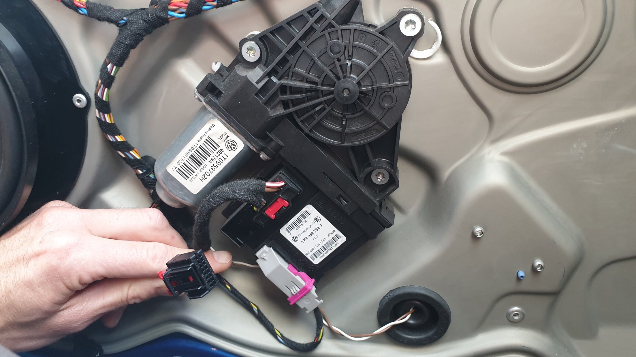

can't you just plug the mirror plug into the door controller?
Urm.... because that would just be far too sensible and easy! 🤦‍♂️
You mean here, like this?
Boy am I glad you turned up here today @Eddie-NL, I was just about to cut the wires!! 😆
yes, just plug it in
the worst case is that you might need to move some pins round, not sure if there is a difference between the pin location on the mirror between pre facelift and facelift
I can confirm that this no difference between pFL and FL mirror wiring and it really was a case of plug and play directly into the door modules.  I can't believe I didn't spot this!  Thanks for all your help chaps.

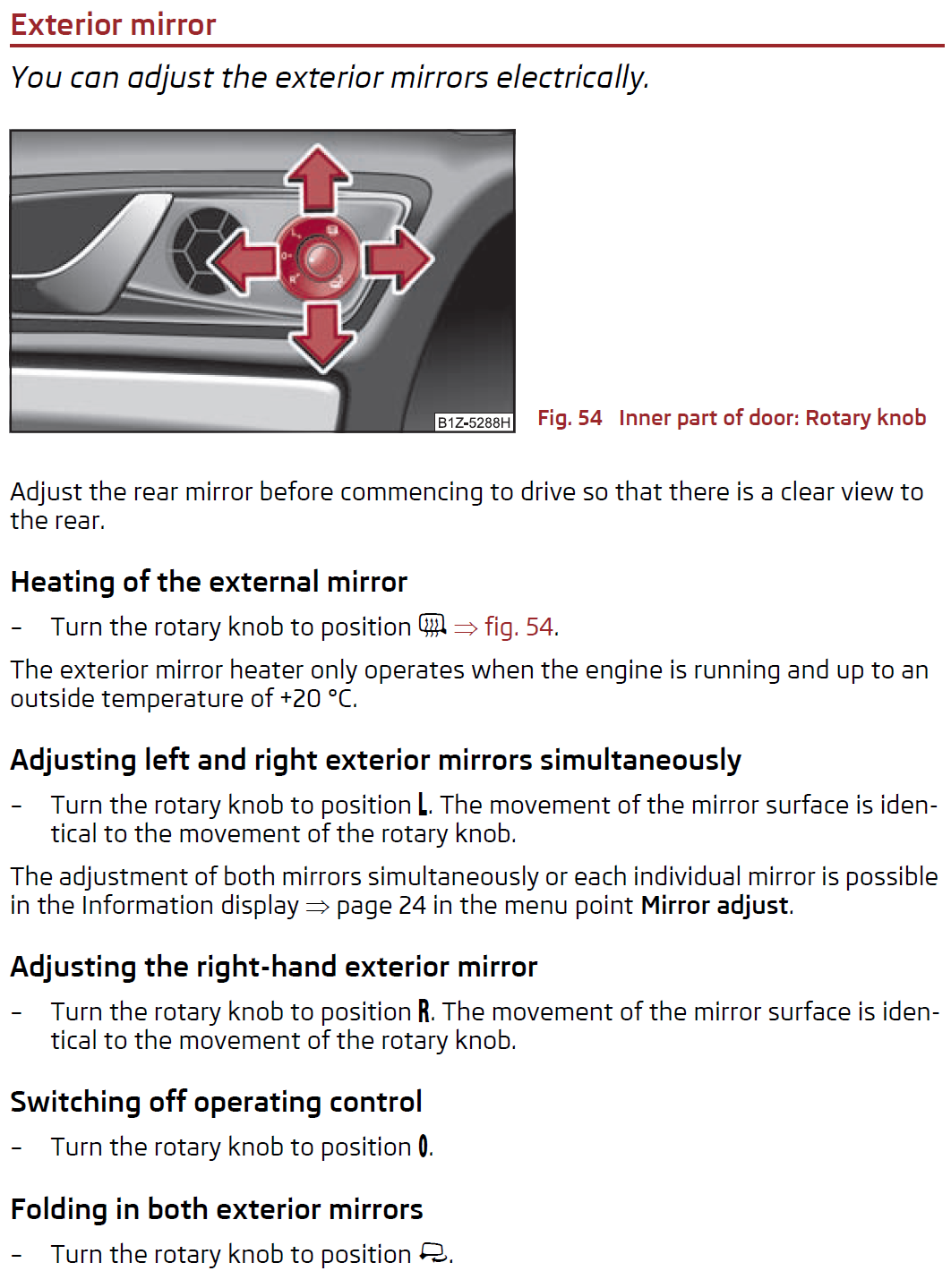

There's one small nuance, which I thin existed with my previous mirrors, and that is that when I adjust the driver mirror, the passenger mirror adjusts too, but I can adjust the passenger mirror on its own.  Is this normal behaviour, or is there a fault somewhere?  I would suspect the switch is faulty.
Normal on a FL, it can be changed via the maxidot and possibly via VCDS.
My car is a pre-facelift, with FL Maxidot instrument cluster.  These car settings aren't available in the menu on the Maxidot, I think because it has CECM, not BCM.  I guess it's enabled on the car though and I would need VCDS to disable it.
I definitely have an option for that in maxidot. I think it's under "mirror adjustment" and the options are "individual" or "both".
