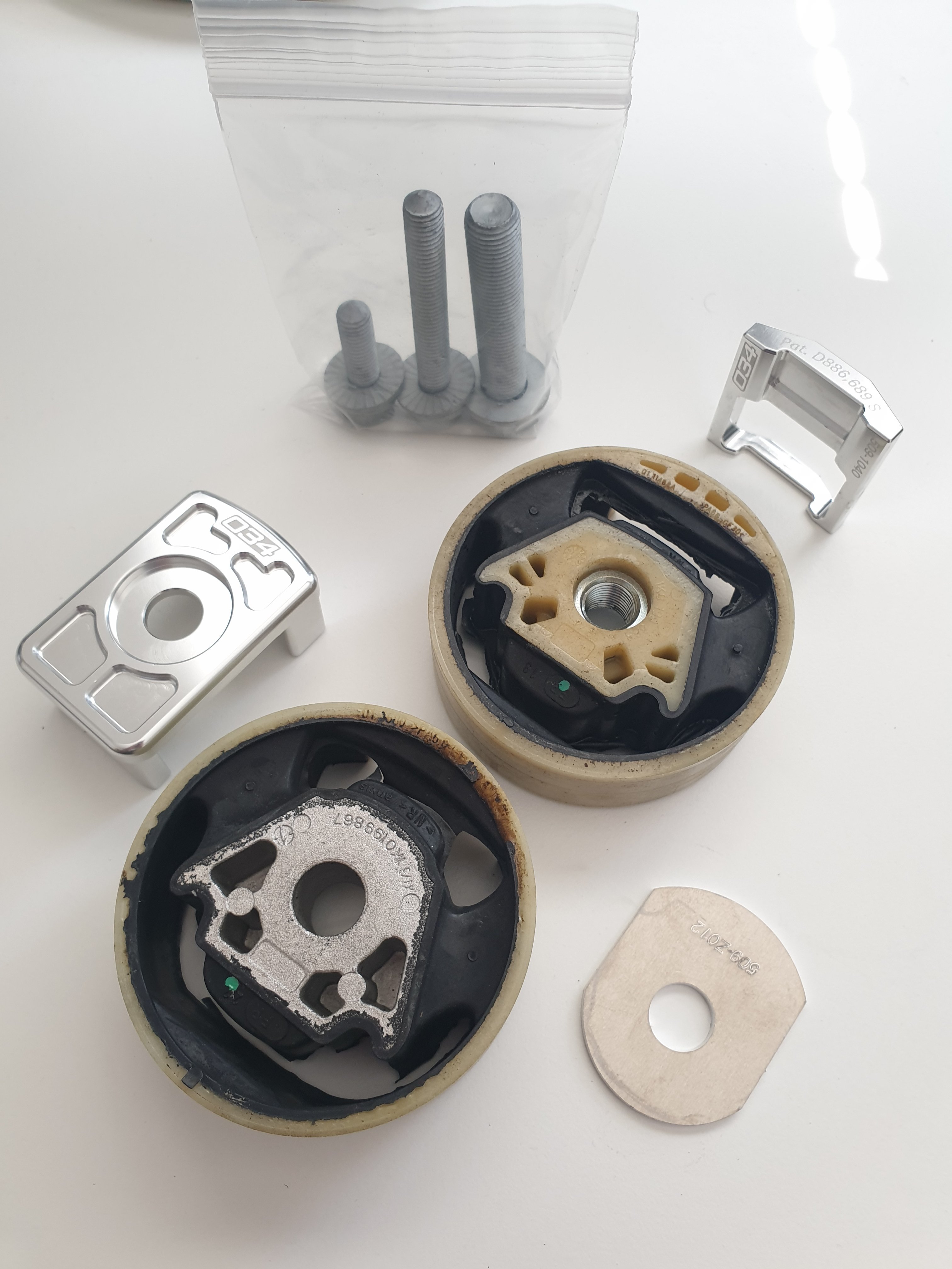

  9. Aftermarket mount or insert makes gear shifts feel super precise and positive and eliminates engine rock and reduces front end lift. They feel great, but all tend to transmit more noise and vibration to the cabin, if you can live with that. I've just removed my Powerflex insert as it was too harsh. Attempted to fit a new stock mount yesterday, and failed after snapping one of the bolts on the subframe...

  11. Is your car a diesel? Im planning to replace the original mount on mine this weekend, and fit the 034 insert 🤞 Does anyone know the torque settings for all three dogbone/pendulum/torque arm mount bolts?
  12. Is it really that nasty to do? I'm planning to do mine this weekend, in-situ without removing the subframe. Once the old one is removed, it doesn't look so tight that the new one can't be drifted back in, based on the videos I've seen. @NCR1, this is my original pendulum mount/torque arm/dogbone mount bush and you can see the cracking in the rubber (after 200k miles)

  14. I'm not sure how it would bend, being clamped to the mount and with no space to move with the dogbone and within the subframe, but we'll see. We can write up comparative notes then, because I ordered the 034 one last Friday.
  15. I have a new stock mount to replace my knackered one. I've just replaced all suspension and control arms bushes and had wheel alignment done, therefore I don't want to be removing the subframe if possible. Can the mount be replaced in-situ? I'm thinking I can use the old mount with a cut in it to drift in the new upper part from below, as it doesn't look to take much persuasion to press in from the videos I've watched. Then drift the lower part in afterwards. Thanks.
