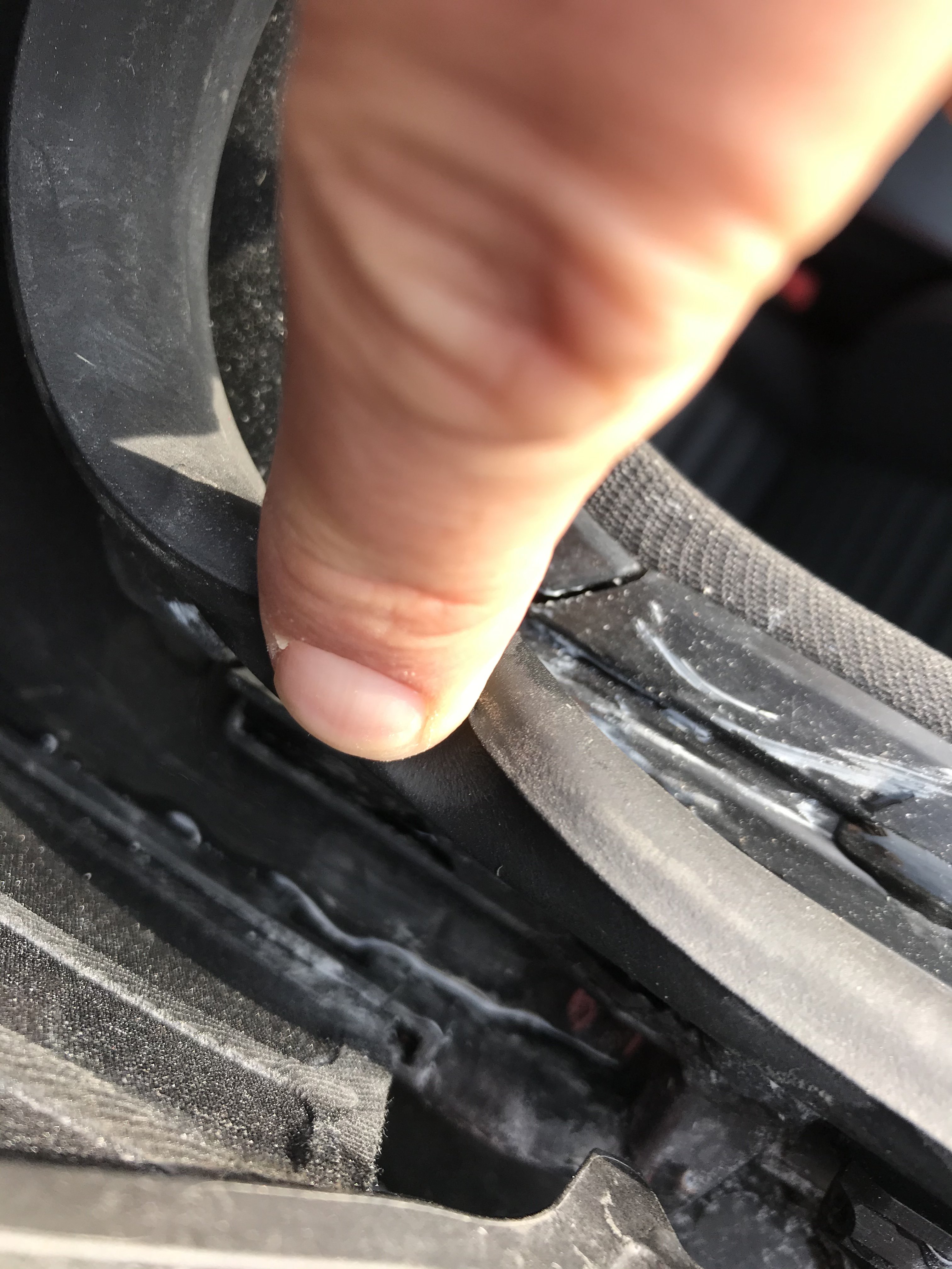

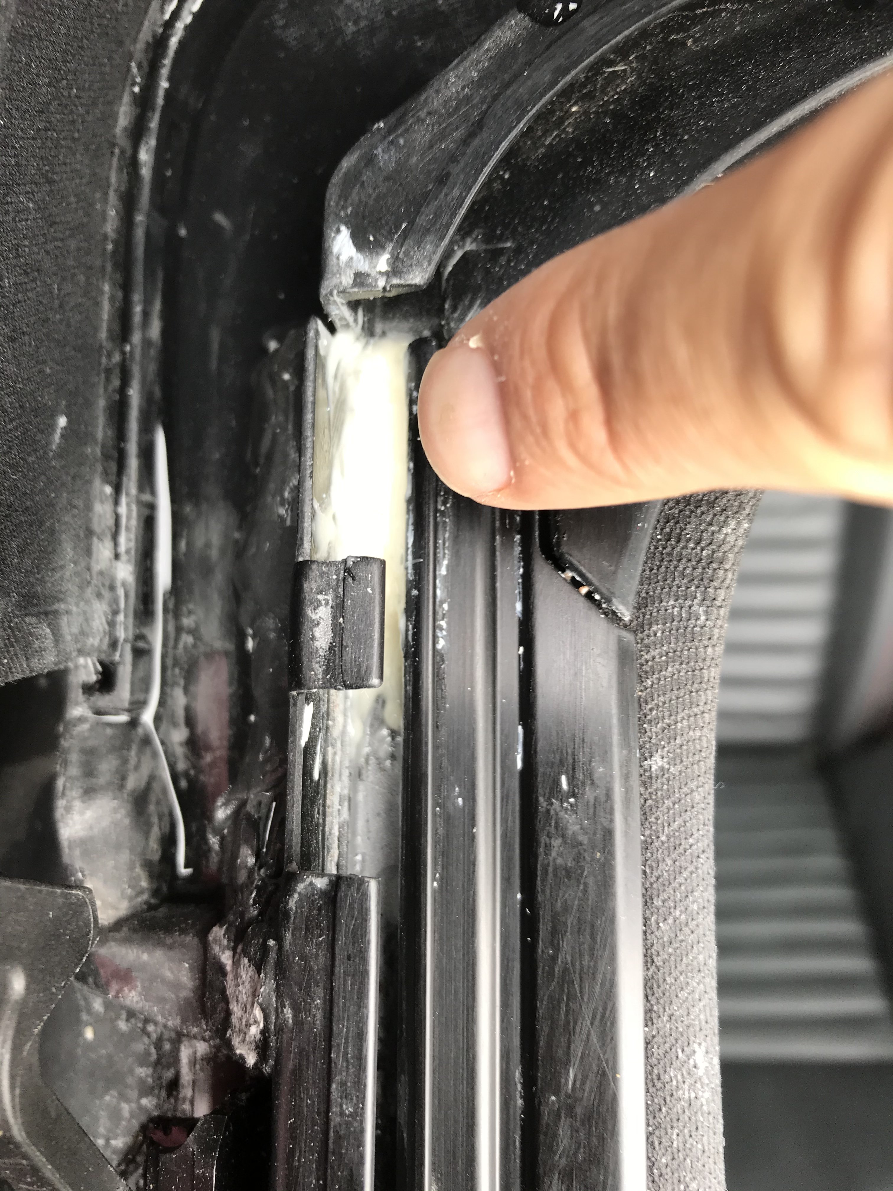

Hello Blaikie,
That looks very much the same as the eventual fix that was applied to mine.
I've gone into my experience and findings regarding the panoramic roof in some depth here.
In a nutshell the roof was removed for a possible TPI for a failed seal and at the same time my mechanic water tested it and found a leak between the roof frame and housing, which was Rebonded. Funnily enough I now have a healthy smear of black sealant in the same location. So there is obviously a common issue!
Touch wood since then Iv'e been leak free since, but I'm watching it like a hawk.

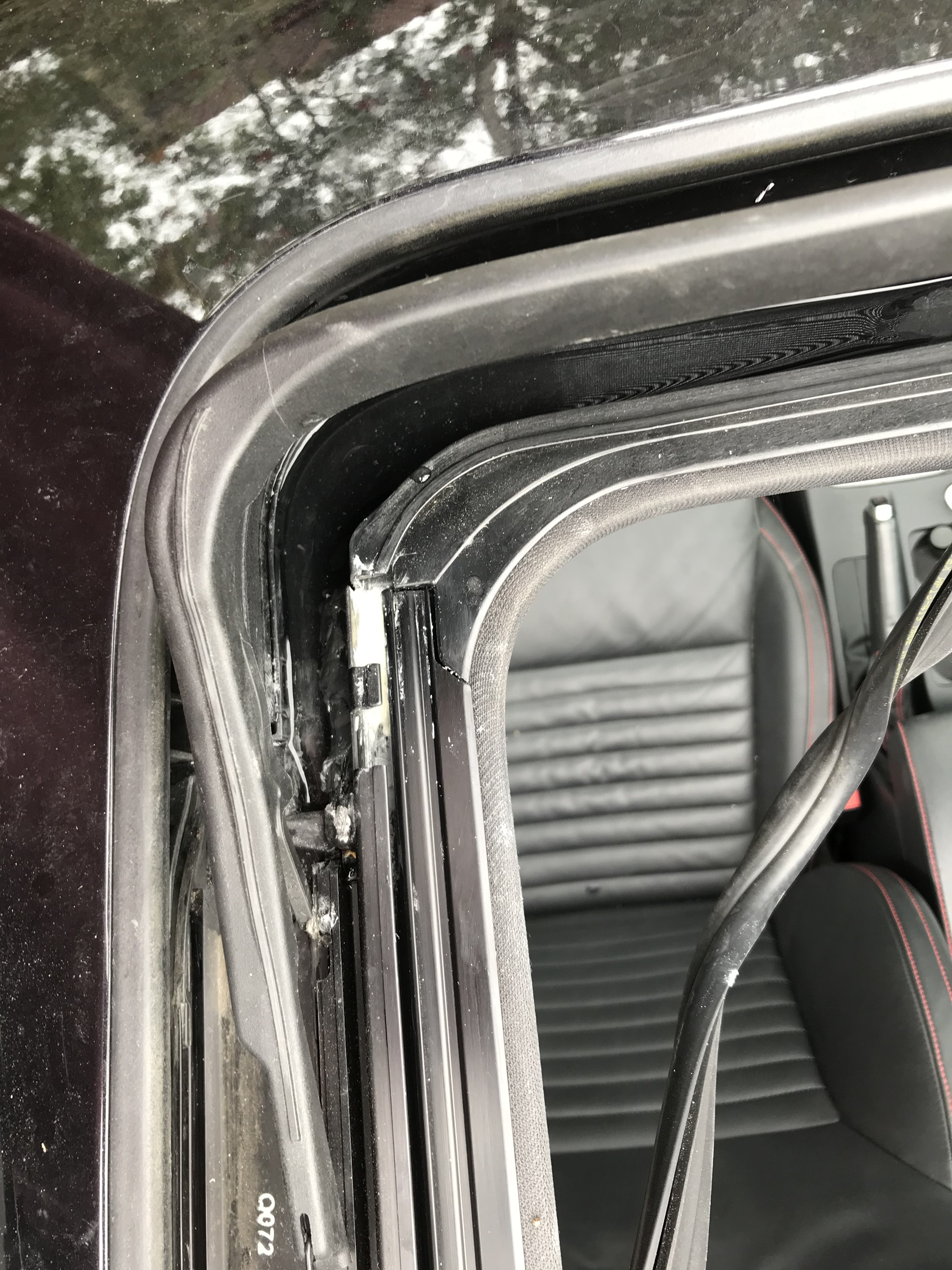

On 10/09/2020 at 11:33, Blaikie said:
I have the same issue You have. On inspection with a body panel friend of mine we located the leak to these two points. After using plastic resin to seal it seams to have stopped. I hope this helps. Time to sell the Škoda.
Sorry to resurrect an old post, but did this work and continue to work as a fix? I've got enough water in the rear nearside to sustain a decent group of Koi carp, hell my lad is taking waders and a fishing rod into the car each time.

Hi Rob,
In my case the leak was coming from the roof itself, rather than a maintainable issue like a blocked drain.
I took mine to a local independent VW specialist up here in the north east who described that there was a leak where the metal frame of the roof met the plastic housing it sits in.
They ended up removing the roof from the car, separating them and rebonded them all together using sealant.
I was without the car for a couple of days and paid about £500 for it (this was about two and a half years ago) - nearly all of which was labour cost.
Touch wood I've had no problem since although I service the roof every year now. I clear the nozzles at the front bulkhead, flush the drain tube with soapy warm water and then cleaning out the roof the rails/mechanism with compressed air and a soft brush before, lubricating them with WD40 PTFE lubricant. I then dress the rubber seals with gummipflege (also recommend this on the door seals as they will stick in the freezing cold otherwise).
Hope you get sorted as it's a real faff of a thing to sort, especially this time of year. I went vacced about two litres of water out of the passenger footwell and was lucky that it was the height of summer so managed to get it aired out and dried fairly easily. This time of year I would suggest wet vac, then get it into a garage and run a dehumidifier inside the car.
Best of luck.

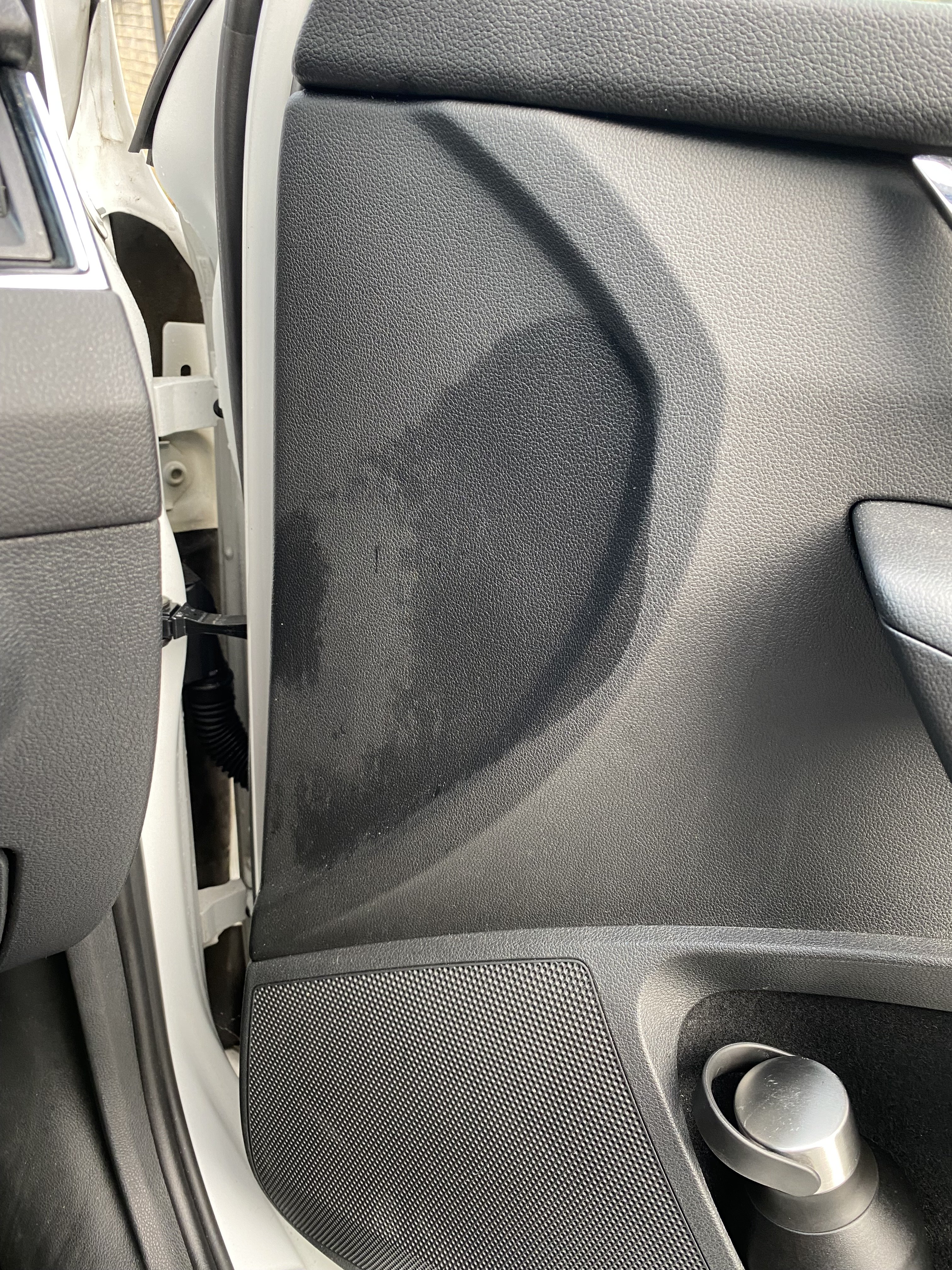

Hello everyone,
In these days I found out the same issue described from @BigJakkon my Octavia.
Initially I noticed water coming out at the bottom from the driver's side, near the bonnet opening lever. The next day a lot of water came out from the passenger side, still in the lower part under the bonnet. I disassembled the A pillars and checked the drainage pipes, cleaned them and the connections are ok. Seeing water still coming out of the top where BigJakk was showing I went to inspect the upper basins more closely and found that the outer basin where there are the two drainage holes is working properly and the water is not stagnating, while in the housing where the concertina fabric noise canceller is fitted it remains completely full of water.
The questions are twofold:
1. how does water get into that space?
2. there are no holes for it to drain and I think it seeps into the plastic slots and gets into the interior of the passenger compartment.
I will now try to see if I see any cracks in the plastic parts.
If anyone can help me I thank them.

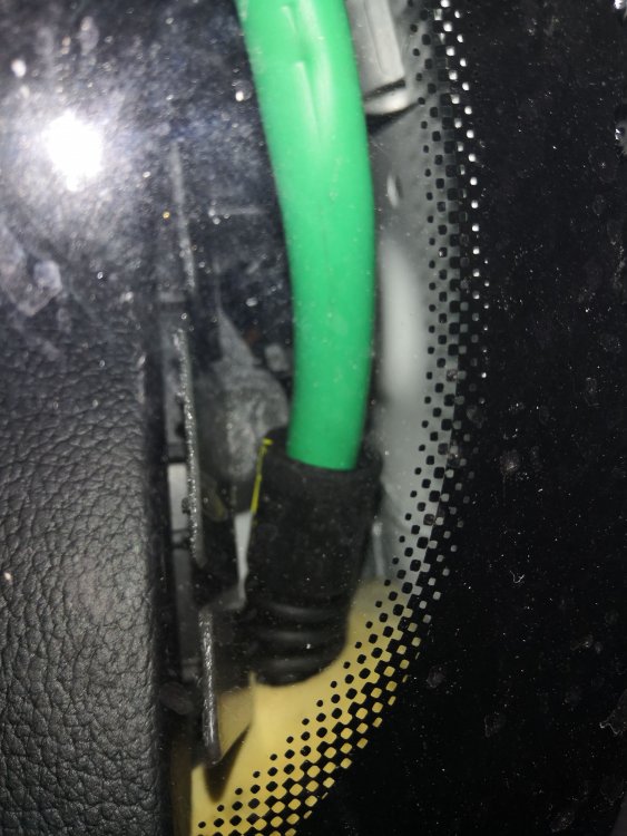

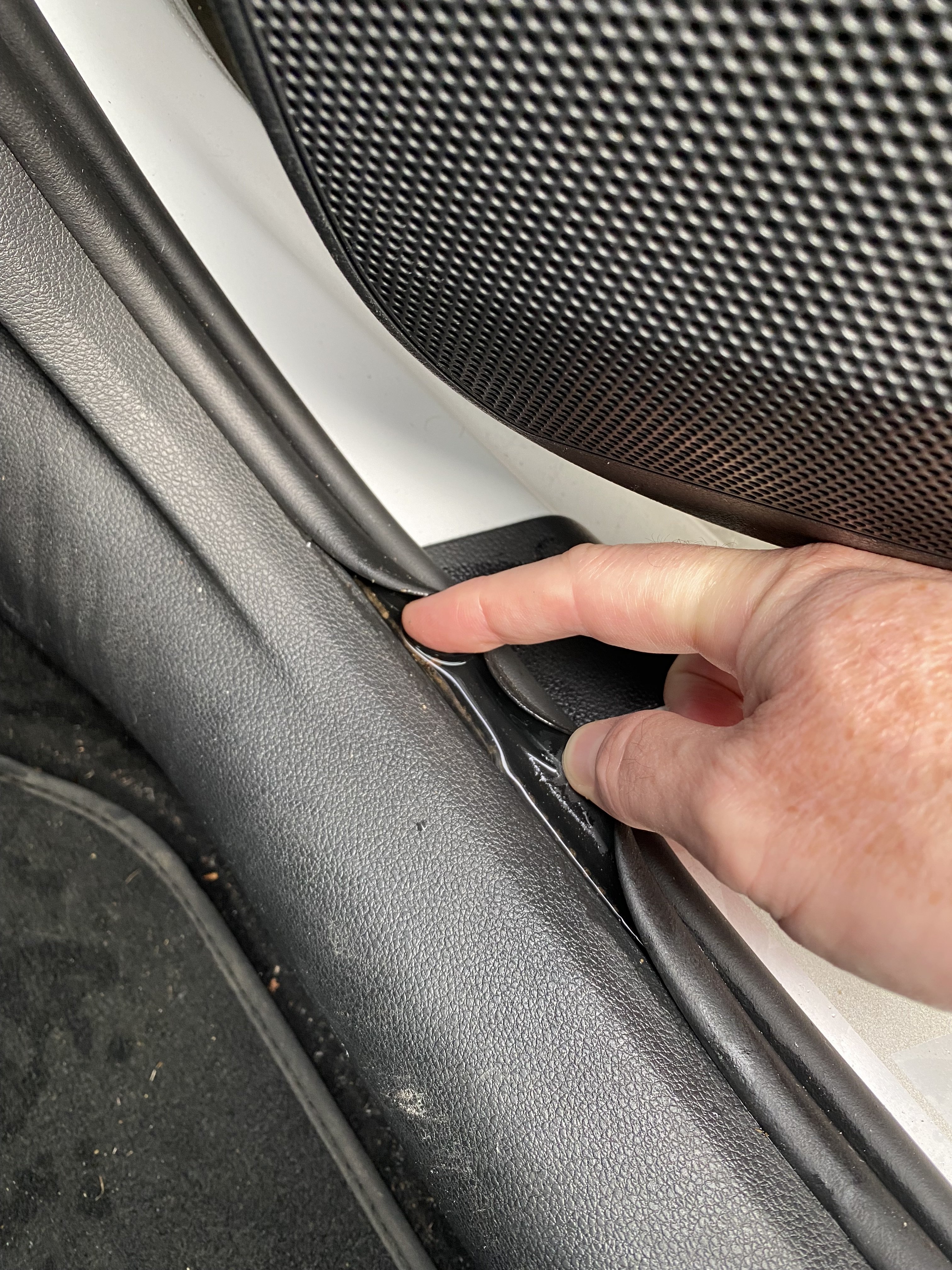

I’ve given up hope on my car ever being fully dry. The driver side footwell has sprung a leak now too. Feel free to take a look at the photos I’ve attached. Drainage channel on the drivers side of the pano roof seems fine so it may be a seal on the drivers door that’s iffy. I hope the VW group never build submarines.
  • Haha 1

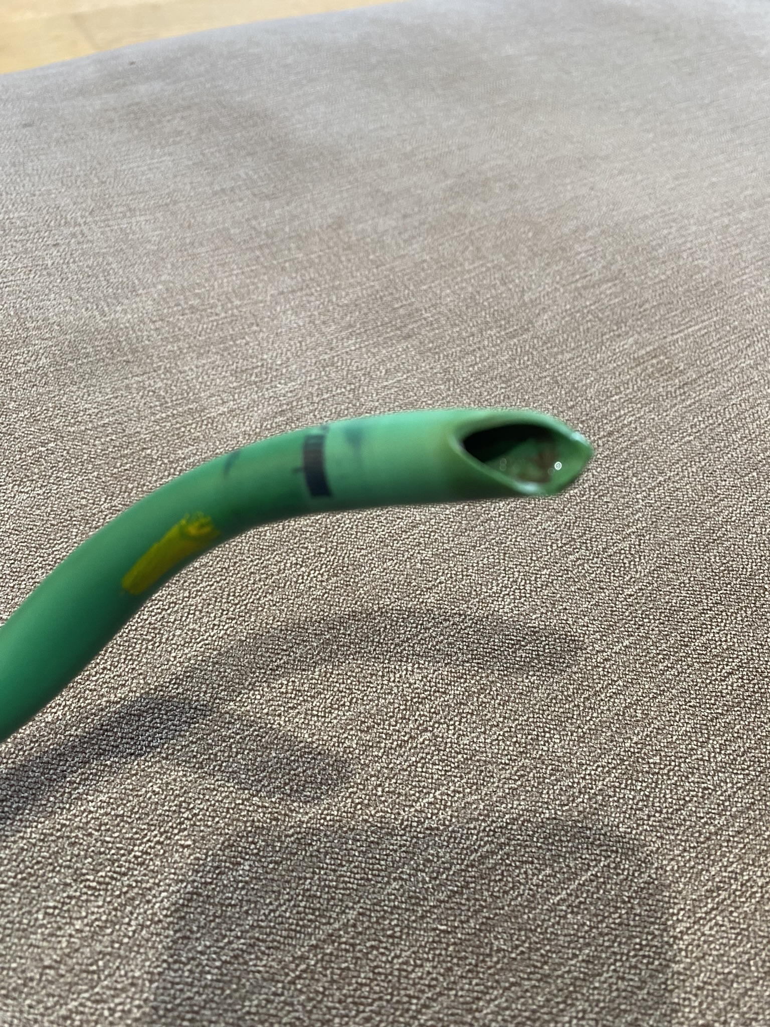

A quick update. Andy from Surrey Sunroofs came out again to take a look. The pano roof is all fine and draining as it should. The issue is these green tubes. Over time they become brittle and shrink. The end of the tube is cut on an angle, seemingly to fit more easily into the joint at the dashboard end. This shrinkage has caused the top of the angled cut to become exposed and no longer be covered by the joint, and therefore was leaking. A quick demonstration proved this. Only the drivers side was leaking but both sides were repaired (pipes cut, new pipe attached), so hopefully all is now fixed.
Incidentally, even though these pipes were still draining freely, and having run a brake cable through them (please don’t judge!) and compressed air, I’ve just cleaned this section to take the picture and it was still absolutely full of debris.
I hope this may be of help to anyone who is despairing of their soggy Skoda.
