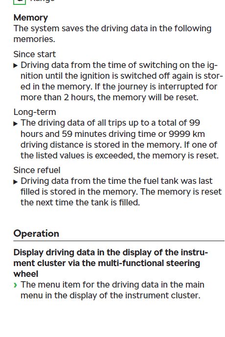

I'm more than a little puzzled here. My Karoq now seems to reset the fuel consumption details each time the car ignition is switched off. I realise that 'consumption since start' will reset on each trip, but surely 'long term' and 'since refuel should not, based on the parameters stated in the manual?
I'm purposely keeping my hands as far away from the '00/set' button as possible, in case it's me causing the problem with my banana fingers, but I'm convinced it's not that?
Any suggestions ....?

Apologies for my explanation - pressing the wheel does change it to 'since refuel', 'long term' or 'since start'. However, basically all these selections produce identical readings. It seems that after every restart, the memory on all 3 settings of fuel consumption is wiped. I don't know if I've inadvertantly altered something within the settings of the car, but I don't where or how that has happened?I hope that makes more sense now

I have the same issue on my sportline (2019) - I've got over 5000 miles on it, but long term fuel consumption is showing only between 1-2.000miles (and not the full mileage car has done)
Weird, I've tried everything to sort mine without success
Mine seems to reset every 1000 miles!
