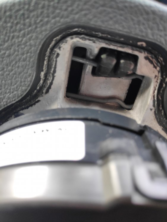

Remove airbag,
Can someone help me with this,
I am trying to remove the airbag.
And this safety is not in the workshop manual or in any video that I saw.
  • 1 year later...
remove negative pole from battery you turn the steering wheel up ,push down the metal clipper until its loose . There is one also in the opposite side you turn the opposite side looking up and repeat. Now airbag is free remove slowly because there are cables that you have to unplug. First touch the car metal frame to remove static from your hands
