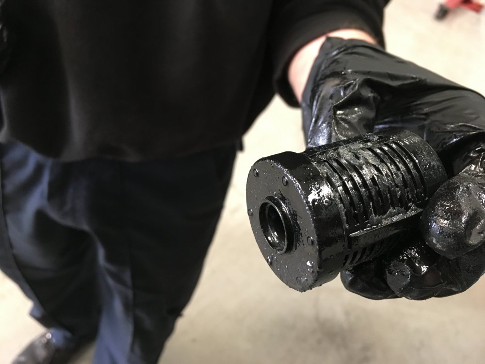

Make sure the Haldex filter has been changed. Skoda don’t even show it on their parts diagram. Attached is a photo of my Scouts filter at 8 years old and approx 35k miles.  The Haldex was serviced by main dealer at 4 years.
