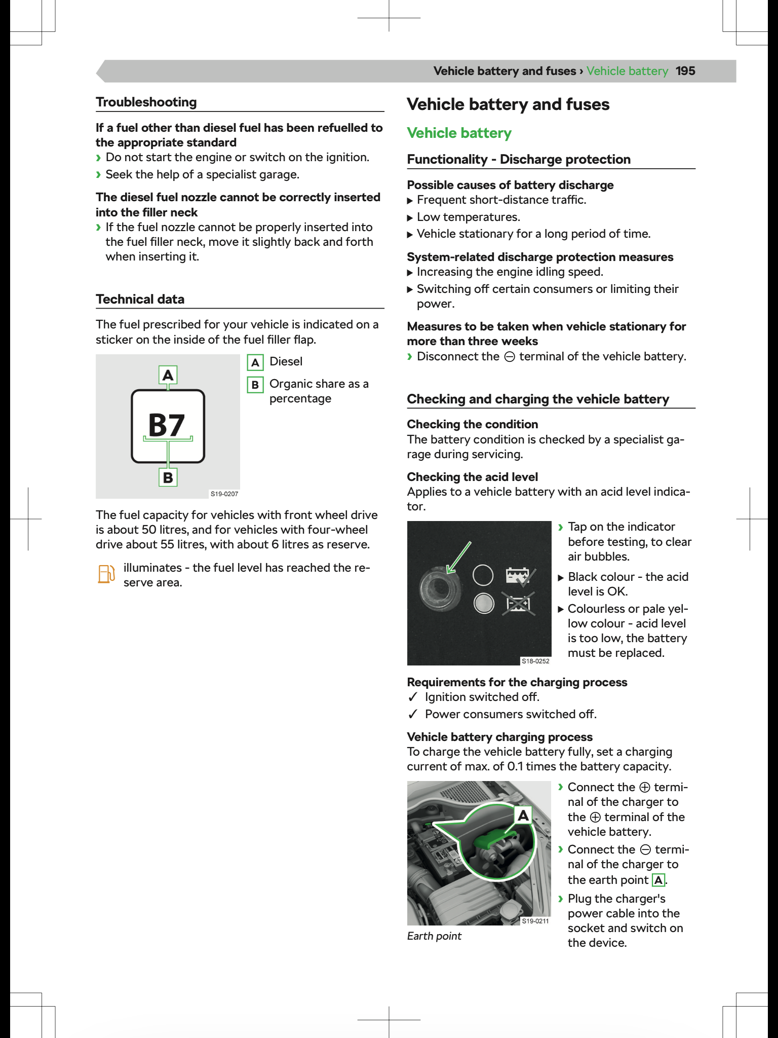

According to the November 2019 owner's manual, the fuel capacity for vehicles with front wheel drive is about 50 litres, and for vehicles with four-wheel drive about 55 litres, with about 6 litres as reserve.

55l according to the manual in my car.👍
Actually. It's the other way round sorry. 2wd is 50l and the 4wd is 55l.
