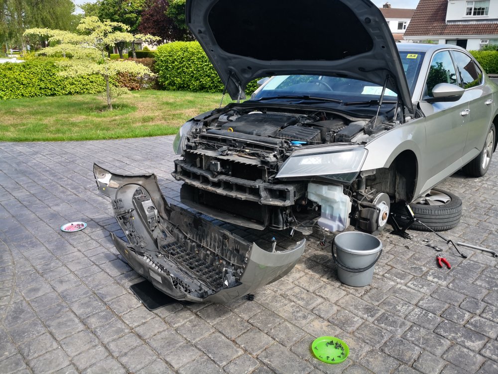

Had to replace my front left (closest to number plate) sensor when it got taken out by a stone chip. Got the part from ebay Germany as it was already painted same colour as car. Part number was 5Q0919275B. Now the fun part... No way to get at sensor without taking the wheels off, inner liners, disconnect the hose to the washer bottle and then removing the bumper. Attached below is the doc I followed with a pic of the car fully disassembled. 2 hours start to finish. Note car is on jacks only, would have preferred my axle stands but due to lockdown it wasnt possible. Two person job to remove the bumper(when pulling it off car as it does flex a bit) Hope this helps. Alan

Thank you for your advice, the download and picture, what a massive job just to change a parking sensor, oh well it will have to be done at some point, Many Thanks David
