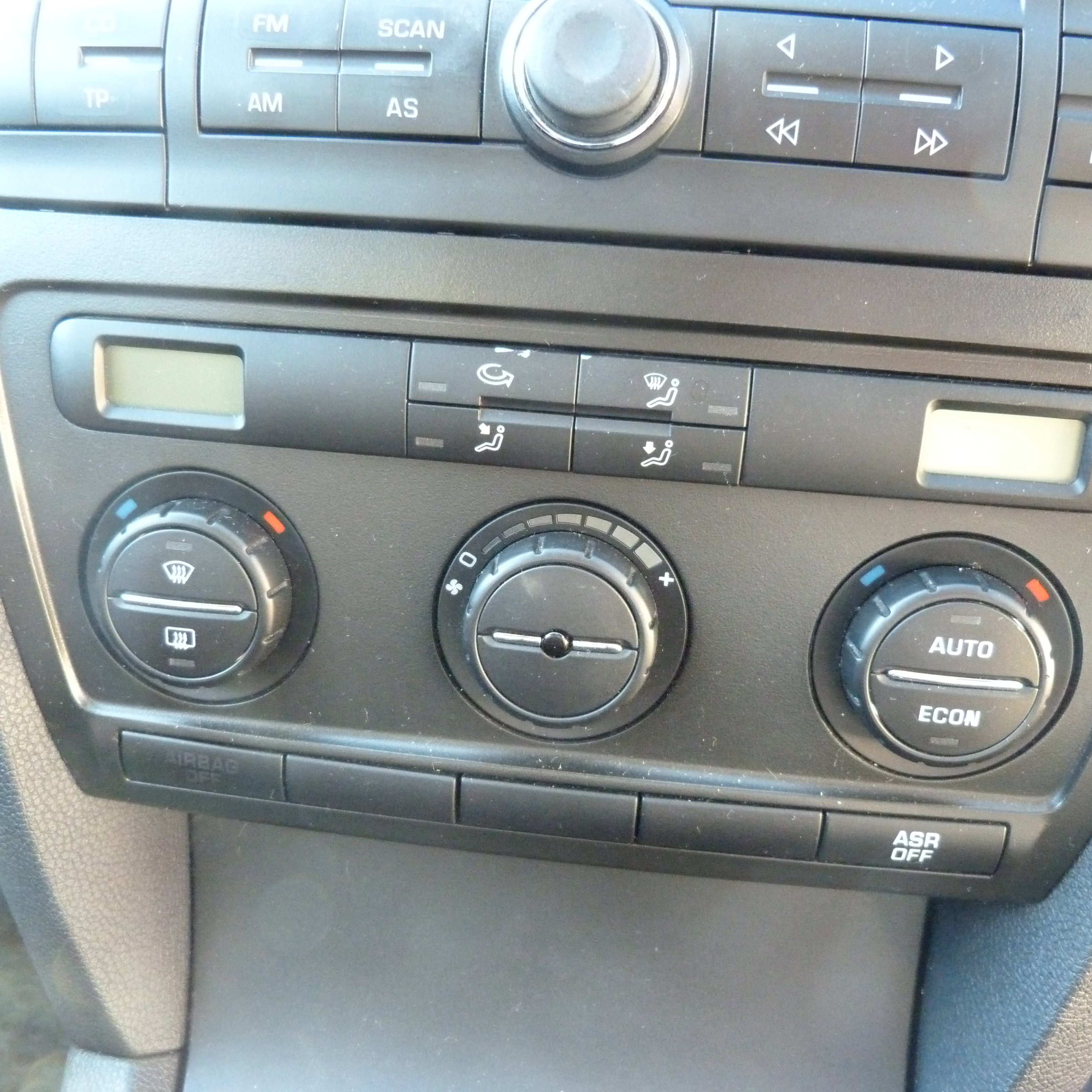

However we need to know which variant you have and best way is to post a photo of your control panel.
There are many people on this forum who can help.
Many thanks for the information.I have added a photo of the controls.I will take it out for a drive tomorrow and check everything when at normal operating temp and report back my findings.I should be able to borrow a diagnostic tool.

Great lots of info to check. Been out for a long drive . Two things checked . No errors come up when checked with OBD fault code reader. When ECO button is pressed the noise disappears
Does the air get very cold when you dial both temperature knobs to LO when on AUTO?
The fact that the noise disappears when when you press ECO (which switches off the air con) suggests the noises are due to low gas in the system. See suggestions by MicMac above.
Right
cooling system calibrated and blowers a lot more powerful but on auto and LO temp showing ,it’s not cold so looks like a trip to garage for a leak check / refill .
