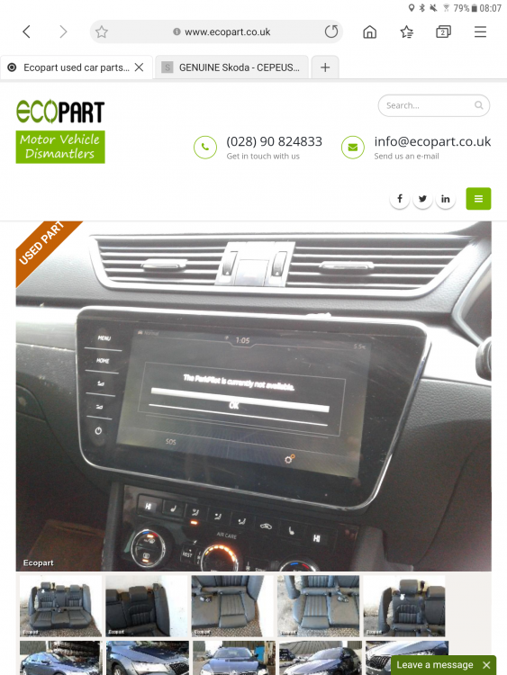

Hi, my local breaker has the new  fully touch for sale i was hope to replace my old touch screen and button version,  does anyone know if it fits in the same as the old or is it a hard fix to get working etc..,
If it's anything like the Octavia all mib2 screens are swappable, apart from the 9.2inch which requires mib2.5. if coming from mib1 then you will need a new glovebox unit with component protection removed and recoding to match the car.
Best speak to pab567, you'll need your head unit (glove box) reprogrammed if it's MIB2
@tonytiger76 pls post a picture of your current screen and model number and SW version of your glove box unit (you can check it in menu SETTINGS then SYSTEM INFORMATION).
